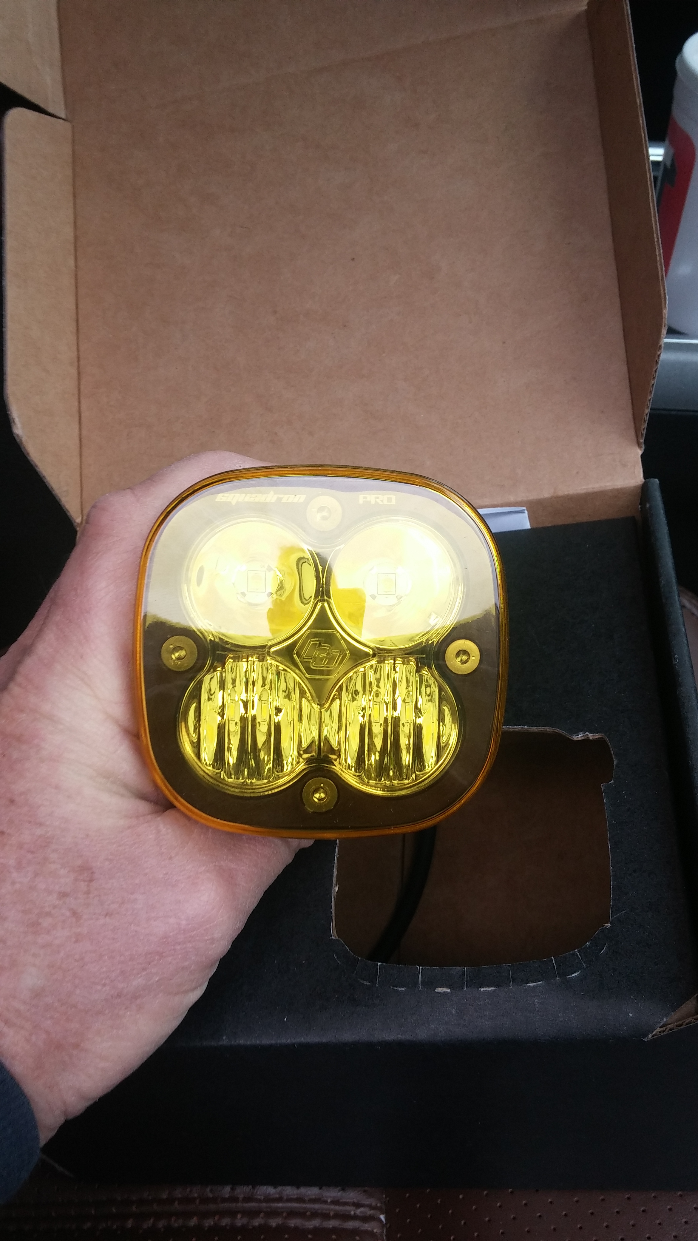

I ordered some Baja Designs Squadron Pro combo Amber lamps for my 2015 F350. They will replace the factory fogs.

Mine showed up yesterday.
