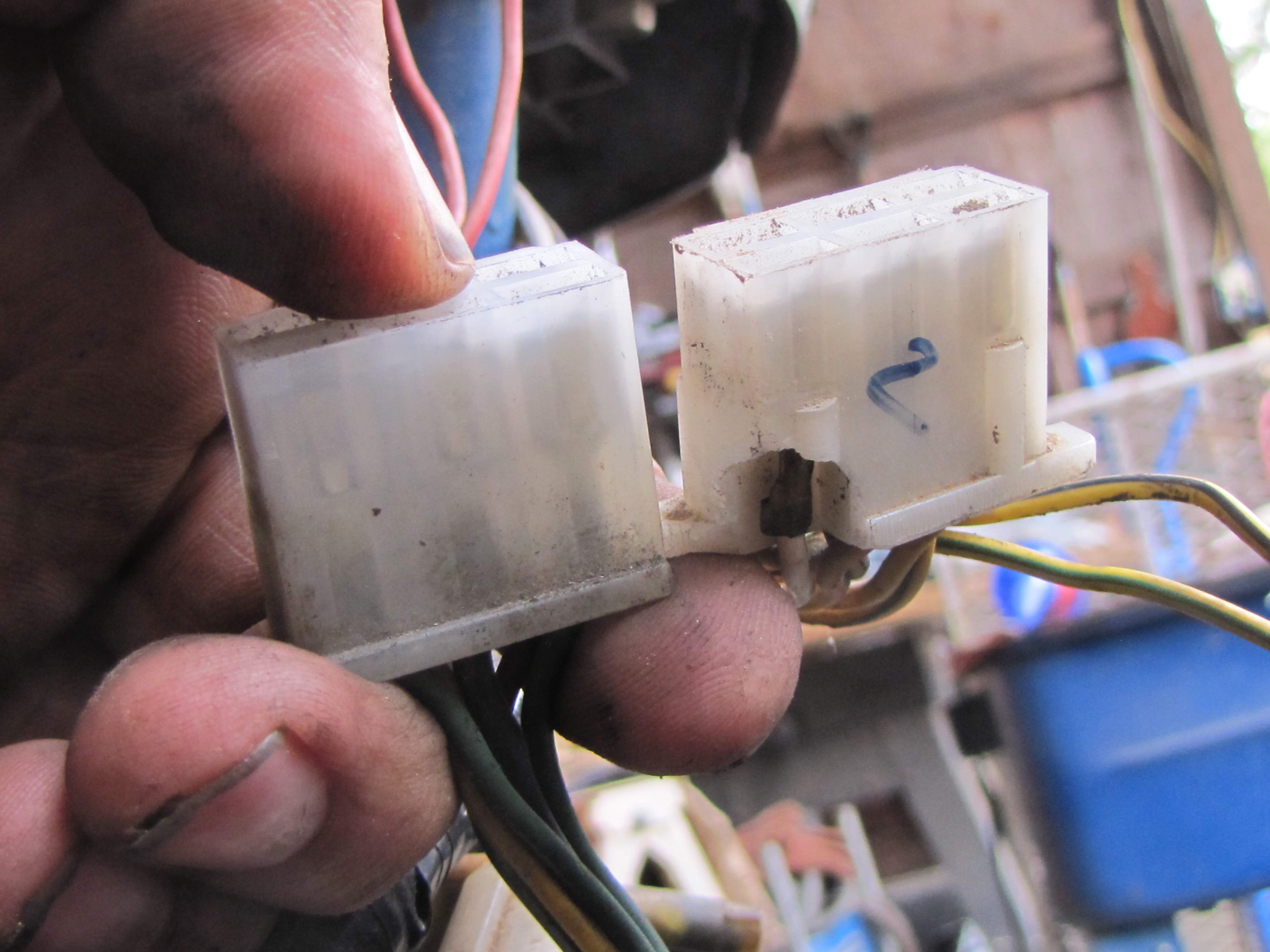

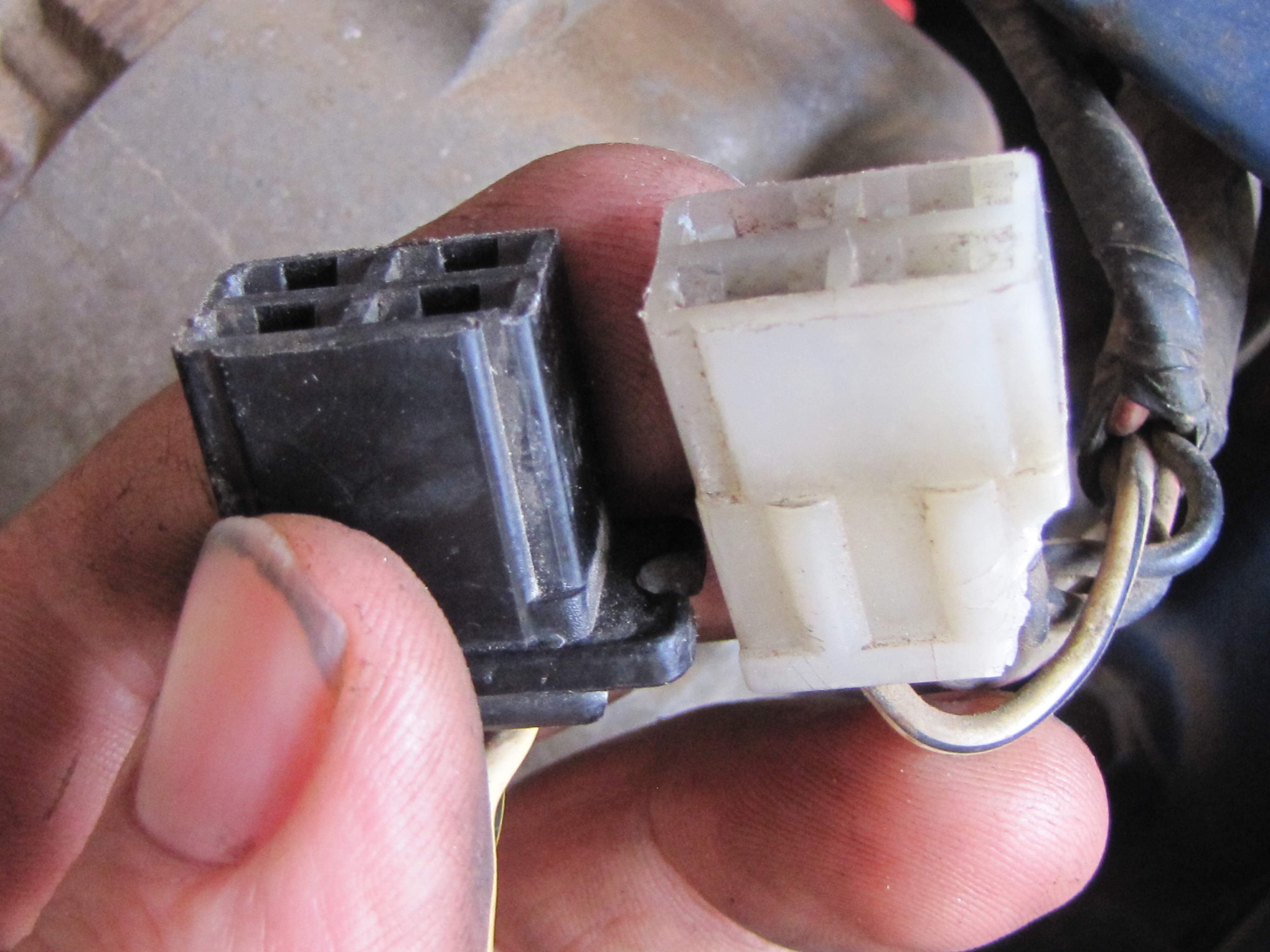

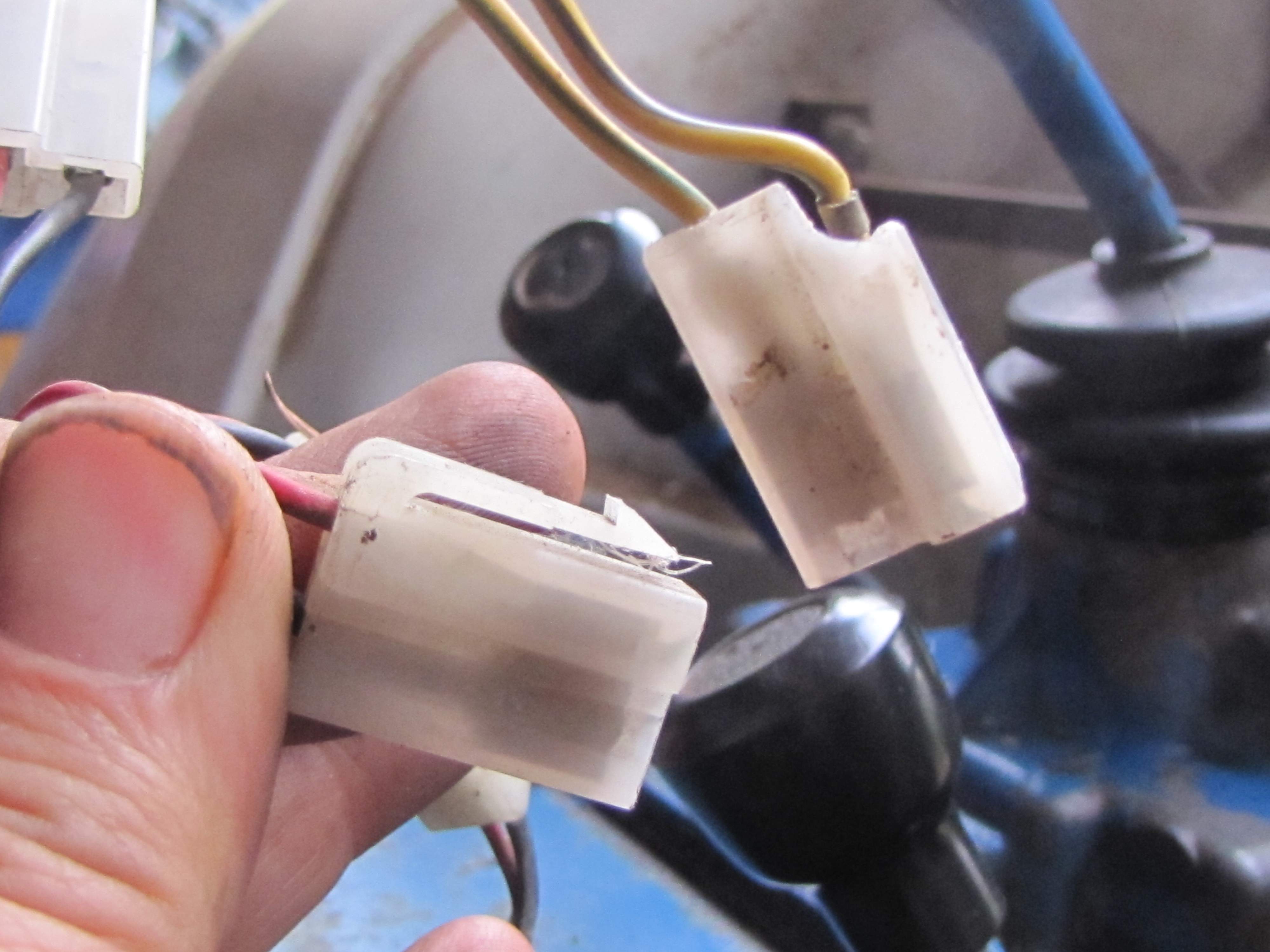

Boy is this timely...after having to remove most of my connectors to get things out of the way while changing a clutch on my MT372 several of them came apart...the plastic just crumbled in my hands on some.
I was in a junkyard yesterday and found a Ford Courier. I pulled much of the wiring harness and find that the alternator plug fits perfectly. Not only that many of the other connectors have direct correlations to ones on the tractor. Some have additional tab releases that are absent on the tractor but these are only a minor inconvenience.
As a side note I also stumbled on a similar vintage (1983) Mazda pickup, this is the same truck as the ford so here is another source.
I've included some comparison pics
Now back to the garage to chase the electrical gremlins I introduced by moving all those wires around...
