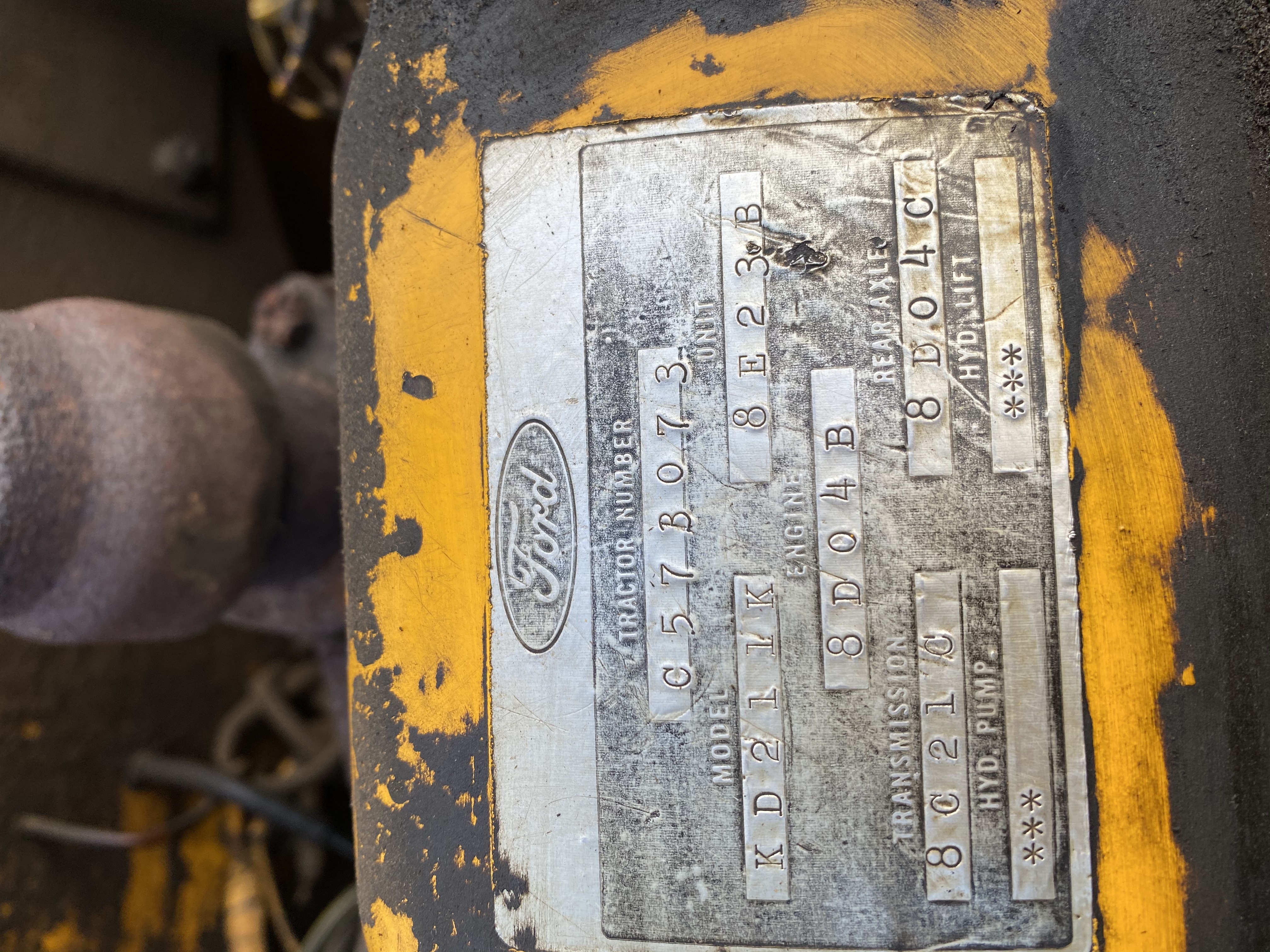

I just acquired this Warner Swasey forklift and would like help to identify the running gear. It uses quite a bit of engine oil yet starts and runs well if a bit smokey in a blue gray sort of way. Thanks for any assistance... I am posting pics, I hope.

KD211K
KD2 = 420 Industrial 1976-78. 183ci 4.2x4.4 bore 45hp
1 = Diesel engine
1 = no PTO
K = 6x4 manual reversing transmission
8E23B assembly date May 8, 1978 second shift
