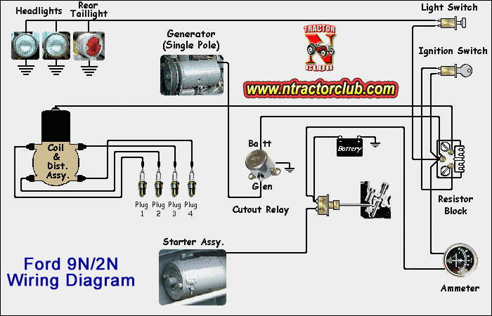

I have replaced every wire, including larger battery, ground and starter cables, on the tractor except the one running from the generator to the cutout. The connector on the cutout is severely rusted and the screw will not come out. The wire seems to be in good condition so I am leaving it for now.
I replaced all of the wires based on the following wiring diagram which seemed to match SoundGuys description.
The only wire I don't see on my tractor is the ground connection at the Cutout Relay.
Through my attempts at testing the voltage I have come under the impression that maybe the starter switch is to blame. I checked voltage to it (possibly incorrectly) and checked continuity to both switch posts when pressing the start button, which this test failed since I didn't hear a noise or get resistance.
I am unsure if I am using the multimeter correctly to test everything, so if you could tell me where to place the probes while on the 20VDC setting I can begin testing.

the ground connection shown at the cutout is simply it's body grounded to the frame.
check from chassis to hot side of start switch using meter. with starter disconnected, check the other side with button pushed.
use a headlamp as a test load in place of the starter. ie.. press start switch see if lamp lights up.
Reading -6.35V on hot side (where negative side of battery connects to starter switch) and chassis.
Reading -6.35V with probes on chassis and starter side of switch (cold side?) with starter disconnected and pushing start button.
I don't have headlamps on my tractor and can't think of anything readily available that runs off 6V for me to test with.
