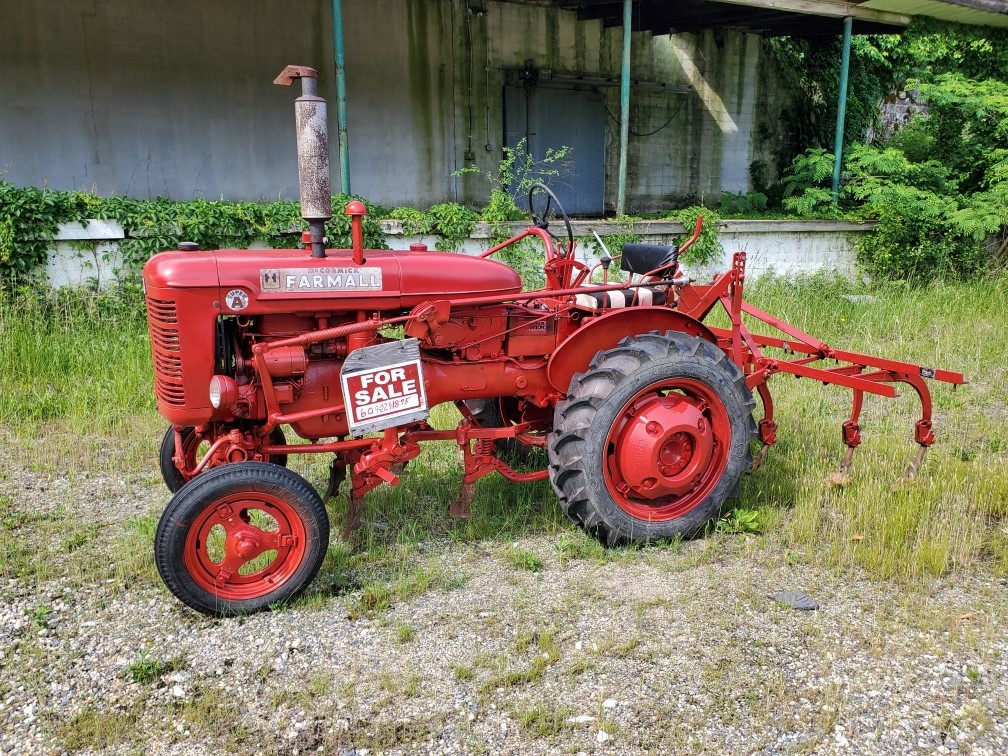

I'm looking at possibly buying a Super A I found in NJ. It's a different animal than a modern CUT so my 3-pt. implements would not be usable. Mostly as a toy for me to tinker with but also for dedicated garden work on about 1/4 acre. My wife wants to start a flower business and she might find the A more appealing than the L3800.

   / Ford 8N or similar older types #96
