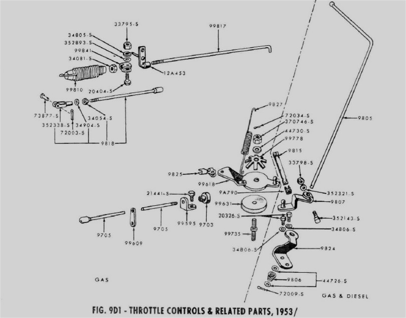

Hello Ford851 again,
I was happily putting my tractor (Ford 851) back together and put in the gas control lever, tightened it down, and it would not turn. So removed the battery box and found a plate of some sort. Seeing that it was dirty and crusty I tried to undo the bolt in the center holding it down to the tractor. The whole stud came out to the top of the tractor housing. Oh, great.
This thing looked like it needed some serious attention. So I thought I would take the bolt out of the center, but couldn't. I oiled where it rotated around the stud. Put grease on upper and lower side of the pad and cleaned the flat part on top of the tractor housing. Then put grease on the housing and put the assembly back together.
It turns, so I hooked the linkage back up.
But I have the sinking feeling something is wrong and I've missed it. It still looks bad because I can't get the castle nut to release from the center stud (the whole stud turns) and that spider looking on top is still not looking terrible.
What is the purpose of this gizmo and how is it suppose to function?
Thanks in advance,
Ford851:confused2:

The "spider" tensions the throttle to maintain the position of the throttle lever.
Sounds like the threads may be stripped in the housing or on the stud. Might be something JB Weld could fix?

Just wrote a long post and hit "Reply to Thread" and it disappeared" So I'll try again. Great hearing from you Dollar Bell. Its been a long time. Say thanks for the blow up diagram. You have a ll the slick tools. Noticed that my setup doesn't have the spring. I noticed the hole and thought there should be a spring. Where does the other end of the spring attach?
Is there a set tension that should be applied or is it free style? Do people grease the pad that is under the rotating bracket? When I turned the castle nut the nut, spider spring, and pad came up with the stud. The threads are OK. Took a little time to clean pad and metal surfaces. I greased them and put them back. Thinking I should pull the mechanism out free up castle nut. Any great ideas on how to do this? Heat. Double nut. etc.etc. Got tractor wired and dressed them. Charging battery tonight. Looking to fire up shortly. What to get the ol girl running again before I make any more changes.

Where does the other end of the spring attach? Connect to a tab on the bottom of the battery box.
Is there a set tension that should be applied or is it free style? Tight enough to hold the position of the throttle lever but loose enough that you can change engine speed easily.
Do people grease the pad that is under the rotating bracket? It's a friction disk and should not be lubricated.
Any great ideas on how to do this? Heat. One of my favorites.
By the way, who is jB Weld? Two part epoxy available at any automotive parts supplier.

if the casting is stripped out.. I'd drill and tap for a larger fastener.. like a pipe plug.. then redrill and tap oem.. lotsa work.. but good results..

Thanks guys for the insight. I'll remove bracket and clean pad. Assemble again. Try to fid a spring. I have the part # from Dollar Bill's diagram.

With the info I now have I pulled the battery box again. Unscrewed the tensioner and the stud came out with the castle nut. Placed the assembly i the vise and with my trusty cut off tool ground the castle nut until I could use a cold chisel on it. The chisel and penetrating oil did the job. Got the stud slightly, but not enough to hurt. Purchased a new nut and proceeded to clean up the tractor housing for installation. Now in the process of cleaning and painting the assembly.
