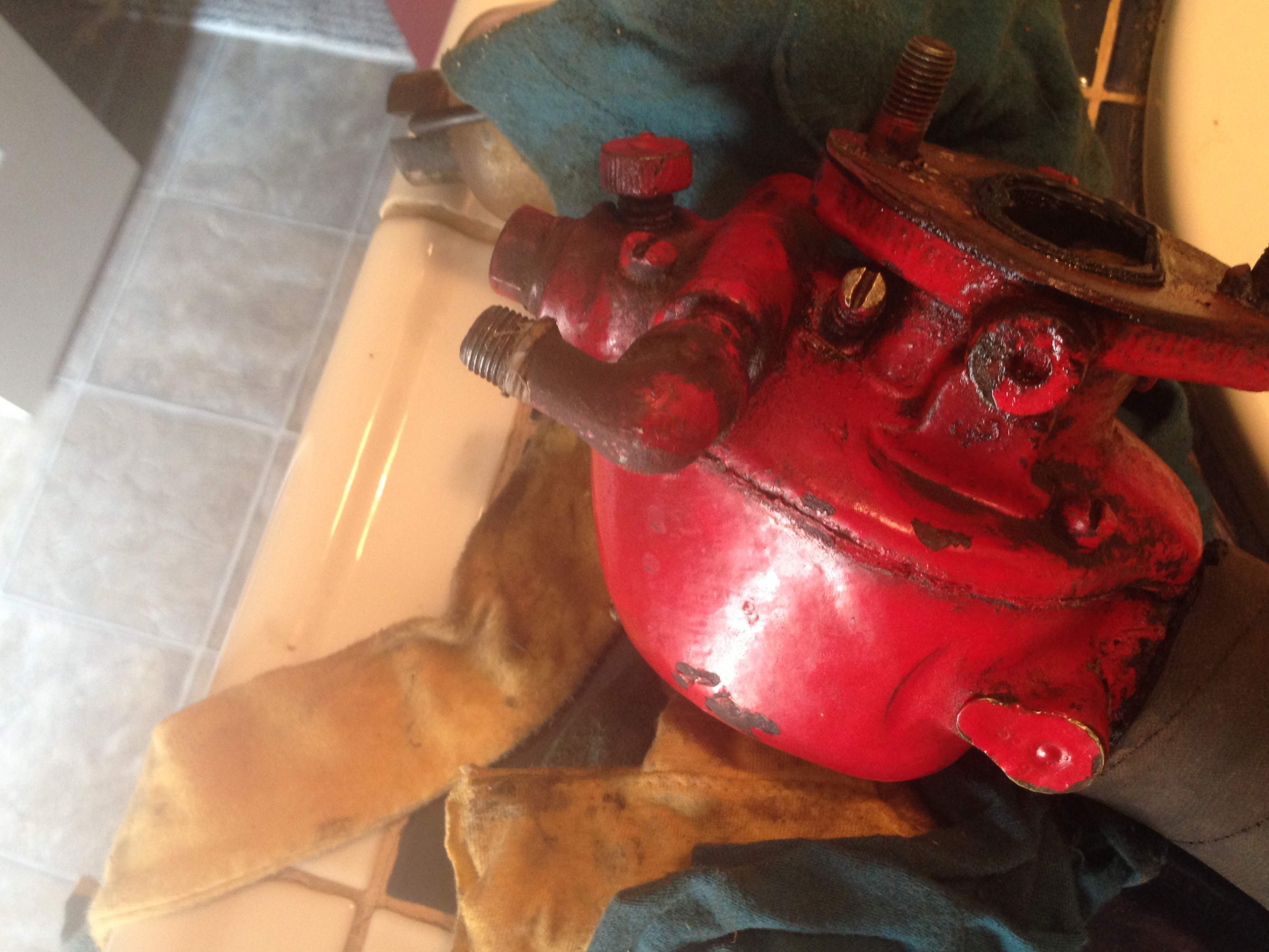

I have a 850 Ford tractor that has ran great for two years, now its running bad. Here are symptoms and what I have done so far.
1. Runs pretty good for an hour or so then runs bad.
2. If I pull choke out half way, it will run better.
I have replaced sparkplugs, wires, points. and timed it. Adjusted carb. Seems that after the tractor warms up I am having trouble getting fuel into the carb. Any suggestions?

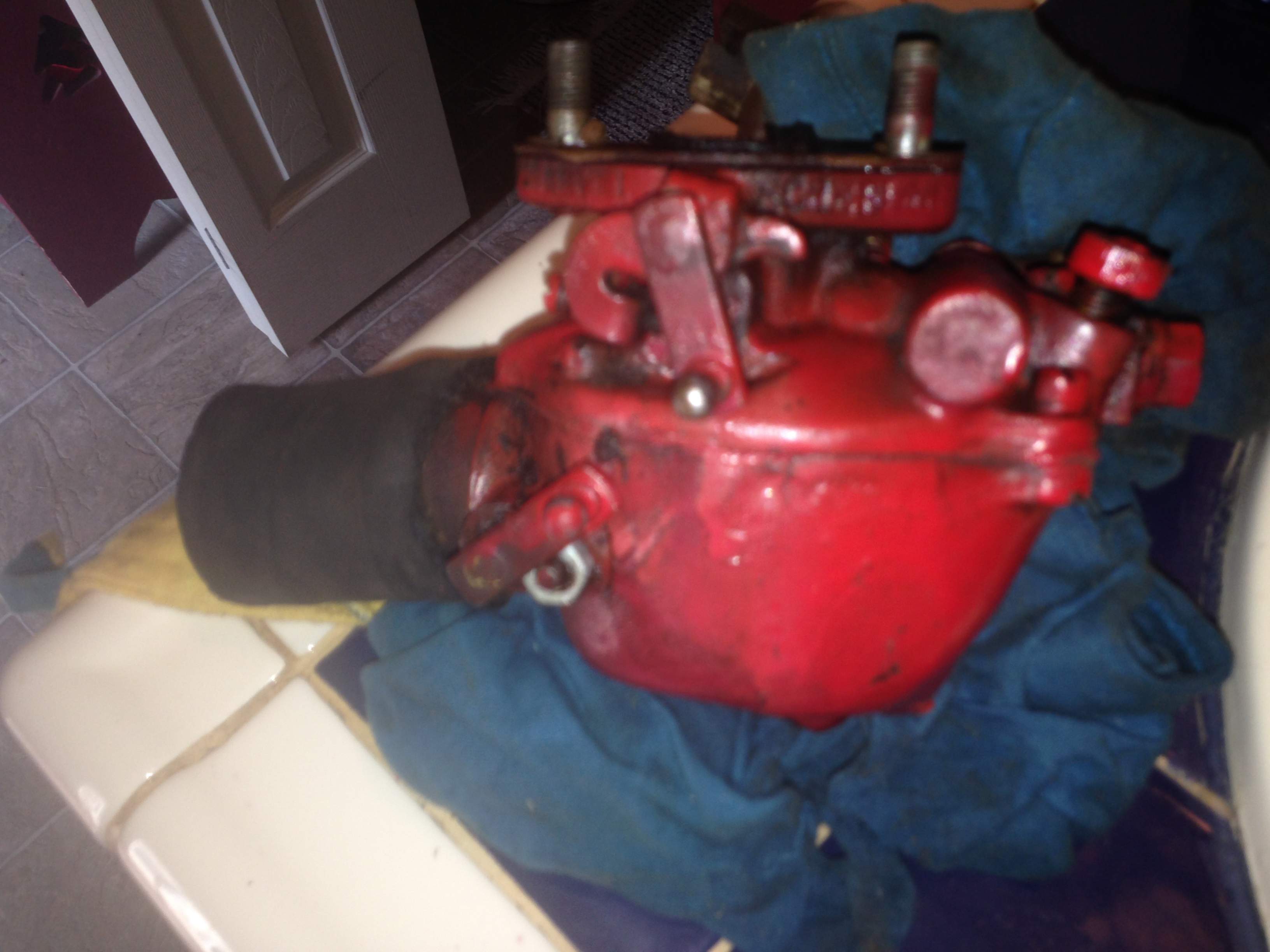

photo 1.jpgThanks for the replies. I will do the spark test. I did take of the carb to see what model number it was. Figured I would go through it anyway. Its pretty dirty and I haven't touched it for 3 years. It's a Marvel Schebler. Tsx 593
I replaced the plugs this year along with points and timing. Last year plug wires. Anyway....I can get a rebuilt tsx769 pretty reasonable...would that one work??

I just overhauled the carb and actually am replacing a cracked manifold that I noticed when taking off the carb tomorrow. As far as avacuum problem...is that a gas cap issues or what would cause or how could I diagnose that??
