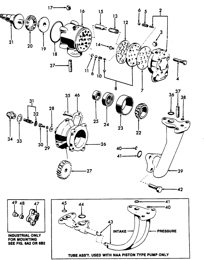

Hello,
I have a ford 850 that I love but for the last year has experienced intermittent hyd' leaks. And by leaks, I mean it pours! I took the lift assembly apart last year, completly cleaning out the resevoir, replaced any o-rings I could. I also rebuilt the hyd-pump. The problem started when I borrowed a friends tiller for some landscaping work, the tractor started leaking bad around the pump mount flange. I did all the above work but it continued to leak. This spring I used the tiller again and noticed it didn't leak at all. Fast foward to last week when I was using the tractor to dig some post holes; it started leaking like a mother... again. The leak is at the same mounting flange as before. Everything is tight and I don't see any cracks.
My guess is my some debrie has plugged something (I cleaned alot of gunk out of the reservoir) and the system is creating too much pressure?
Thanks for any feedback.

I don't think you are familiar with the engine mounted hyd pump on an 850.. or at least it doesn't sound like it...there is no 3rd line.. there is a hyd manifold that runs from it tot he trans center feedthru lines.. at the hyd section there is a relief valve...
the pump is cam driven, and if it is gushing oil at the gear drive, I'd think a shaft seal was gone.
I included a exploded diagram of the pump

If you are leaking at the manifold flange, then I'd think it is the flat face orings... if you have repalced them with regular orings.. they may not seal.. get the real flat faced ones.
as for rebuilding without the nuday tools.. I've heard of it done.. but not done it myself.

glweder,
You said that you rebuilt the pump. Based on Soundguy's diagram, did you remove the head #2? If you did, did you remove the valve plate #8? The old gaskets #7 & #12 need to be removed completely so the new ones can seal. Also, check this area for a gasket leak if you didn't remove the head. Be very careful taking the head off. There are several small balls and springs that can fall out.
While you have the head off and apart, remove all of the old paint so that you can check it for cracks. There is a threaded plug #3 in the side of the head. Check around it, I have seen cracks around them sometimes. The head is where the pressure is built, so if you have a pressure leak, it will be near this end.
If the shaft seal #24 is bad, it usually lets the pump suck engine oil into the pump, or it sucks air, causing you to lose hydraulic pressure, since it is on the suction side of the pump.
Since you have a pressure leak, I would concentrate on the head. Make sure that the manifold flange is square to the pump flange. Make sure that you have the right o-rings for the manifold flange. They are flat faced, or square shoulder as has been said before. Make sure that the bolts and threaded holes are not stripped. Also, check the aluminum manifold to make sure it isn't cracked.
Ask questions and post pics as you go. There is enough combined talent on this forum to help you fix this. ;)
Mike

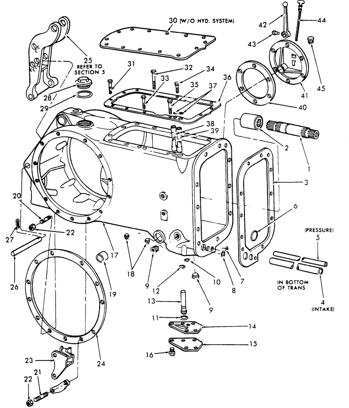

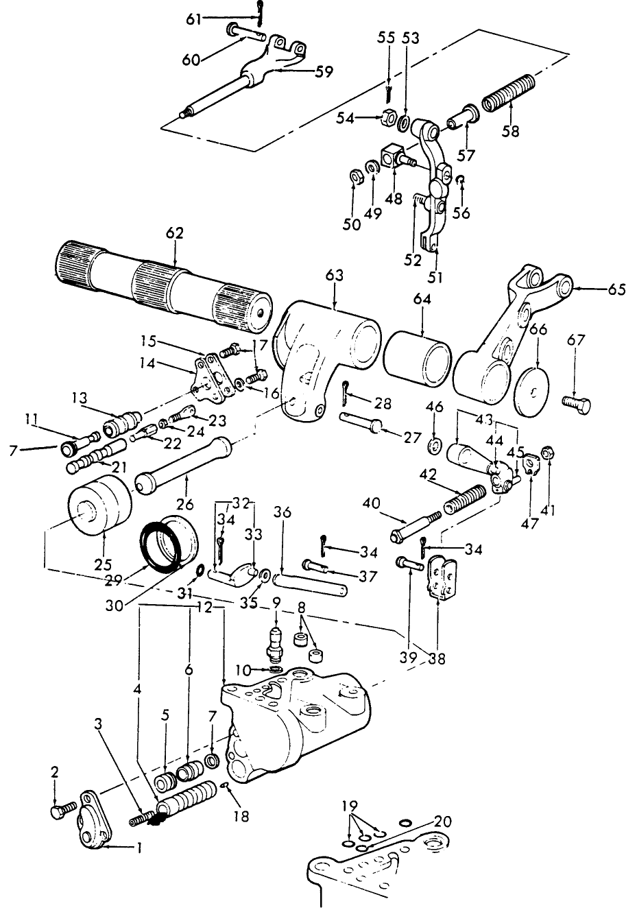

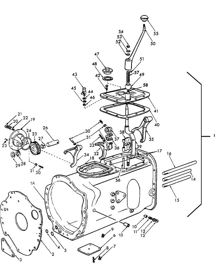

No(*).. this pump mounts directly to the side of the engine ( cam driven ).. then there is a hydraulic manifold that bolts to the base of the front of the pump, and then bolts to the center section.. there are feedthru tubes in the center section to pipe oil back to the rear section.. at the base / entrypoint of the rear section is the relief valve.. oil then travels up the side of the rear section and is fed into the lift cover. from there it takes a path so that remote hyds can be tapped via a blank off plate, and otherwise it is fed to the unloading valve and mounted 3pt hyd cyl.
there are no external 'hoses' on this setup.. just internal passageways, piping and manifolds.
in the attached pics, the piston pump has a manifold that bolts to it.. the manifold also bolts to the trans.. in the trans pic, you can see the oring 4/5 for the seal.. in the rear housing pic, you can see the other side of the feedthru tubes with oring 7/8 and the relief valve 13.
in the liftcover pic you can se ethe blank plate I speak of.. and the lift cyl pic you can see how the cyl attaches to the underside of the cover... it's all oring and gasketed connections here..
