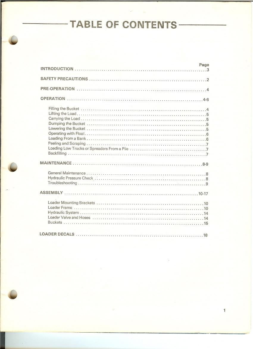

I just bought a Ford 1710 with 770B front loader. Came with 2 L shaped bars with 1" pins for removing front loader. Not sure how to remove loader according "to the book" because I don't have a book. My 1920 w/7108 is very simple to do. Amy one know where to grt an oprators manual? Thanks.
   / Ford 770B front loader #2
I have a 770 FEL manual. It has assembly instructions but not removal procedure. I have not worked a good way to remove the loader so have left it on. If you have trouble finding a manual send me a PM and i can send you a copy or scan.
   / Ford 770B front loader #3
Choose Items
Sounds like the other guy has an assembly manual, not an operator's manual.
   / Ford 770B front loader #4
I can only go by the manual title
   / Ford 770B front loader #6
The assembly instructions assume no assembly has been done to the loader
Saw that manual on Ebay. Asked seller if it covered the 770B, aswer was NO. Thanks anyway.
