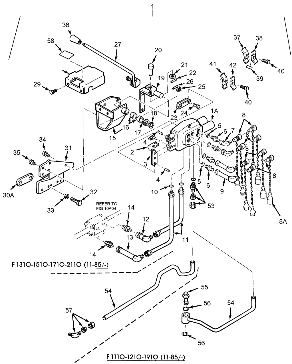

Ford 1900
Does anyone know where I can get a schematic for the single lever joystick controller? One of the pistons is binding and both pistons are leaking fluid from the top.

I am not finding the page you show or any other. When I click on 1710 3-cyl compact tractor I do not get any functions to click on to take me to the hydraulics. Is this because they have removed them or am I doing something wrong?
I am interested in what is down inside the valve body that is shown in the diagram you posted.
thanks in advance for your assistance.

Thank You! Exactly what I was looking for.
   / Ford 770-B #6
How much of this is adjustable? I have a bucket that dumps very slowly but curls much faster coming back. I'm wondering if a bushing or something is loose.
