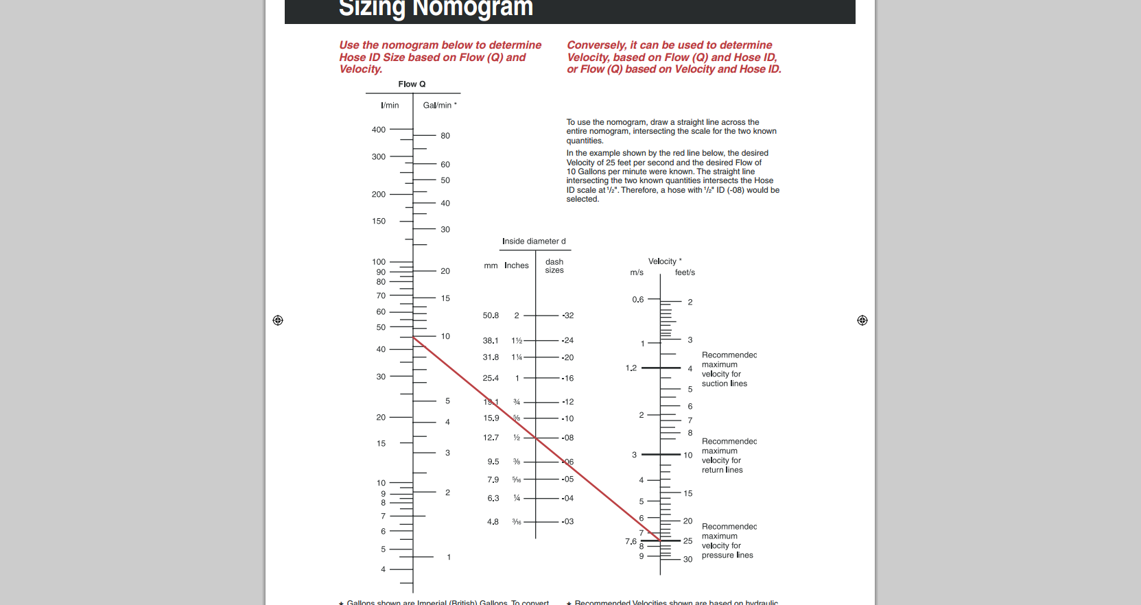

   / Ford 753 BH flare fittings degree? #5
What is the GPM going through the BH.
7/8 in will flow over 25 GPM.
You could go smaller hose size if the flow is smaller.
