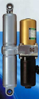

Just bought a Ford 1210 with 60" deck. While I was picking it up I saw a Ford 702A front blade on the used lot. Does anyone know if it will fit the 1210. Looks like all the mounting hardware is there. How does the hydraulics work if I have no remotes, can you run something with the PTO?
   / Ford 702A Blade #2
How wide is the 702? I expect you dealer can tell you if the mounting hardware will fit. if not it's probably pretty easy to modify to fit. If I remember the 702 right doesn't it have two long arms that mownt to a bracket towards the middle/rear of the tractor. I think you'll find that it will be easier to add remote hydralics rather than deal with a PTO pump, tank and valve. I might be more inclined to use one of the self contained electric units that looks like a hydraulic cylinder. Then all that is required is a switch and a couple of wires

I still haven't had a chance to find out the name on the Cub cadet cylinder. I did come across a self contained "Linear Hydraulic Actuator" from KYB that might be of interest, not just here but for anyone who needs another degree of hydraulic contron and doesn't have enough hydraulic circuits. It's from KYB America LLC in Addison, IL 630-620-5555 hyd@kyb.com http://www.kyb.com/power/hymm.htm

Thanks for the info Andy. Looks like I can run 1 remote off my tractor so this would be good for the blade up and down. Then I could run the angle with the tractor remote.
