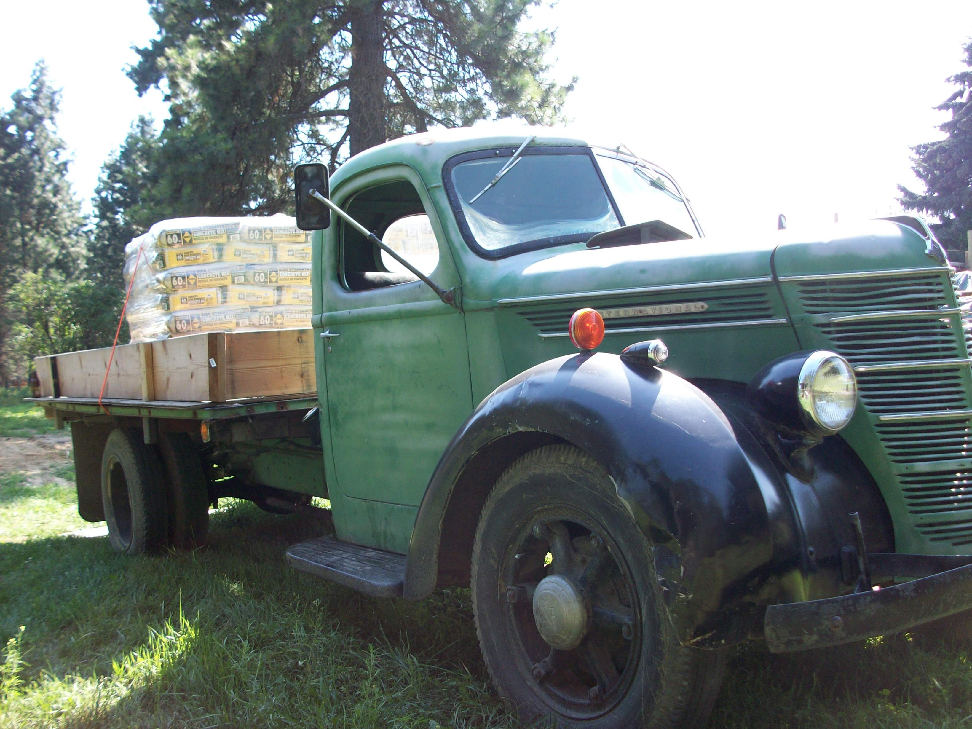

Owned a couple sold my "green diamond" equipped straight 6 flathead DS 15 international Dump truck a while back.
It Got the "High output" engine, because of being a 1 1/2 truck- so equipped with the larger displacement engine which made a whopping 93 HP
