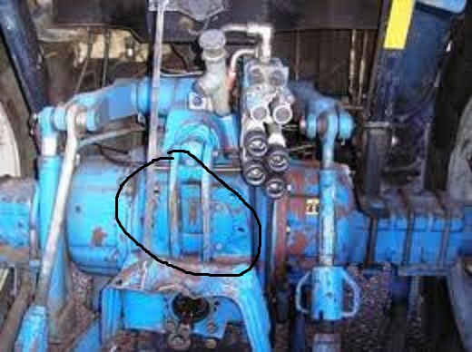

Thanks for the advice. I have attached a picture of a PTO (similiar) to mine. To get to this solenoid, would I need to take off the plate (circled on the attached picture) to do this?

no the the soleniod is on the left side of the rear axle housing inside but the wires should stick out of the side off the housing in front of the axle housings u must pull the lift top to get to the soleniod if i remember right

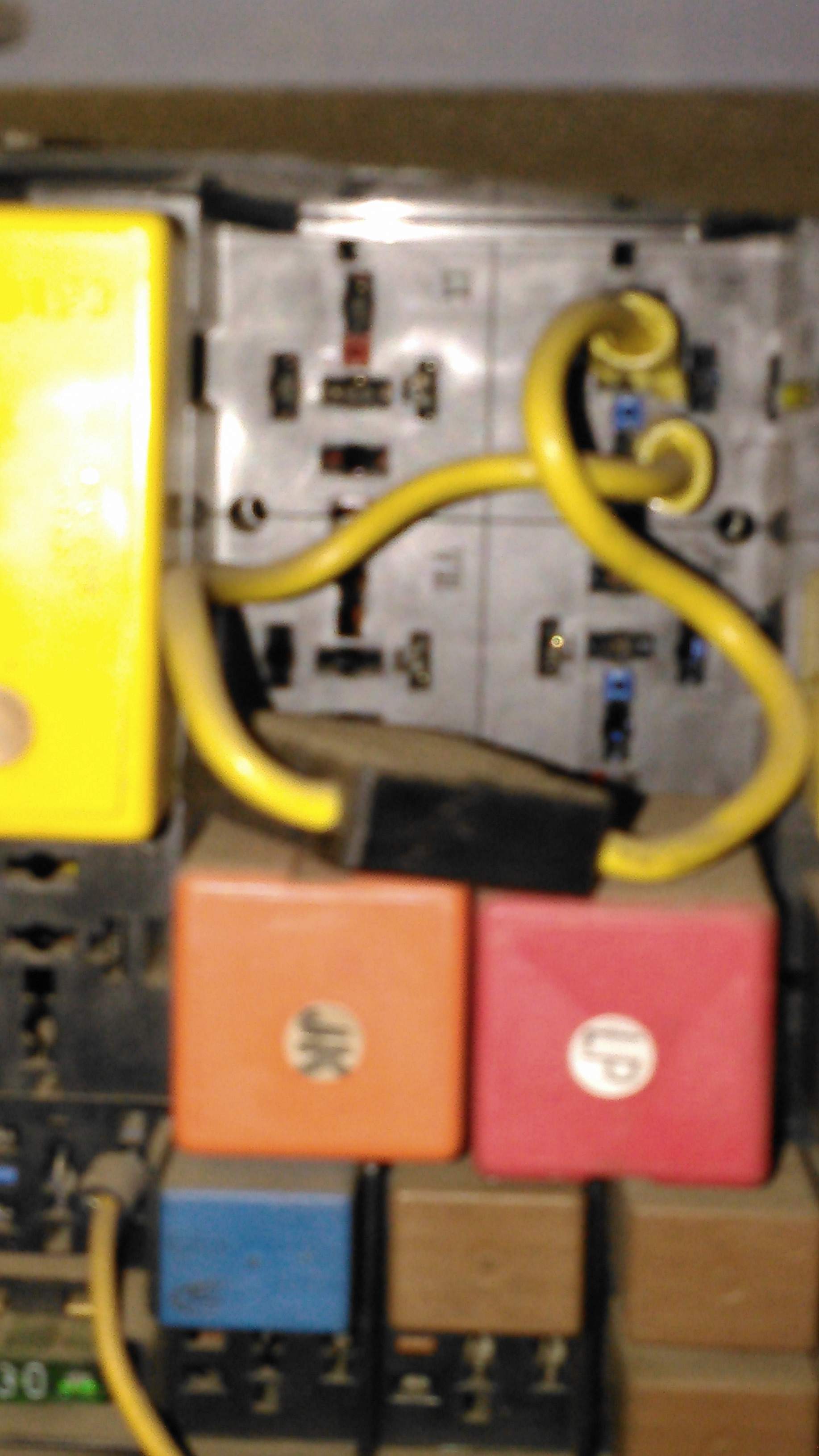

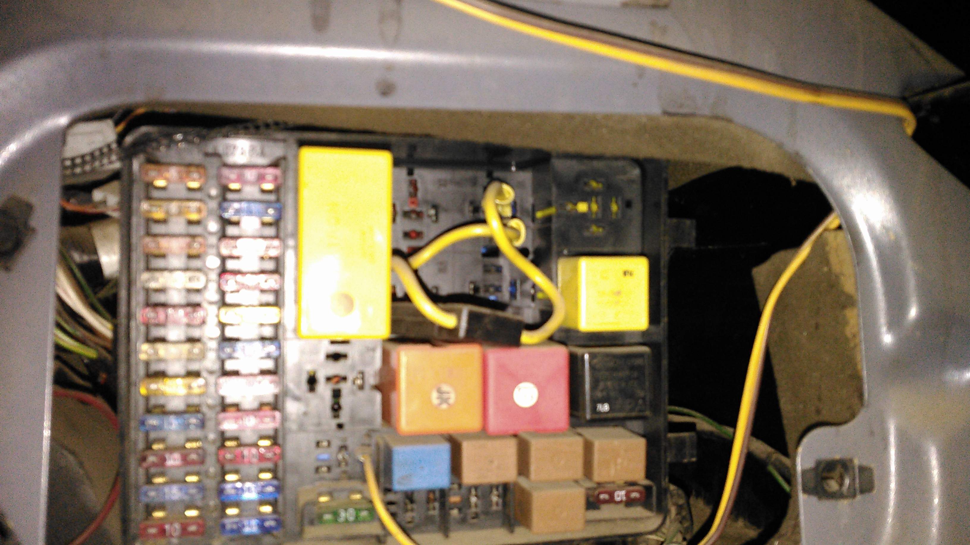

Here's some pictures on how we by passed ours with an inline fuse. it's been working fine now for over 4 years. Just remember If you leave the switch on when you shut off or stall the tractor the pto is on when you restart the tractor.

Thanks for the pictures, looks like one end of jumper goes in the center hot hole. Its not clear to me which hole the other end goes in.

We used the middle and bottom slot on our 6640 Sorry picture isn't clear enough.

Once we removed and bypassed Safety relay (in the pictures above)in our 1992 6640 the pto works fine turning on and off with the pto switch now. I think all the relay is for is so the pto won't restart if you shut off the tractor without shutting off the pto switch and then restart the tractor. We put the fuse inline to further protect the circuit, but be aware the pto will turn on when you restart the tractor if you leave the pto switch in the on position. We also had intermittent pto before removing and bypassing the relay. This intermittent problem could have been caused by a failing safety relay or as one person informed me possibly a bad or failing alternator as he said the relay senses if the engine is running by a sensing wire from the alternator. Our alternator totally failed and we replaced it a few months after doing the bypass but we left the bypass in place.
