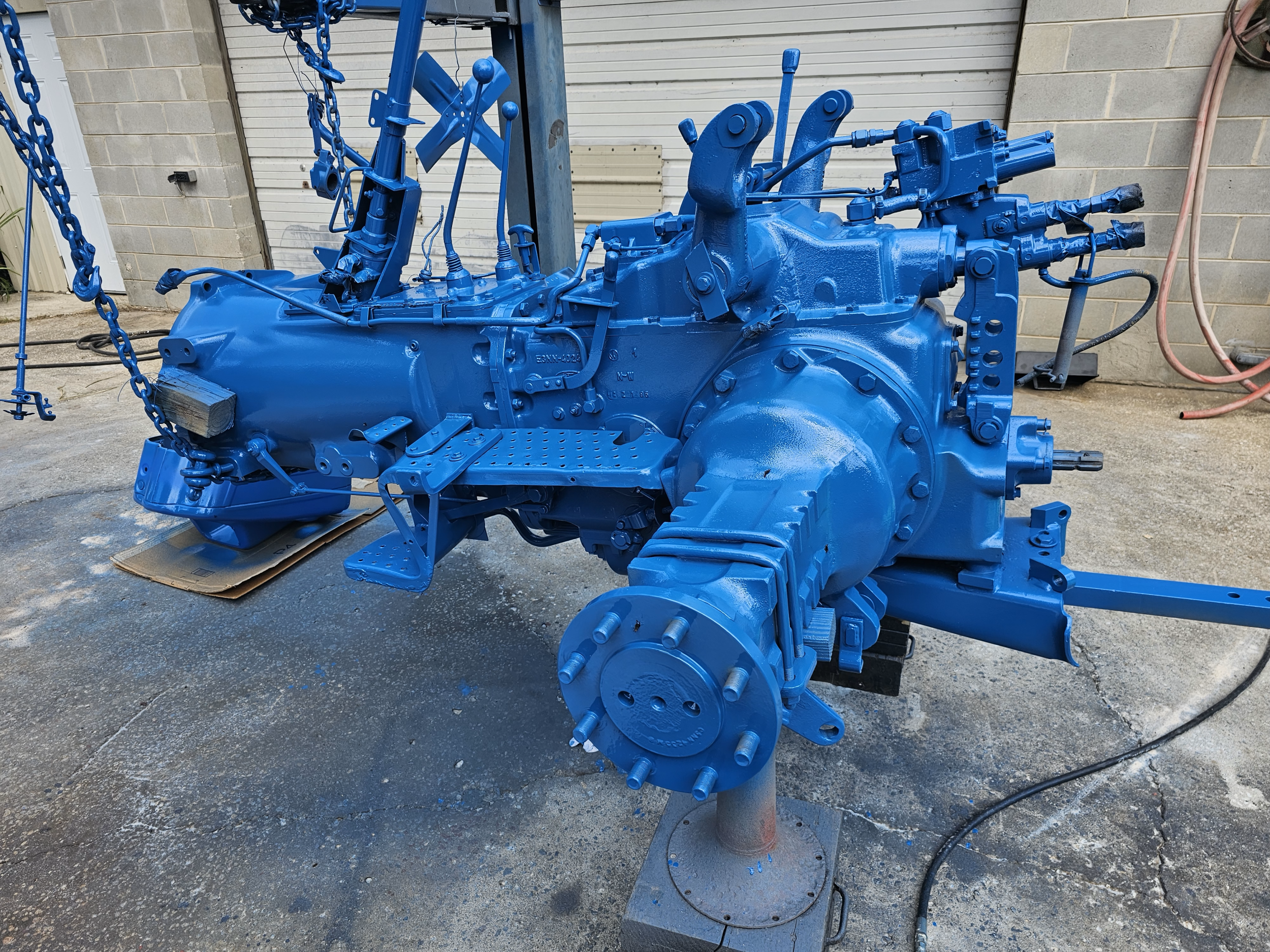

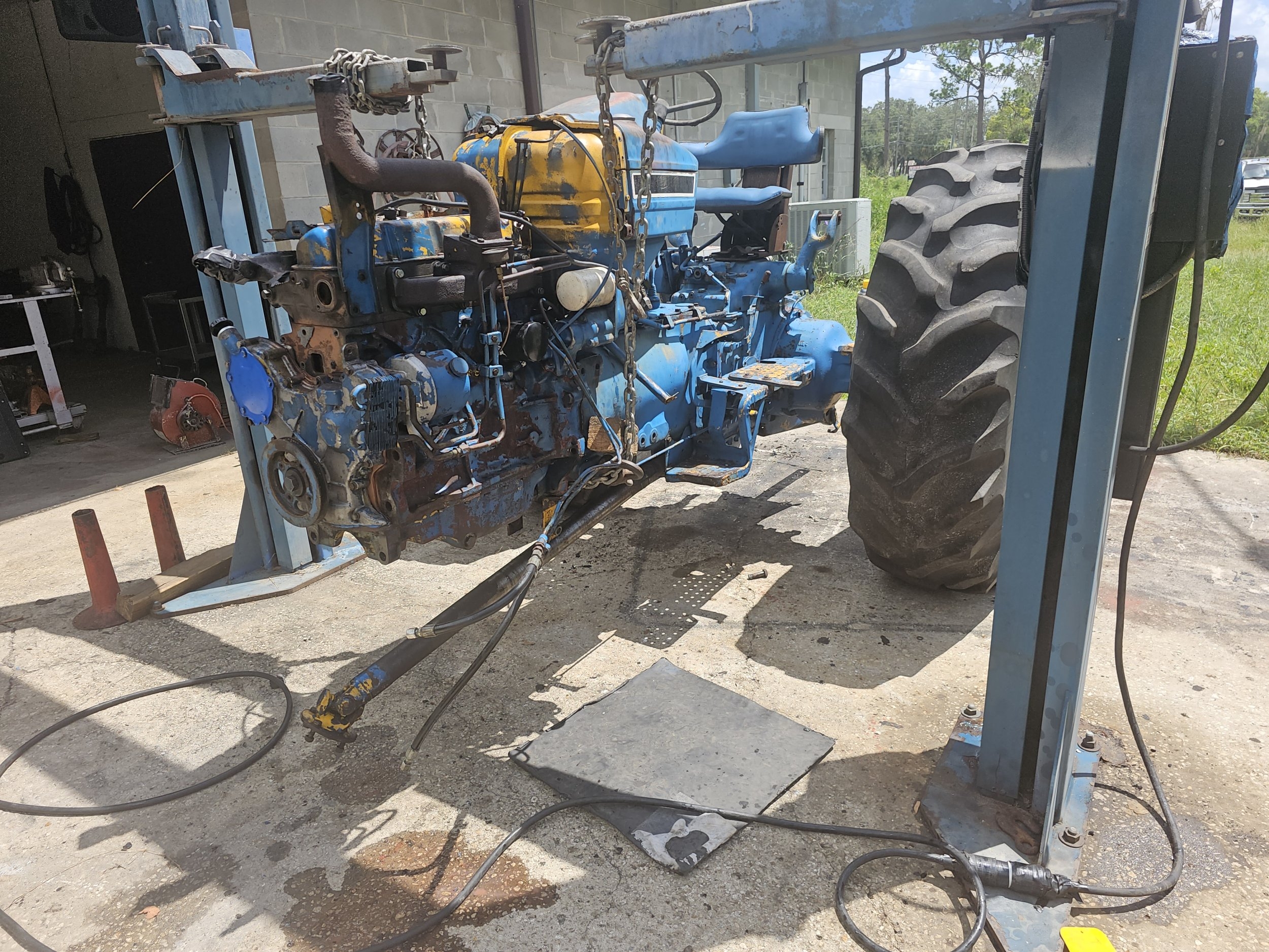

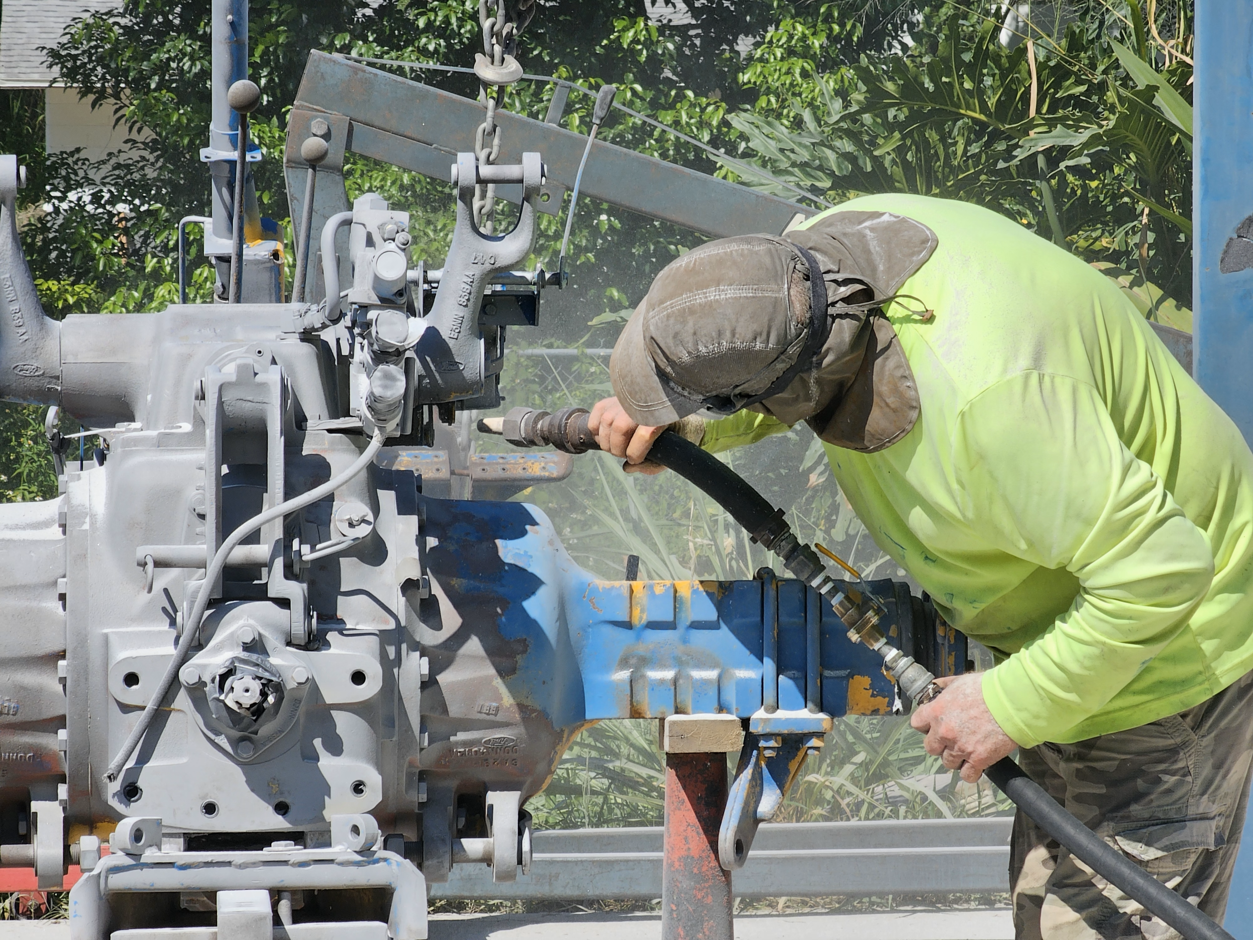

Nice 5 gallon finish lol Where is the rest of the hood? 3 Layers of paint sandblasted off Blue/Yellow/Blue again. The hood and the decals are the final touch when all the bugs are worked out

If my feeble memory is correct it the cover with lift arms shown in last picture where finish painted blue. Probably will scratch that nice paint job taking the cover off.
I know there goes the "Show Tractor" Trophys :(

Because the the great paint job on the cover will be scratched when removing it to repair the PTO
