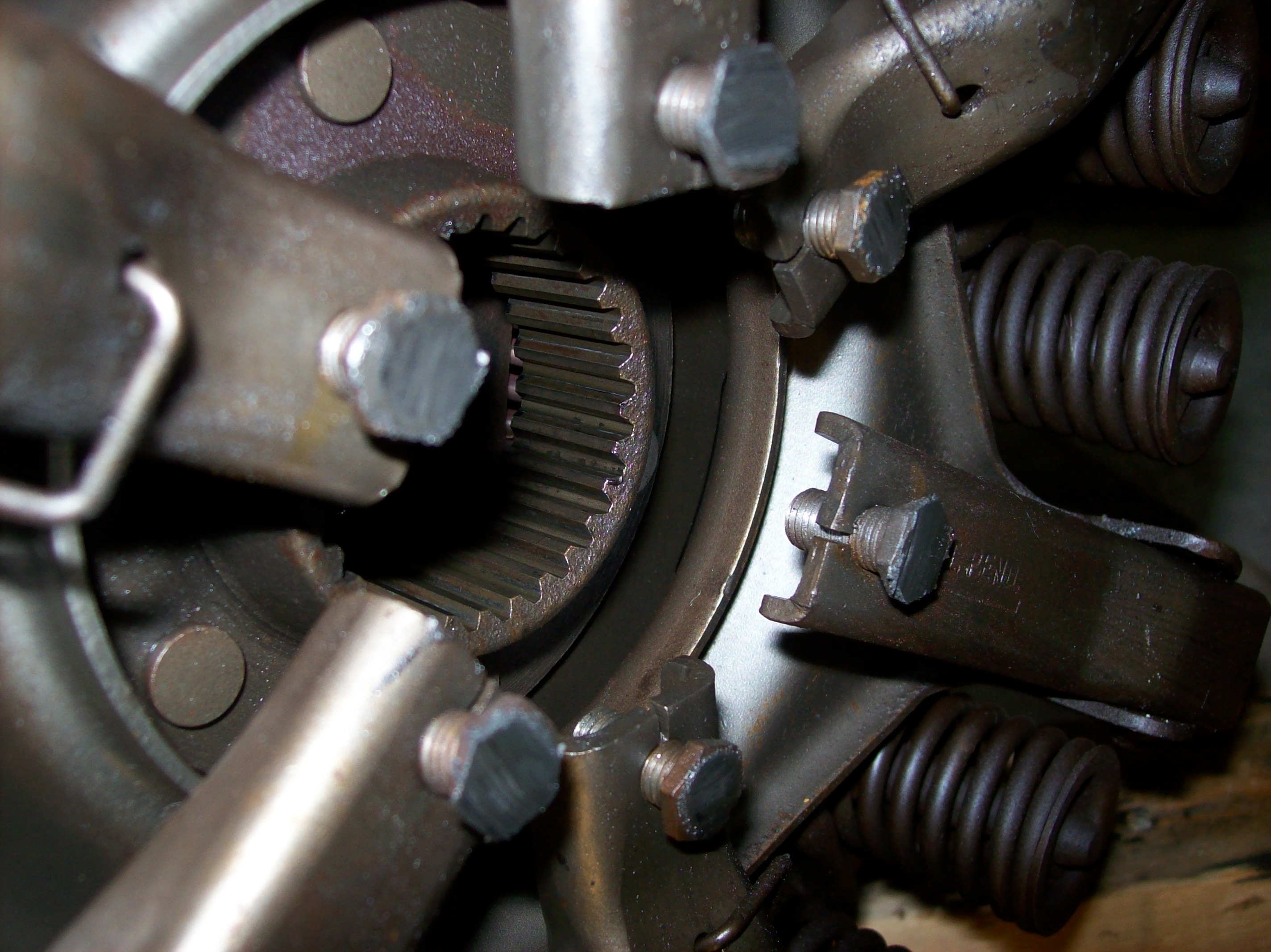

This was my 1958 861D old 2 stage clutch & the worn fingers that ride against throw-out bearing before I replaced them.

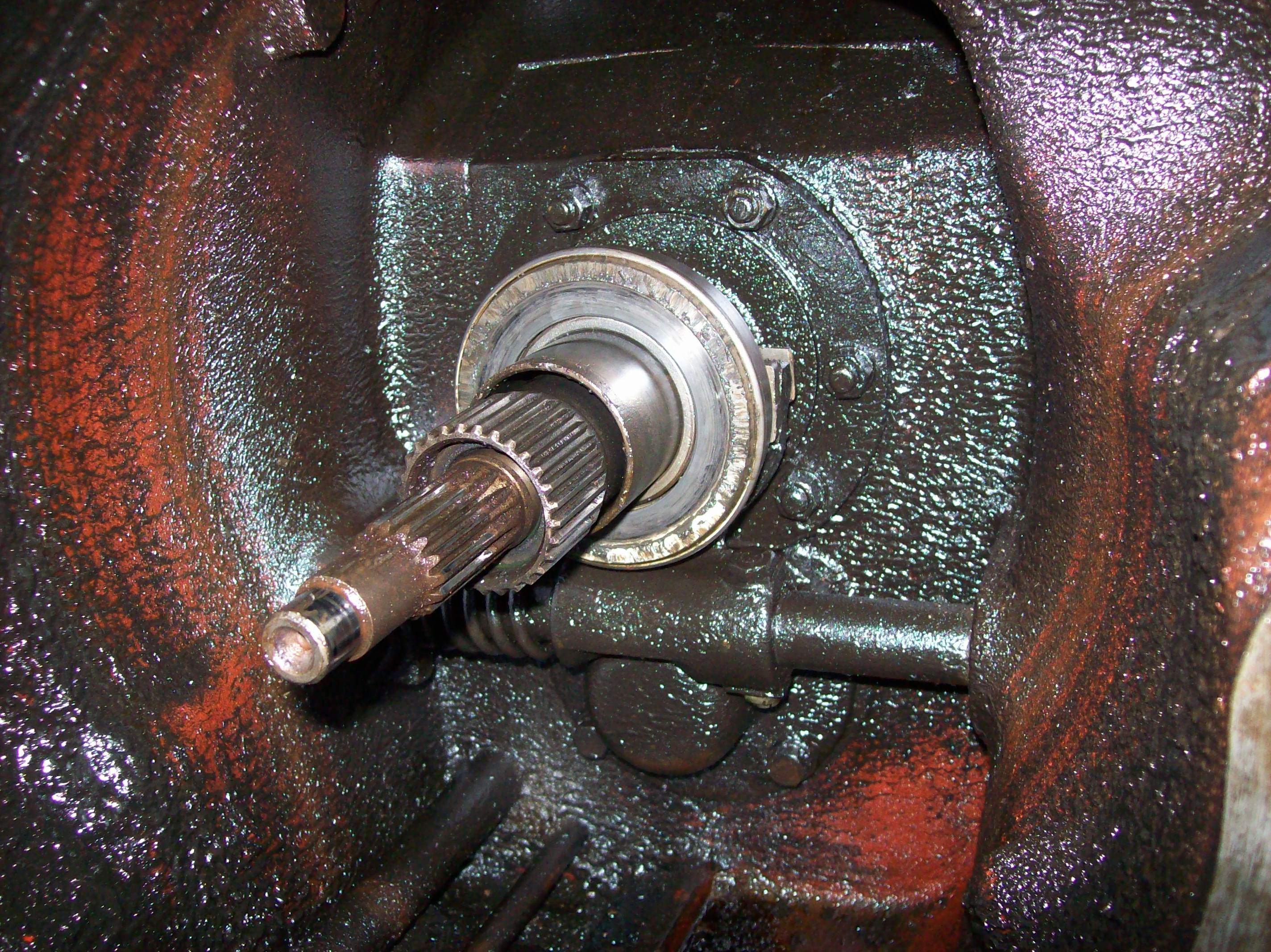

And this is looking into the case at the throw-out bearing and clutch shaft. Your 660 is probably similar.
