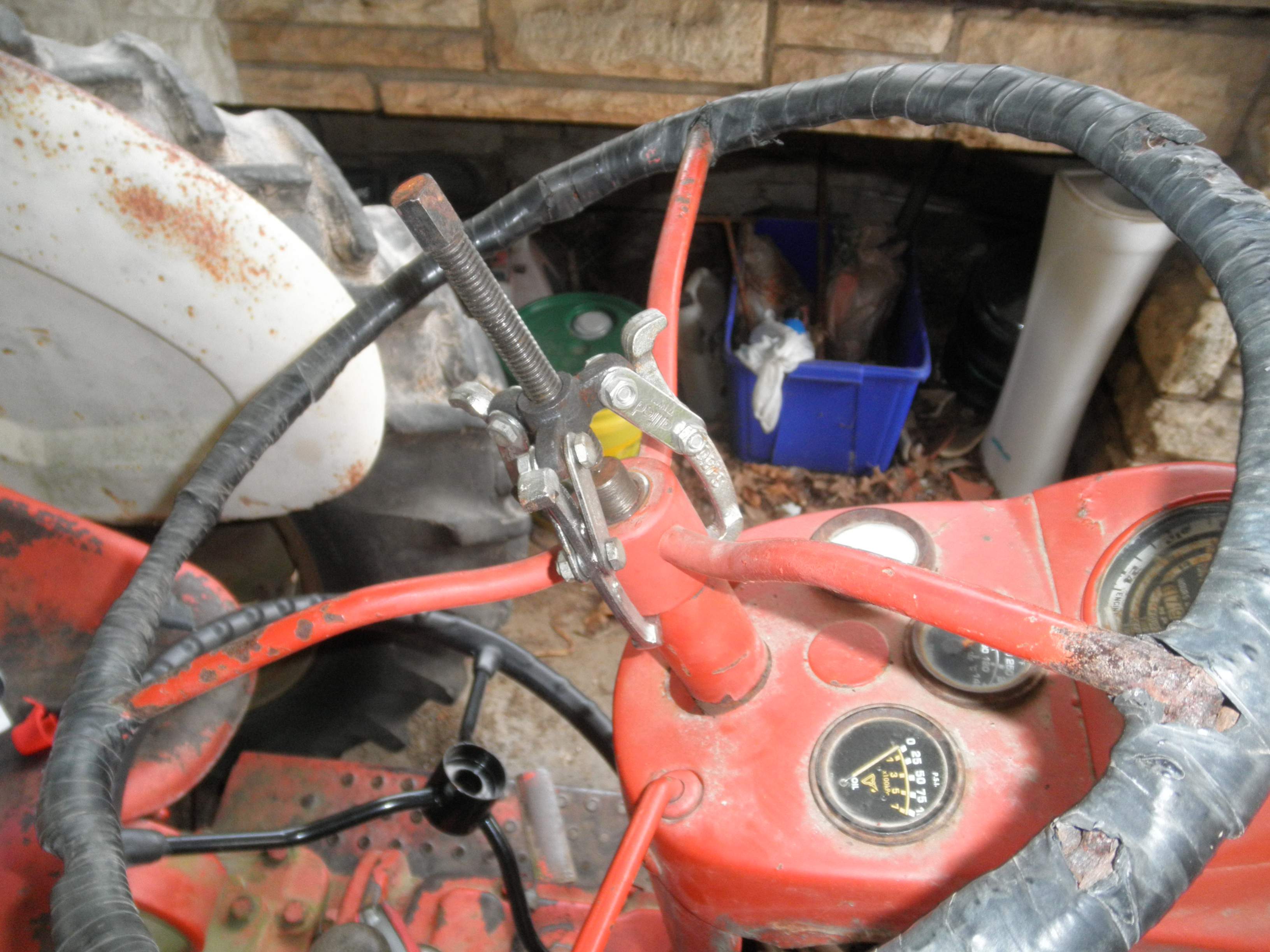

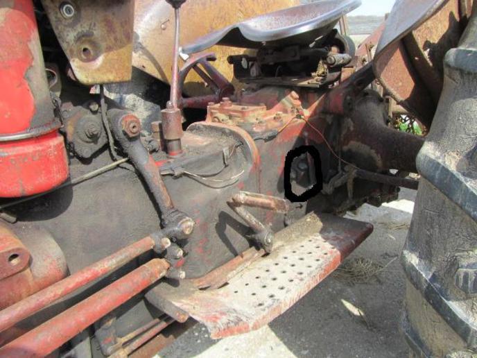

choke on a red tiger is not dash mounted.. and is NOT cable operated.. it's ROD operated.
look at the base of the steering box, left side.. there will be ( should be ) a lil metal tab, bent up with a hole in it, under a steering box hold down bolt.. rod passes thru there and to the choke arm on the carb. easy to make up with some 3/32 or 1/8 rod if you have to.

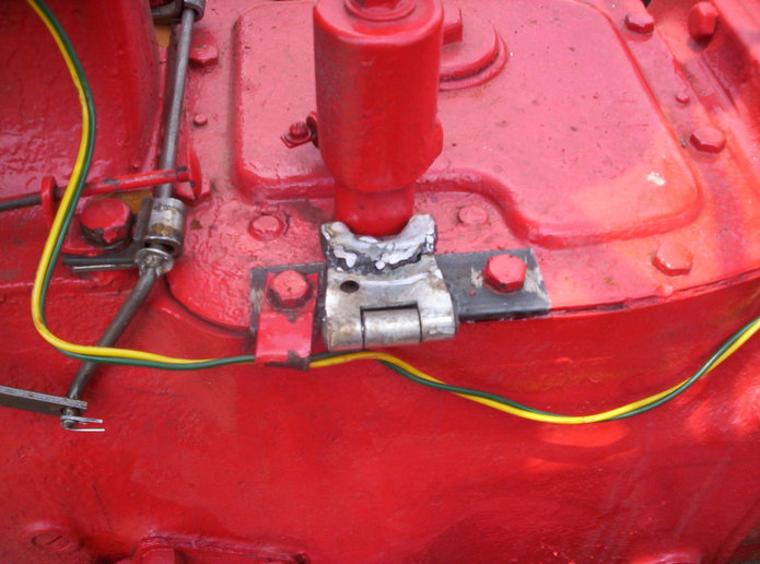

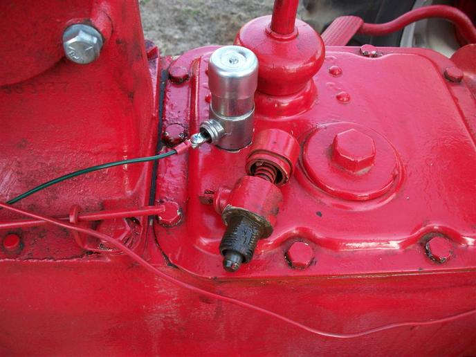

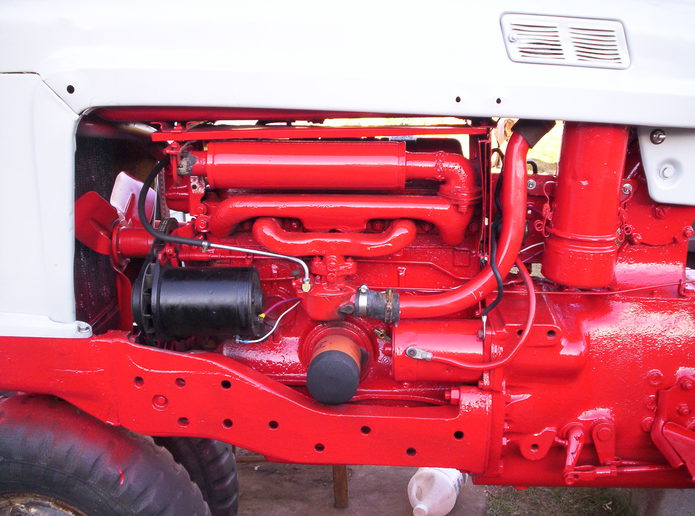

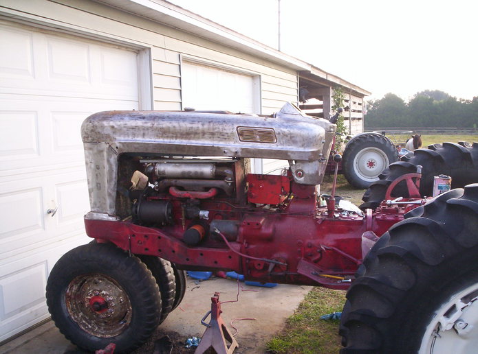

here is a close up and then a farter out shot.
first pic I have removed the choke rod head to as I am working on the starter switch.
next pic is a different, dirty tractor.. but you can see the rod go behind the air cleaner.
3rd pic shows yet another tractor of mine I added a foot throttle to, and you can see the choke pull head / rod
next pic you can see an old 950 trike I'm working on, and you should just be able to make out the rod running from the base of the steering box over to the carb, air cleaner is removed.. so is vissible
next pic, same tractor.. closer up.. after I got her back together
hope this helps
