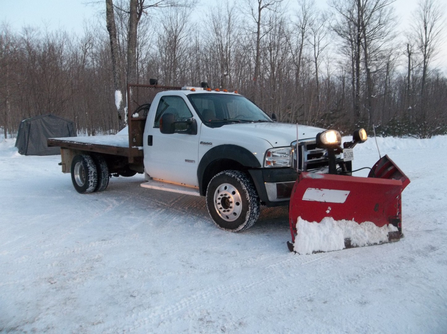

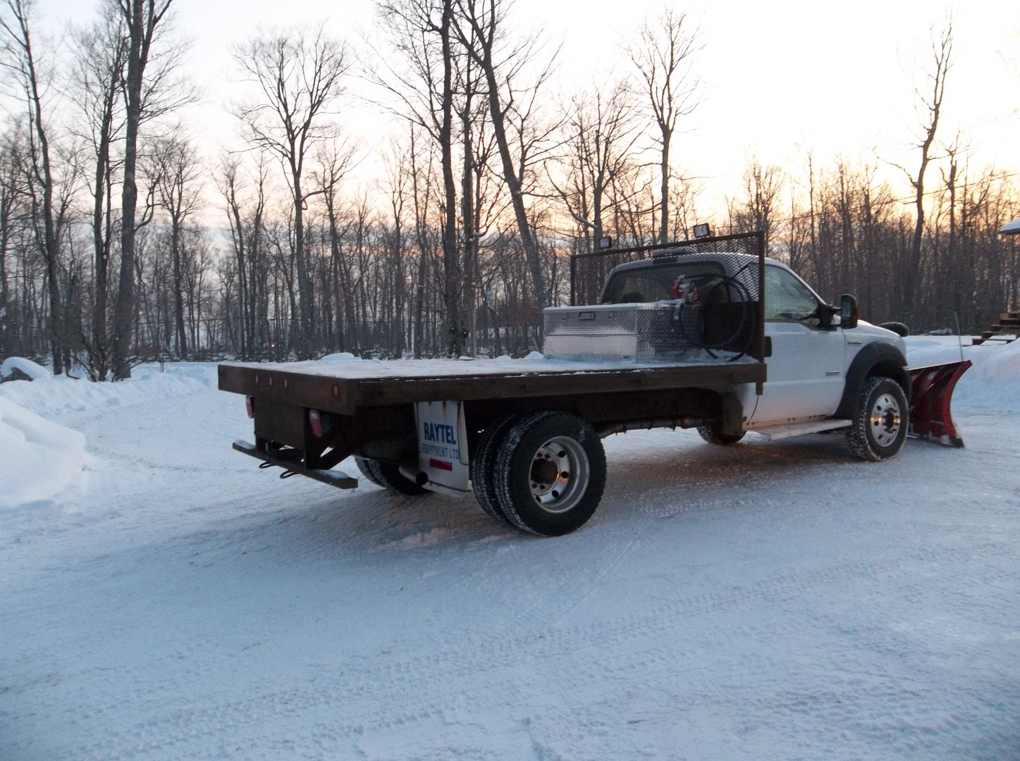

As with me buying another 6.0 Powerstoke truck. I bought this 2007 F550 XLT for 15 grand cash. To replace it with new here in Ontario Canada it is $100,000 for truck and deck. The Boss plow is 12 thousand here. And I'm not sure what my VMAC VR70 underhood air compressor system is worth?
So all I know is I can do a LOT of repairs to keep this truck going many many years with $100,000.
It just got a safety for that price, a complete new exhaust system including the catalytic converter, a rebuilt plow pump and the motor was replaced last year and it is ARP head studded and has the Bulletproof egr and oil coolers.
Just gotta paint the deck and replace the missing hood deflector.
