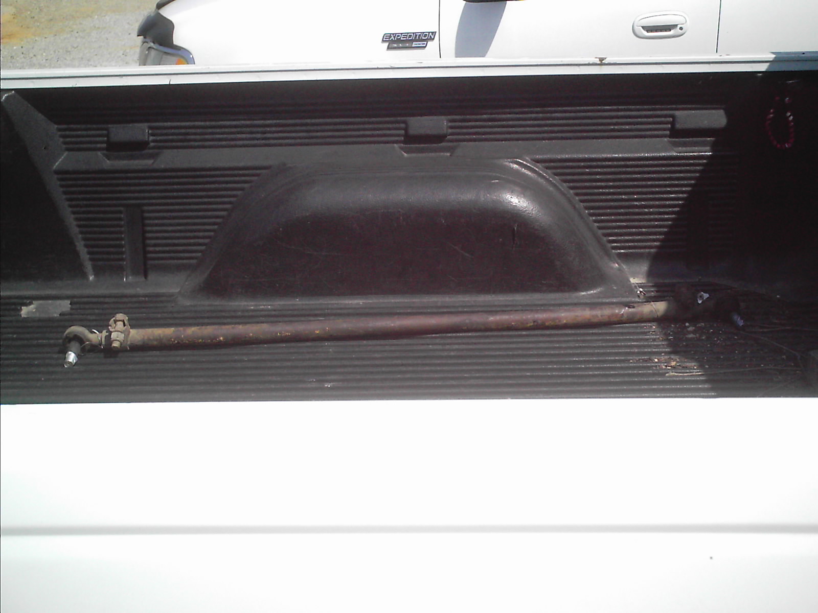

I broke a tie rod end last night on Lil, my hoe................:D
Checking around to buy new ends, they have reached a little past their life expectancy, and was looking at the large link between them, and wondered just how bent up mine was.
Does anyone have a similar hoe? Like a D or E with 4wd?
Could you take a gander at the link that ties the two wheels together, the parts book picture shows it straight, and if that is the case, mine is bent to patootie, but I am wondering if it is just straight in a drawing and in real life those bends are supposed to be there?
Thanks for the help.

Found a "used, in good condition and straight" complete draglink with both tie rod ends. Said one rubber boot has a tear.
$150 plus shipping.
As my drag link looks like a curlycue, I figure it is worth a shot so it is on the way.
   / Ford 555C steering linkage
Yeee Haaaaaaa,
Would look better under Lil, but hey, back of my truck in 24 hours from ordering it is pretty dang impressive.
