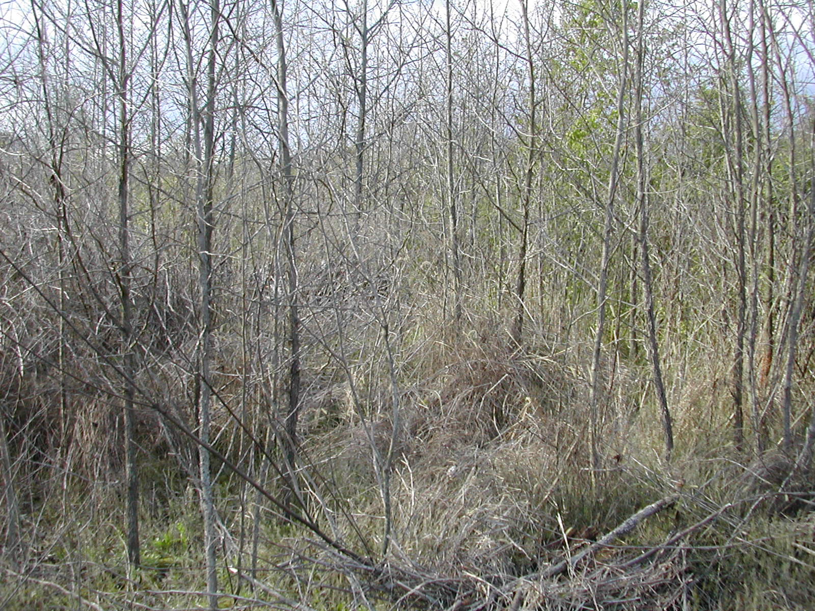

Pictures of what I need to clear, about 2 acres like this.
No, I am not in a rush, it is what I wanted to do with a mulching head, but I am finding soooooooooooooooooooooo much metal and other trash (pipes, fence, etc. etc.) out there it would not be worth spinning one up in there. Somebody would be hurt, or equipment damaged at the least.

You don't need a thumb to clear those little trees. I have spent the last year clearing 2 acres for my new house and pond. The forest is every bit as thick as what you have, but with big hardwoods mixed in that I have had to dig out and push over as well.
A thumb may help a little, but I have had no problem uprooting and carrying large numbers of saplings. You just set the backhoe in position and start clearing and then swing the hoe all the way to one side and stack the brush. All it takes is a shallow scrape with the backhoe bucket and they pop right out. Grabbing them without a thumb is not a problem. Once you get a system going the only thing that will slow you down is how fast you can burn the brush piles.
The only times I have wanted a thumb is when I have tried to grab big logs on frozen ground or when I wanted to grab logs without getting a bucketful of dirt along with the log. When you are trying to harvest nice logs its important to keep them clean.

Are you pinching them against the boom? Or I guess could you explain how you are moving them out.
I have been digging them up, and am getting better at my depth control (little experience, and little practice time) but it still is taking someone on the ground (usually me) to pick up the trees and move them out of the way.
I am wanting to get out of the get out the cab and move stuff around end of things.

My land is very similar in places and I've spent many hours taking out little trees just like that with my backhoe. The dozer will do it to, but not as cleanly. It also has a way of cutting them off and leaving little stumps behind if I get going too fast.
I like to just back up to them and use the hoe to take them out one at a time. My technique is to first push them away from the tractor and get them flat, then using the teeth of the bucket, curl it in and off to the side. They will pop right out nice and clean. Then I make a pile of them and clear the area behind me so that I'm not parked on any when I work my way backwards.
Two acres is quite a bit, but once you get going, it moves along at a nice relaxing pace. Be sure to have lots of bug repellent on you and a can of Wasp Spray handy. Sooner or later you will hit a nest of some kind and they will come after you. I've been lucky and only been stung a few times, but I have had a bee hive come at me and I sprayed the entire can of wasp killer around me, on me and all over as I made my escape.
Burning the piles can be more work then taking out the trees. The thumb on the hoestick is only good for moving stuff around, not for moving stuff to the burn pile. Having a grapple, or thumb on your front bucket is what you realy want!!! Until then, you can scoot the piles to your burn area with some degree of effort and frustration. You will get better over time and the slower you go, the easier it is. Just don't be suprised when you have to do some by hand, and others with a chain. I've drug thousands of threes with a chain and expect to do allot more before I'm done with my place.
Eddie
