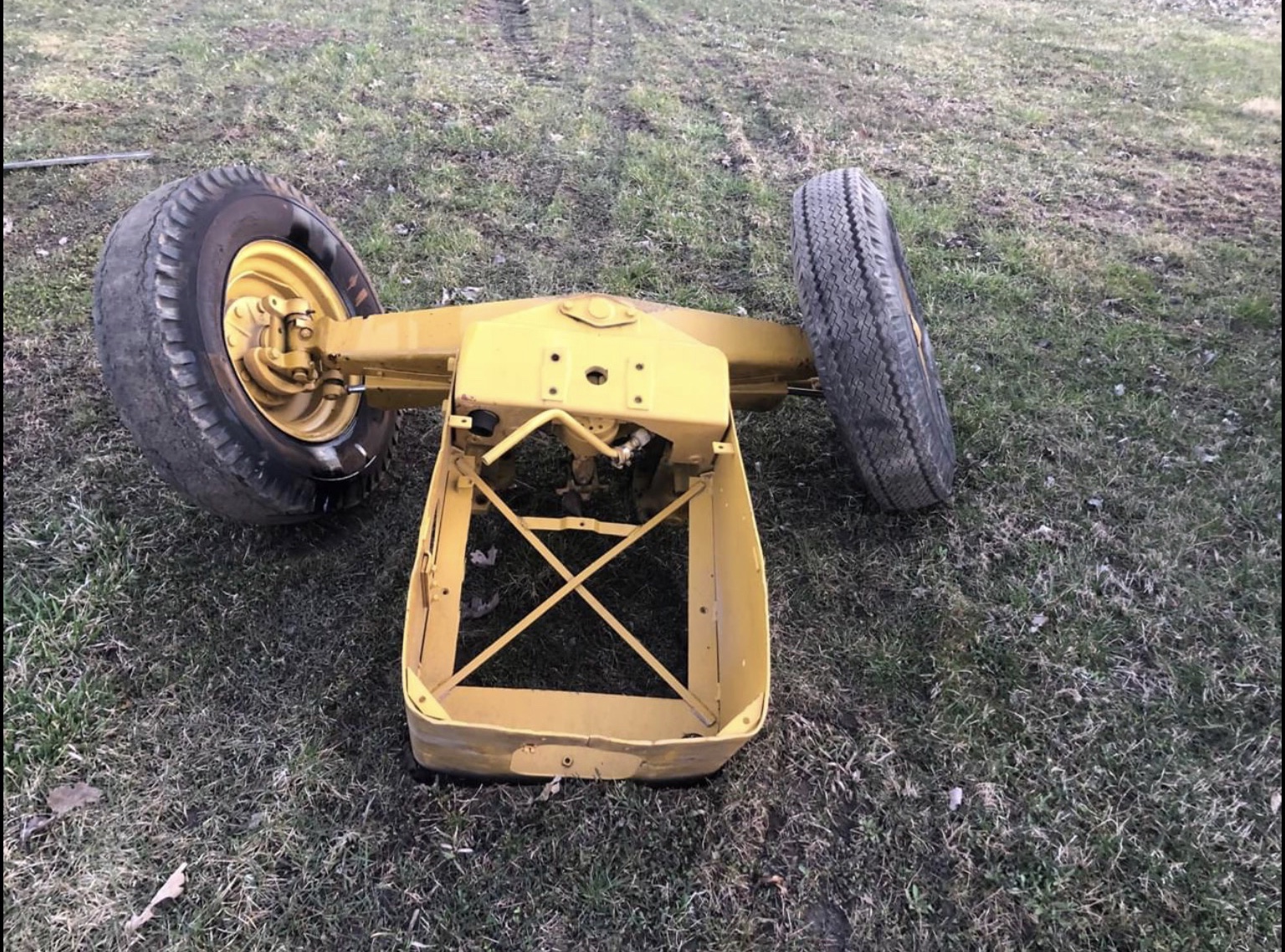

Hi, came across a 545a axle (see picture attached). I have a Ford 555. Axle on mine have egged hole where pin goes through axle and bushings for pin on spindle are wore through into spindle itself. Does anyone know if this axle off 545a would fit on my 555. Thanks.

I looked at the parts diagrams for both models at Messicks New Holland parts. The spindle bracket appears to be different between those two models. The 545a list the following models for its axle: (03A02) - FRONT AXLE, STEERING, 445, 445A, 450, 545, 545A (78/); 340, 340A, 340B, 540, 540A, 540B (4-81/) Hope this helps
