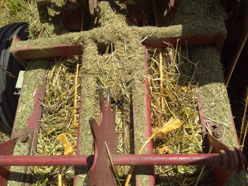

I’m not sure how to better describe it but when it happens the twine is still under the hay bale it’s just out of the needle. And it’s been happening mostly on the left side but it did do it to me once or twice on the right side as well. So maybe I’m missing something but I’m just not sure how if the twine is breaking it would still be under the bale unless it’s breaking part way in tying mode. The hay was also pretty tough but rain was in the forecast

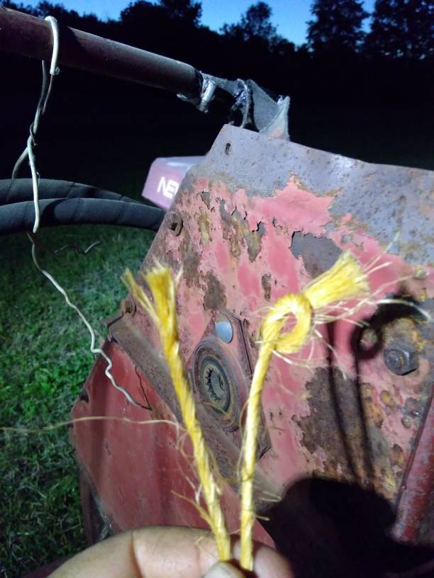

Can you post a picture of the situation? Twine "under the bale" could be a number of causes. A pic from the top side and bottom side would be a good start. Can you easily pull twine out of the bale box ? Since both knotters are affected, the old 'tucker finger' issue crops up. A pic of the ends of the mis-tied knot would also help. Is there a knot but only on one end ? Does the twine look like it was ripped or shreaded ? Answers to these questions will lead to a root cause,

Right now I do not have a picture but it looks like a clean-cut no sign of any knot

Did it look like these?

No there was just 2 ends like twine was just cut
