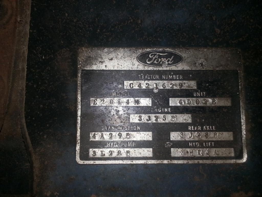

I have a Ford 5000, that my father-in-law bought. I am now looking to sell it and buy a newer tractor a little larger. I want to know what year model it is. I have found numbers all over and I'm not sure which ones will tell me so I have listed them all below.
On a badge under the cowling:
TRACTOR # - C421629
UNIT# - 4D02B
ENGINE# - 3J25B
TRANSMISSION# 4A29B
It also has the rear axle#, hydraulic pump #, and hydraulic lift # but I doubt those will make a difference in the sell.

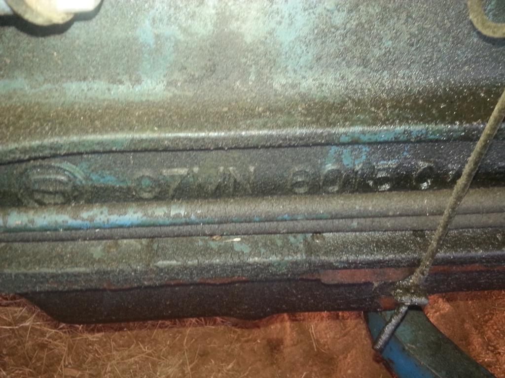

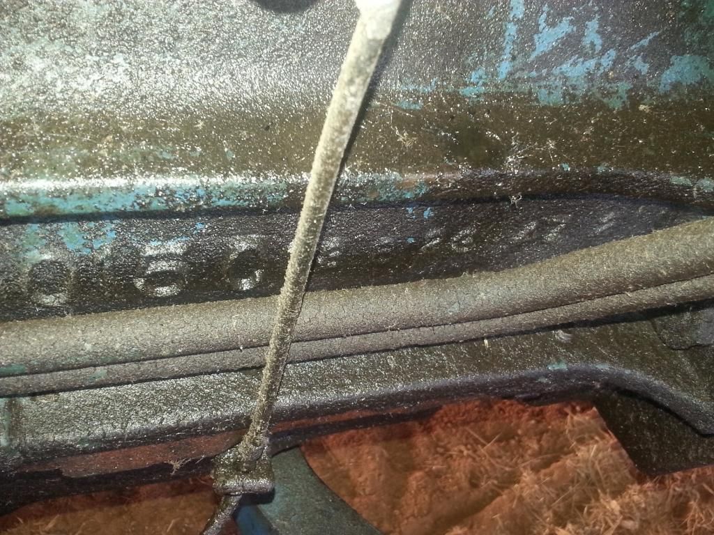

There are several numbers on the side of the block below the injector pump. I took some pictures instead of writing them down so I might have markings that I can't read.
C7MN 6015 0 8 8 23 47 2

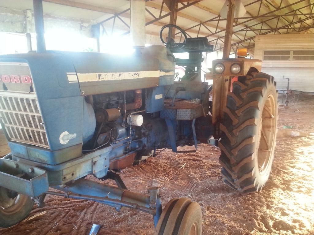

That 5200 shows a date code of April 2 1974 The sn range C421629 puts it in the mid 74 range as shown here with these year starting #'s/ C denotes a US unit.
1974 C405200
1975 C450700
e2014 late 5000 rowcrop chassis ( 5200 ) diesel, ind 540 pto. I can't make out the transmission letter code.. but could be dual power..

Oil cooler lines make me think it has DP. probably a good thing it's not next door.............................

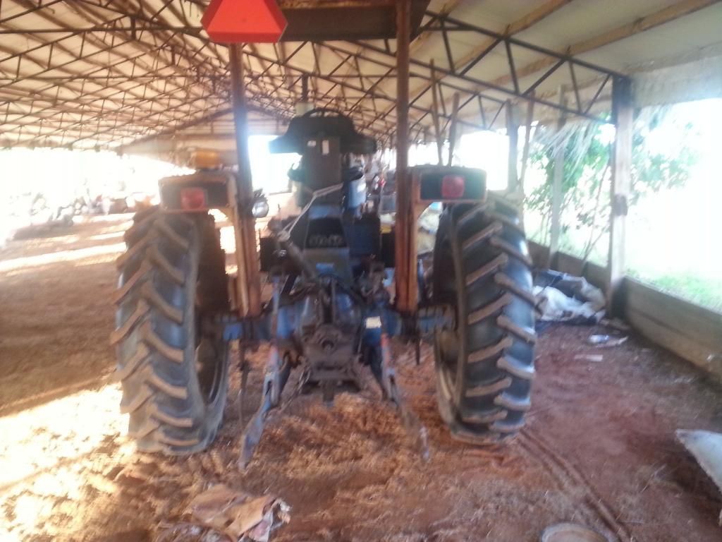

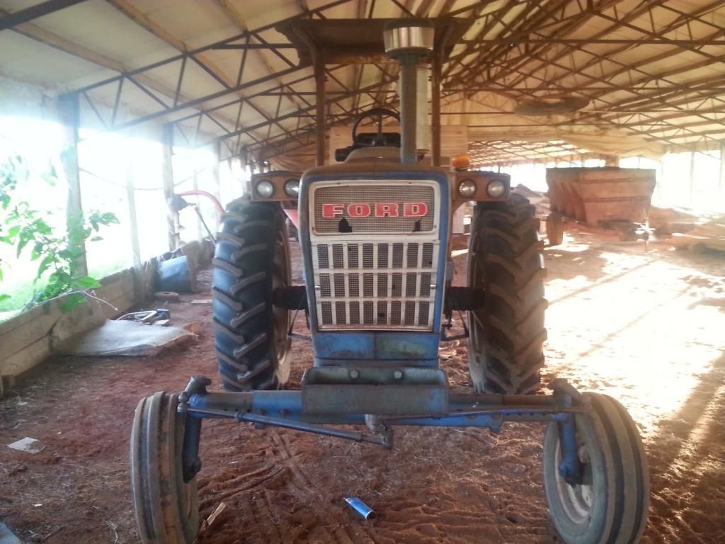

A second look shows the DP operating rod entering the clutch housing just to the right of the step support in the next to last pic. Road trip to AL, Sounder? maybe you could drop it off in Lincoln County NC at my sister's house.!!!!
Edit: Also the DP decal on the grille shell!!!! What a bunch of detectives we are!!!!!!!!!!
not bad i figure. we both pegged it for DP without even seeing the decal. ;)
