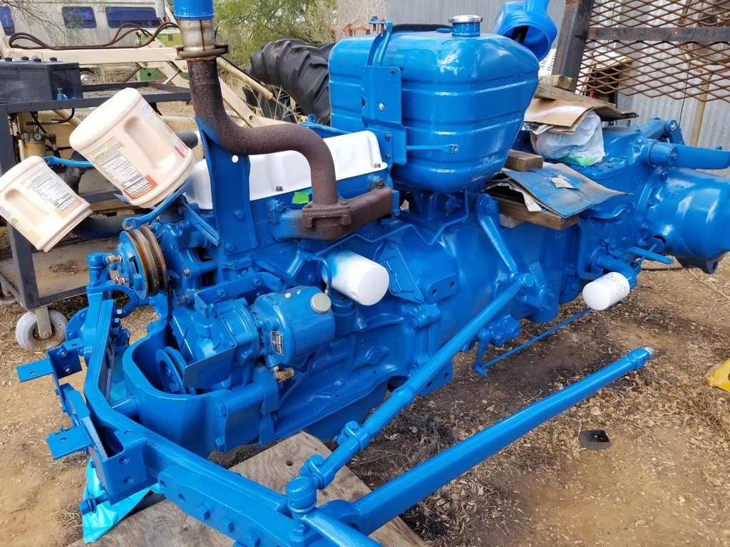

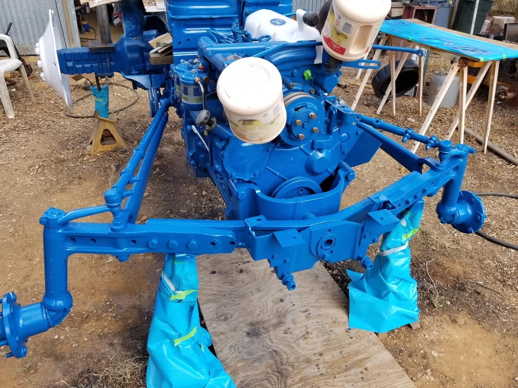

I've never done it either but I would think the cost out weighs the benefit. I would consider over hauling the current system. Below are pictures of the front of my 3910 if it helps your decision. Not shown are the actual steering cylinders and the mounting for the trailing arms. Half the trailing arm mounts are cast into the transmission.
