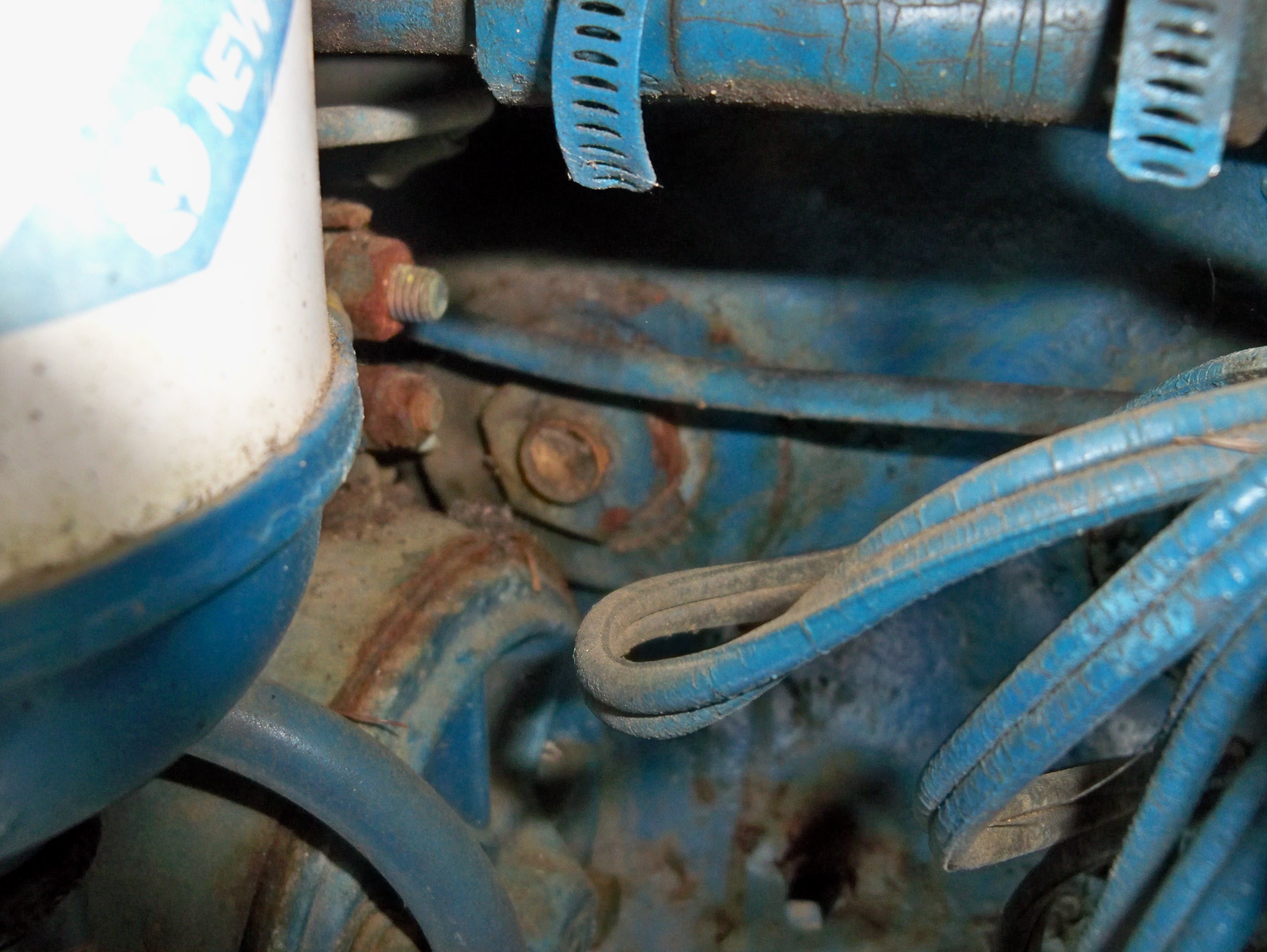

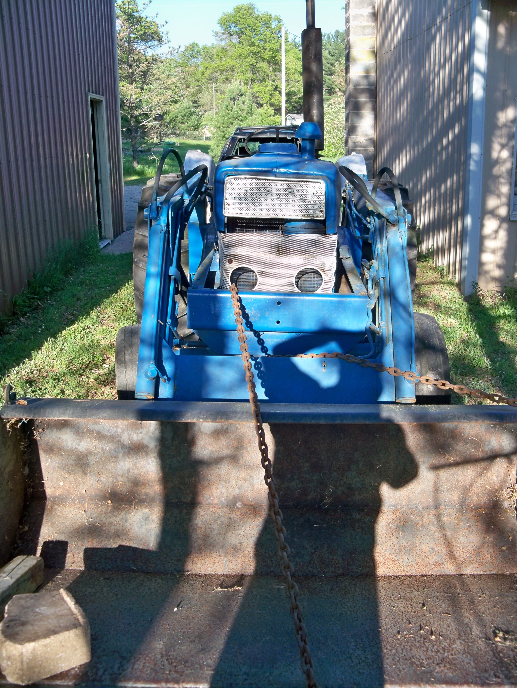

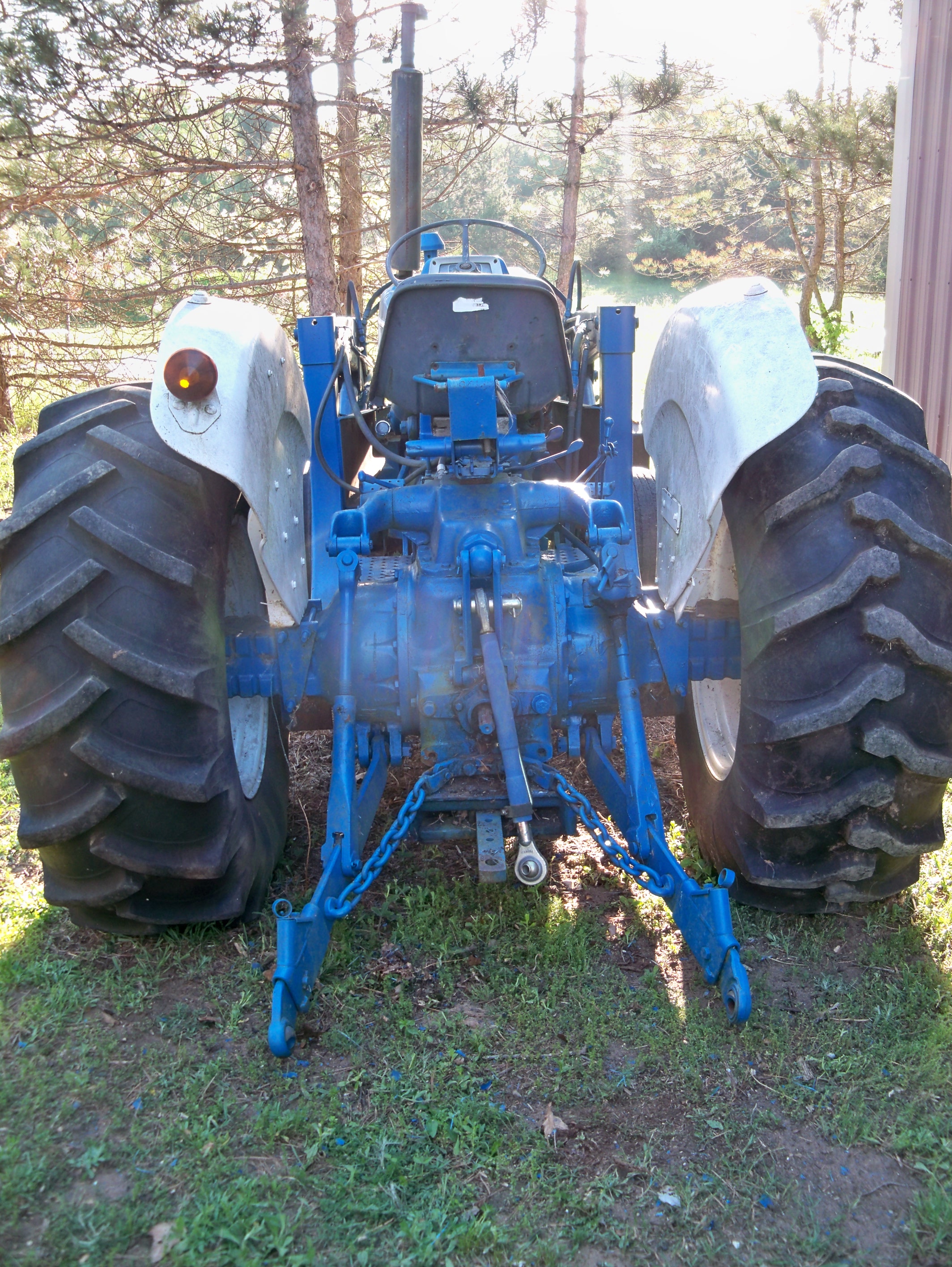

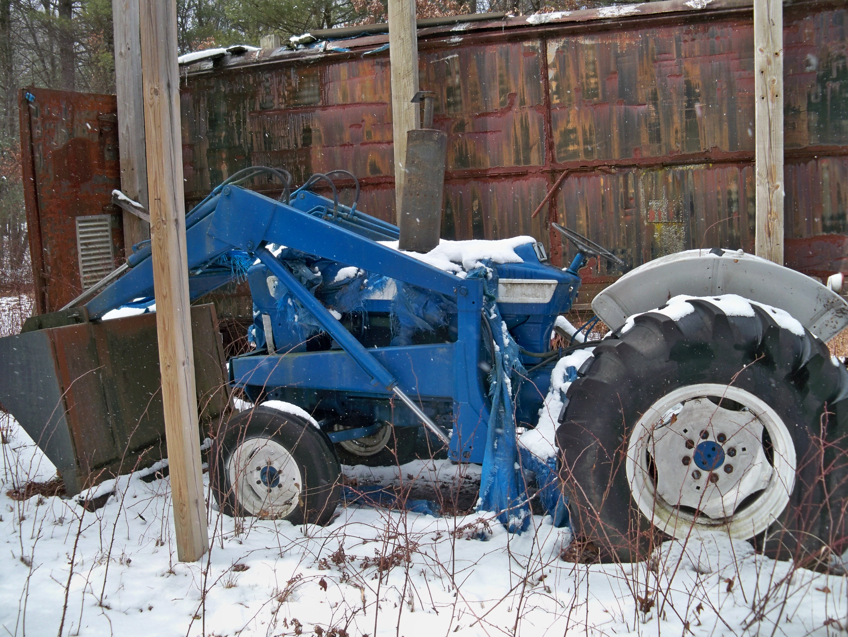

Hi folks ! I have a new tractor to me. Looking to get some information on it and have been digging. Tractor has been sitting since parked under it's own power for about 5 years. It was parked due to the clutch being weak and water in the cylinders. When run it smoked . I'm told he thinks it's a 1968. I'm trying to tell if it has the 233 or 256 cu in ? I would like to get as much information on the tractor as possible. Good and bad. Most durable engine and tranny combo. Things to look out for etc. This is how the tractor has been setting. Thanks !

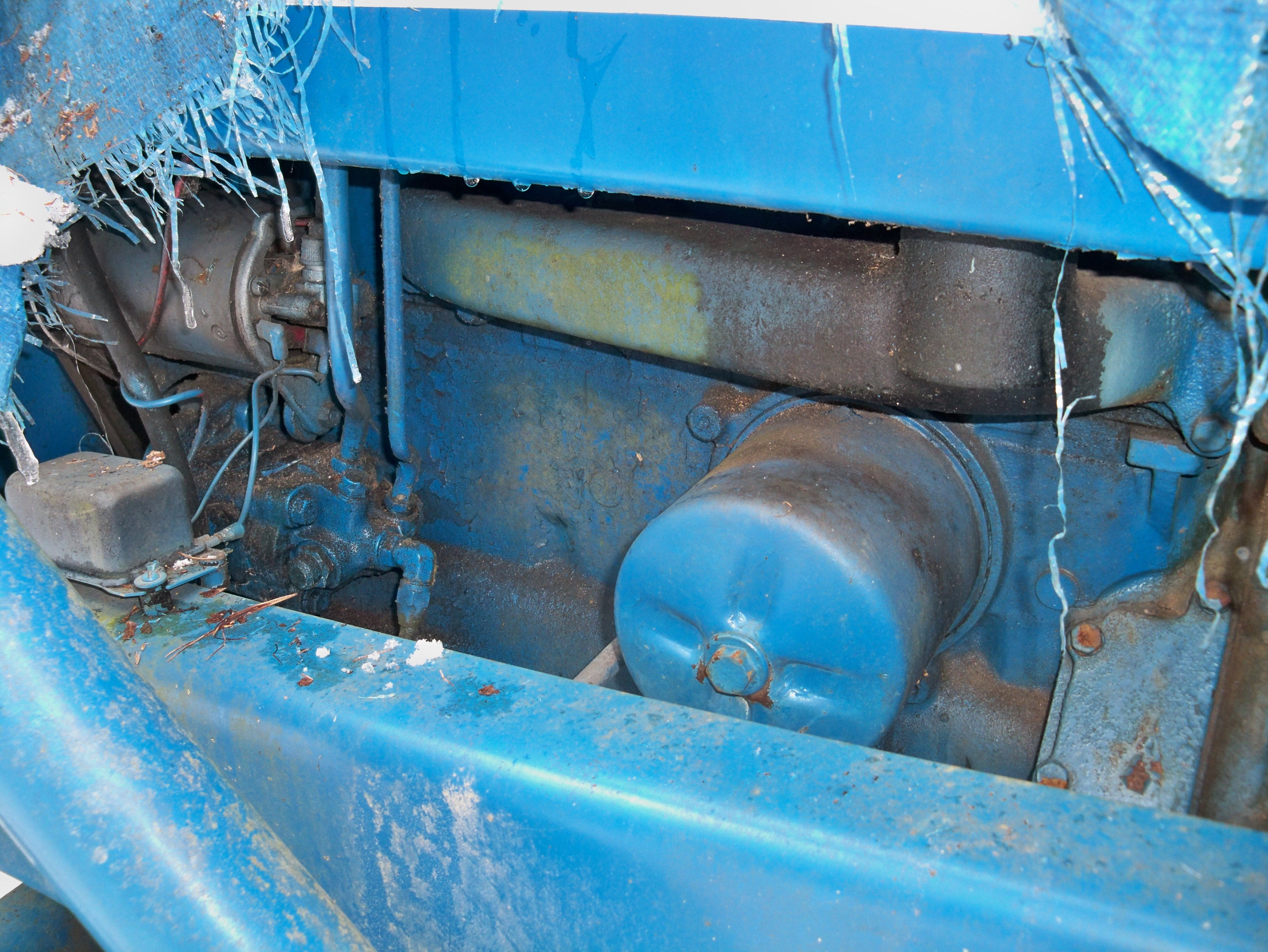

Tht's what it looks like to me. I also think the factory canister style filter implies that its a 233 also.

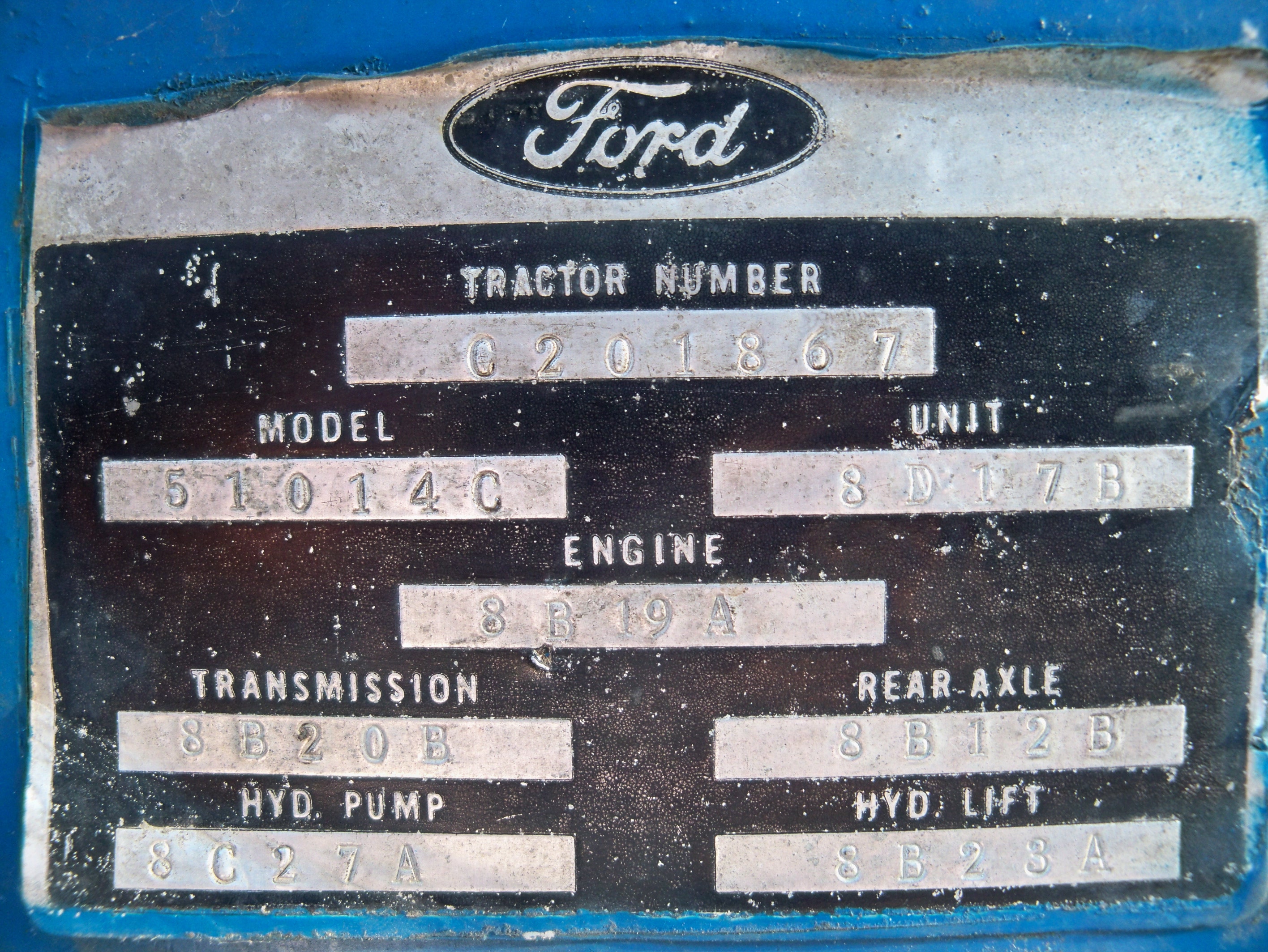

An update to this thread ... The tractor is home now. I have found some great information on this model in the meantime. I am going to try and post pics of the progress as I get it ready for work. Hard to say at this point what all it will need. This tractor seems to be a 1968 and has a 233ci diesel before mid year going to the 256ci diesel. Can anyone help on this pic of the id tag ? I have only found info on the model #.

That that tractor looks nice and the injector pump, oil filter, etc is similar to our 1966 3000 Ford.
Did the water cause the pistons to seize or will the engine turn?

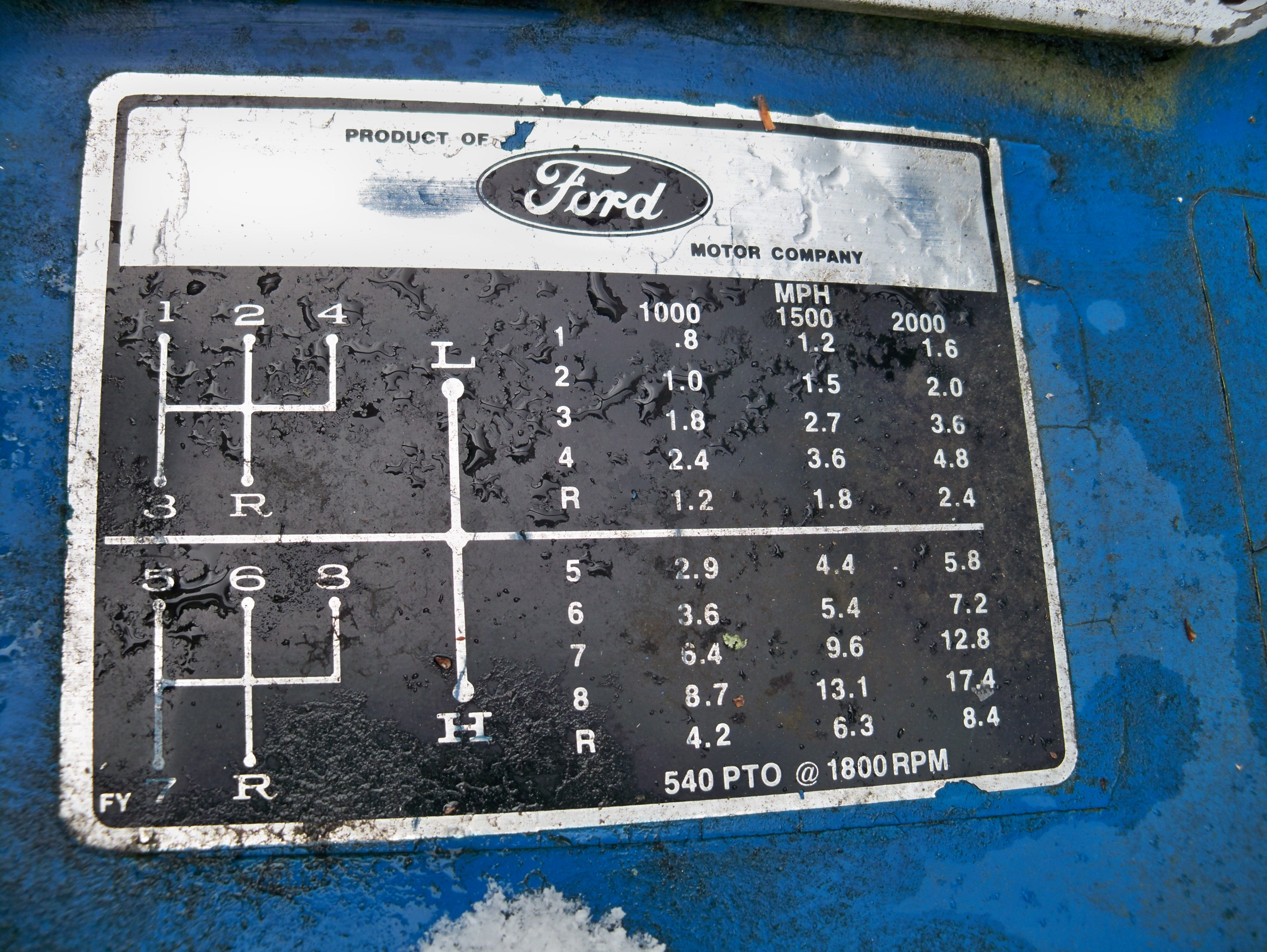

The head gasket issue has me wondering if a cavitation erosion issue could be the case. I know it was used to care for horses and clear snow. Another thought , what is considered the best transmission in this model. I have the 8 speed 2R . I know that reverse is either slow or fast with this one . The selectospeed can be expensive to fix. There was dual power. Later they added synchromesh. What is most durable and has good parts availability ?

Not sure what I would do? You might consider pulling the injectors and if coolant was getting into a cylinder or more the injector tip may show signs of it. You could add some oil with the injectors out and use the starter to bring up the oil pressure vs a long dry start.
If coolant every got in the crank case dropping the pan and replacing rod and main bearings could save the engine if the crank did not take on any damage.

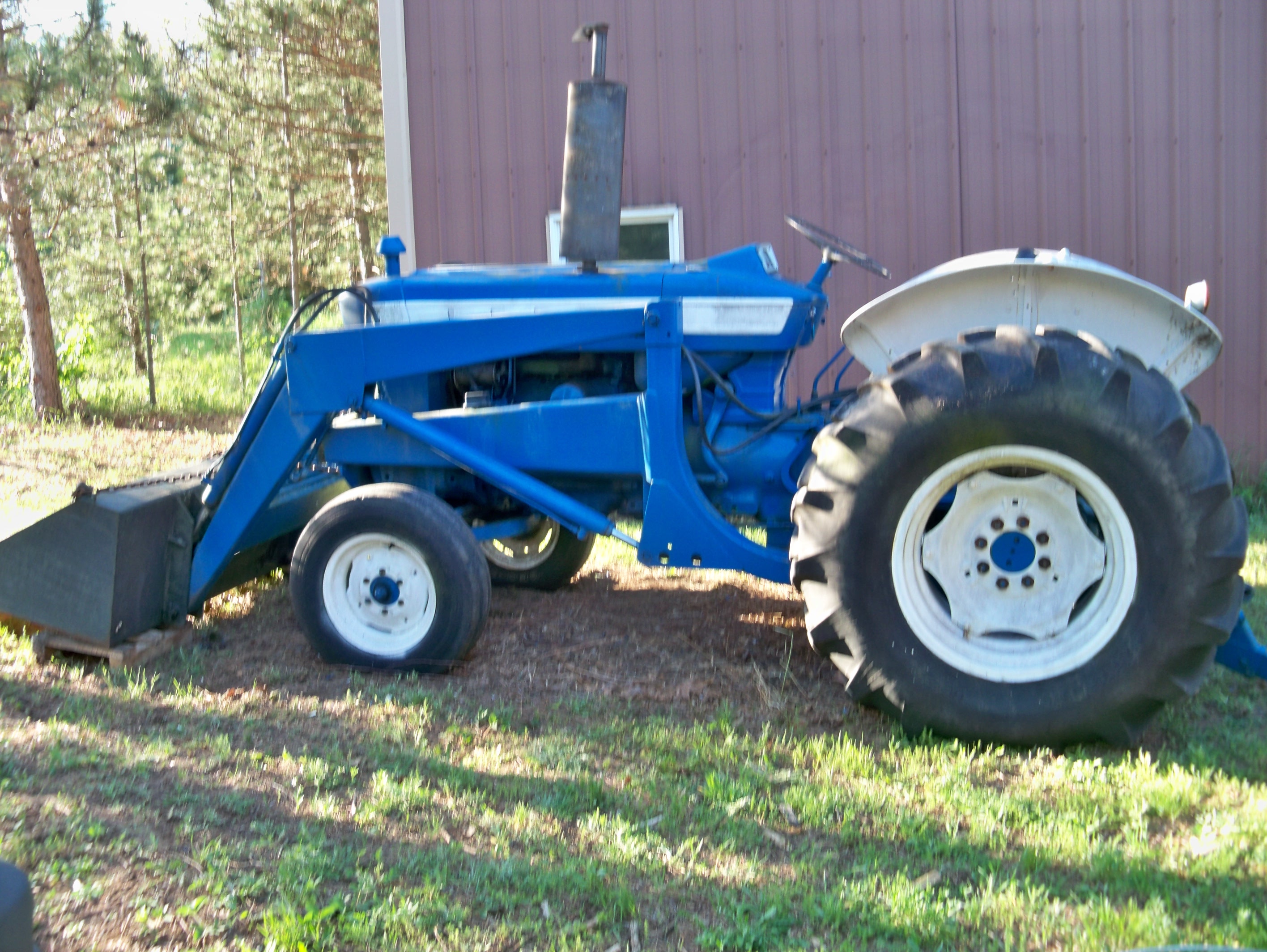

The sheet metal and rear links look like a pre 1968.That would have a 233 at 55 PTO hp.After '68 they had a 256 at 67hp and no scoops on the hood.
If it has a inline injection pump,always change the pump oil when you change the engine oil.Premature pump failure will cost you more than you will want.Use the same oil as in the engine.
