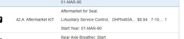

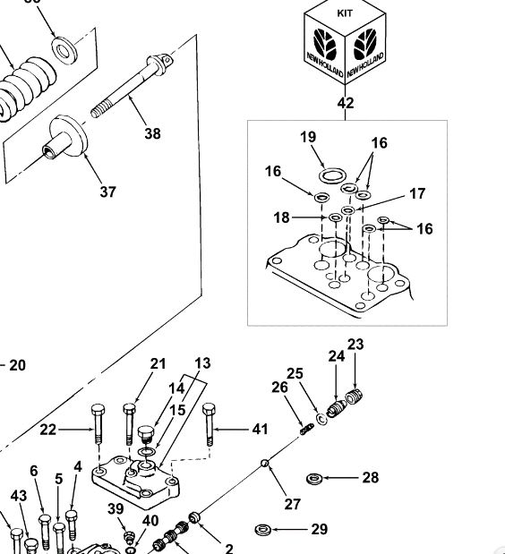

If I'm understanding(guessing) the correct place of the hyd leak Plate #13 is used when tractor has no remote valves. Are you replacing the seals(o-rings) with the correct parts(parts key #42 2nd photo)??

You already have a relief valve built into the pump. It should be set at about 2500 psi. As for the leak; a couple things come to mind. Your picture shows a power beyond block (which I assume is under the spool valve) with three ports. These blocks are supplied with only two ports as well, the two port style requiring a separate sump return of your choosing. Is yours a two or three port block? Another thing is the size of the orings under the spool valve and how good a match they are to the size of the machined spaces they fit into. One more thing is the length of the mounting bolts. When adding custom parts such as these, the bolts need to be the correct length to assure the valve bodies are tight. If one or more of the bolts is so much as one thread too long, the bolt can bottom out and feel tight but not supply the compression needed.
   / Ford 4630 Hydraulic Questions: #10
I have a 4610 and I installed a similar hydraulic manifold, different part number, to feed my FEL valve.
You need to get the installation instructions for your manifold assemby and verify that your installation is proper. The instructions for my installation cautions that I had to use a 3 port valve with power beyond. Use of a 2 port valve, which appears what you are using, would cause pressurization of the valve whenever the 3PH is used. This would lead to valve leakage and possibly valve housing failure. This may be your problem. The manifold is installed after the hyraulic pump and before the 3PH.
When I remove my FEL, I connect a hose between the pressure and return ports going to the manifold. It has worked fine for many years with no issues.
Get the installation instructions and verify your installation is correct.
