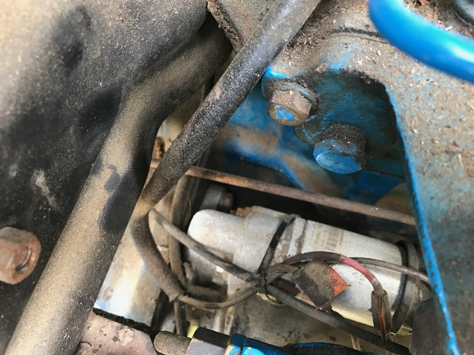

So a few tests. First I tested the starter motor. It ran good not hung up. Next I tested the solenoid, two hits with the test switch. First ok, second time it hung up. I then tested the motor again and it wanted to turn the engine. So decision made, take it off as is. That challenge was not too bad. I removed the battery n battery tray. Using a long extension, a swivel fitting, socket and a piece of coat hanger wire that buried bolt came out fairly easy. Tomorrow 2 bolts and it is out. A couple of pictures. First the access between the FEL top and bottom rails. The starter sits below and behind the fuel filter and separator which is just visible at bottom of picture. Second is the bolt visible below the metal rod. You can't get at the bolt from this direction. You have to come in from the front.

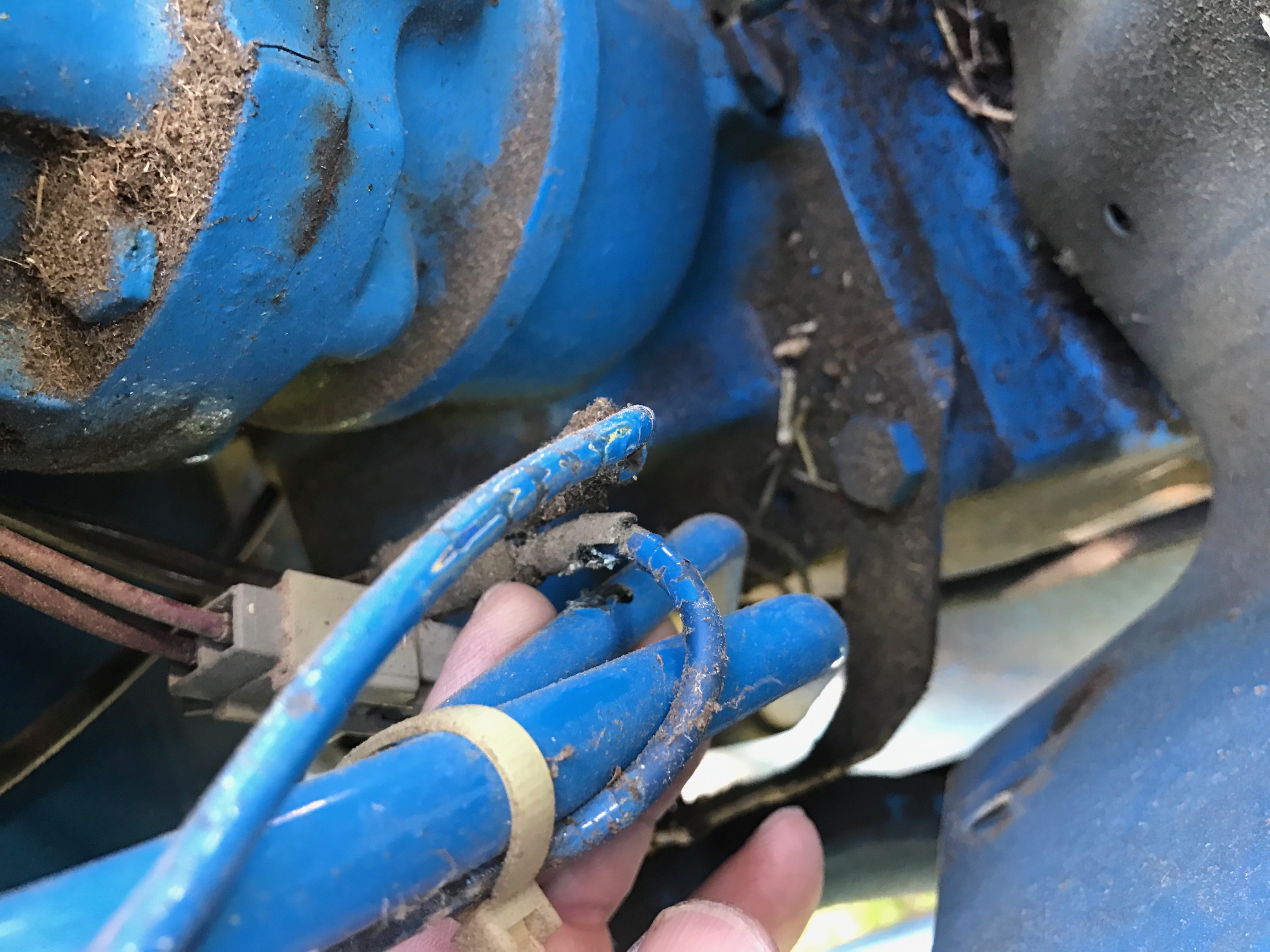

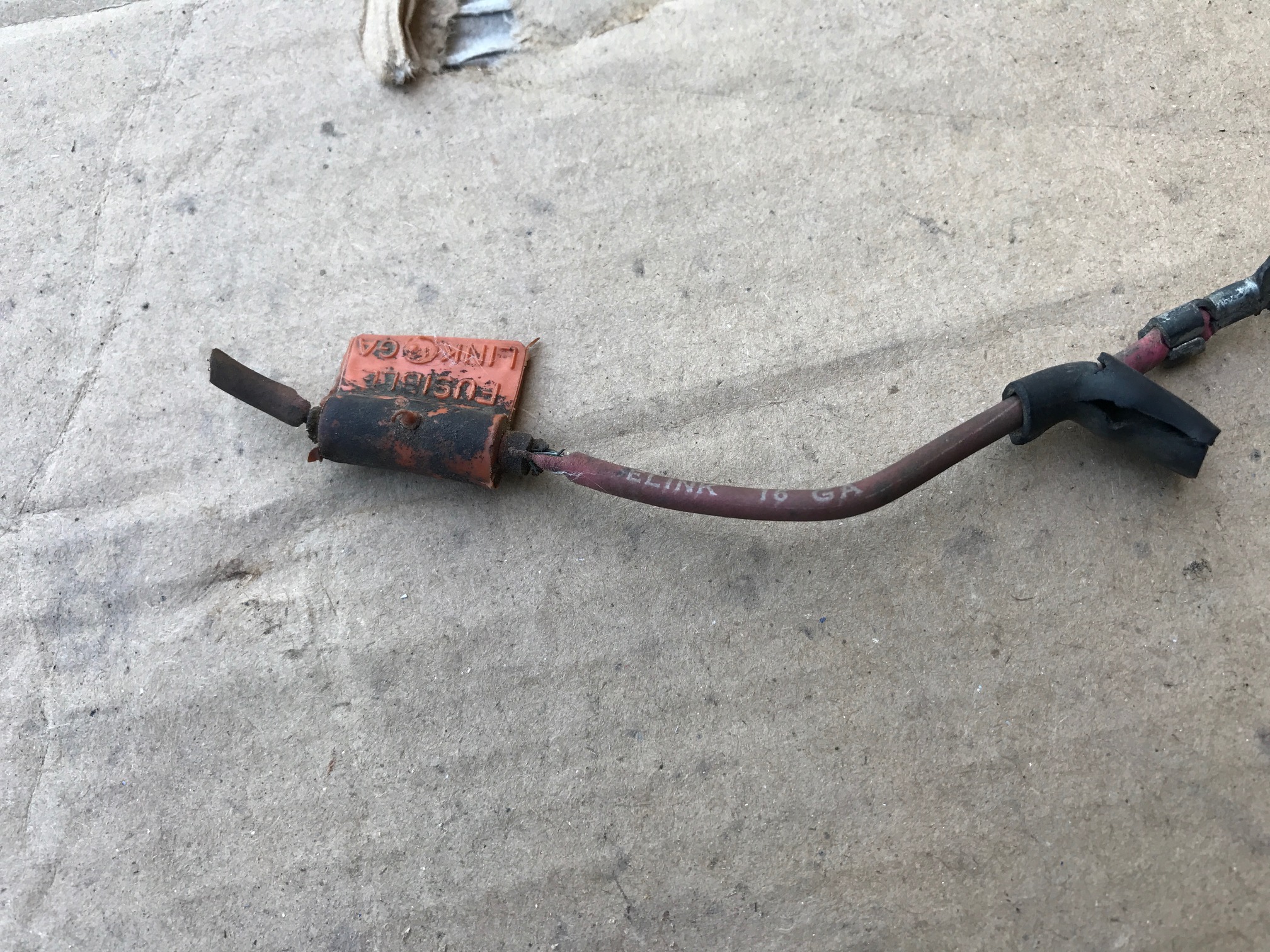

Thought I'd update this thread. I removed the starter and did a bench check of the starter. It checked out good. A check of the wiring revealed a bad fusible link. So I had the starter bench checked by a motor repair company. The starter checked out good. I checked with Ford for the fusible link and they did not know what I was talking about. It didn't show in their database. So I ordered the link with O'Reilly Auto Parts, will pick up tomorrow.
So the problem was the switch or the wiring. I had a chance to troubleshoot today after a bad storm we had yesterday. This starting system and alternator is protected only by fusible link. The links are not shown in the wiring diagram. So I started testing power wires first and then looked at the switch. The switch has 4 positions with the 4th position being the start position. Rigging my test tool I found that the solenoid trigger would power up in position 3. Aha, so the starter stayed engaged. I had to remove a panel for access to the switch. I then saw the problem. A wire, part of the neutral safety switch, had worn and was making contact with a metal tube. This provided the ground that allowed the solenoid to stay engaged. So simple fix. Tests show system is working normal now. Should have it running tomorrow.

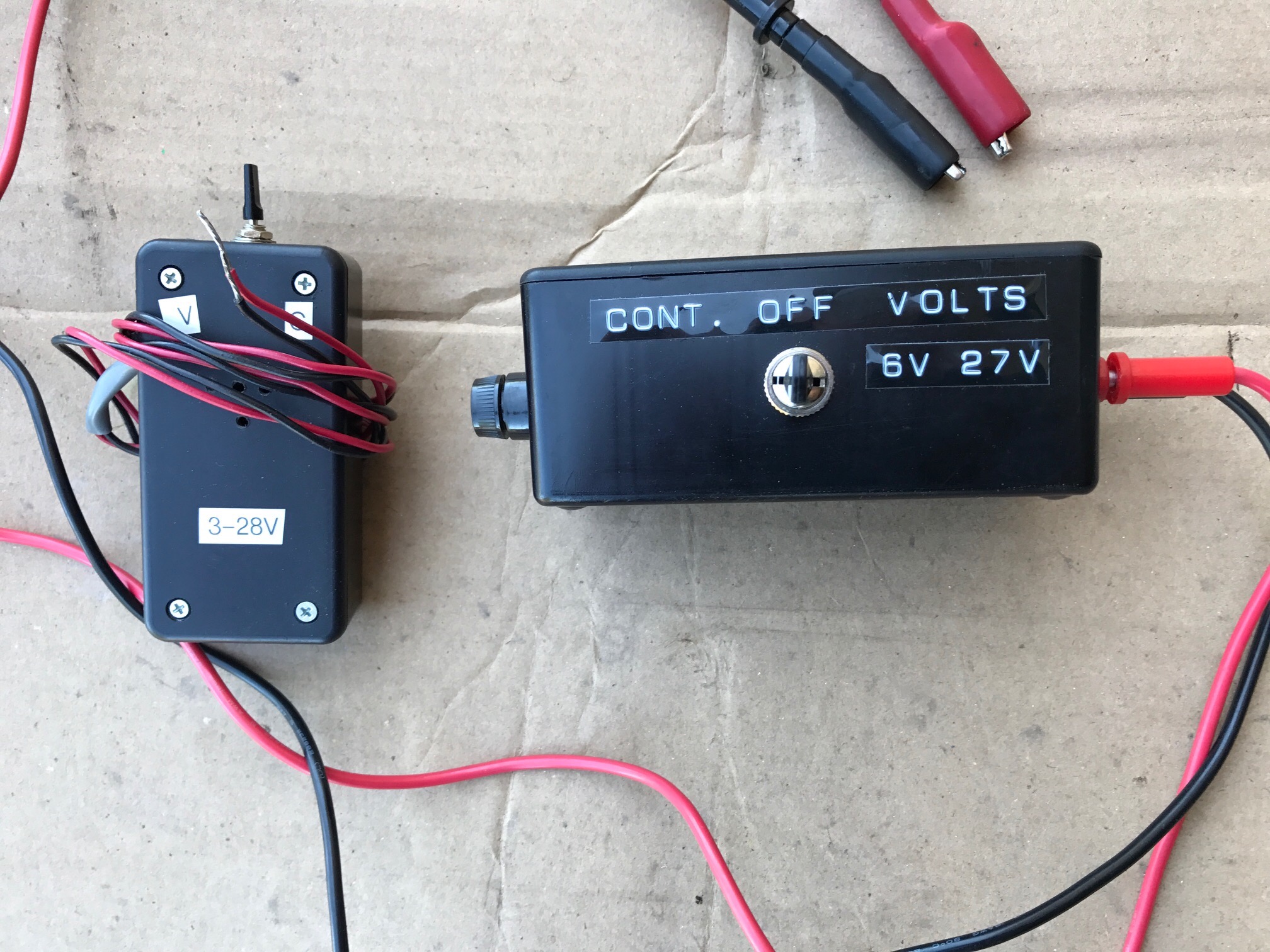

Only thing I can't figure out is why the starter stayed engaged when I turned the key to off. Will see how this fix works out. I use a neat tester that I make. It allows to test continuity, voltage and polarity. It uses a horn so I just test and listen for the horn. Works great when working solo.

Fixing the electrical fault that I pictured has fixed the problem. Tested the system many times and all is normal again. I need to study the wiring diagram to see how this happened. I still am cautious about the switch. As I use the tractor I listen and monitor the instrument panel to see if all is still good. I'm looking for a battery disconnect switch so I can deactivate the electrical system if needed. The switch may possibly be a problem but testing the system and now using the tractor has not resulted in another fault. I will just monitor it for now.

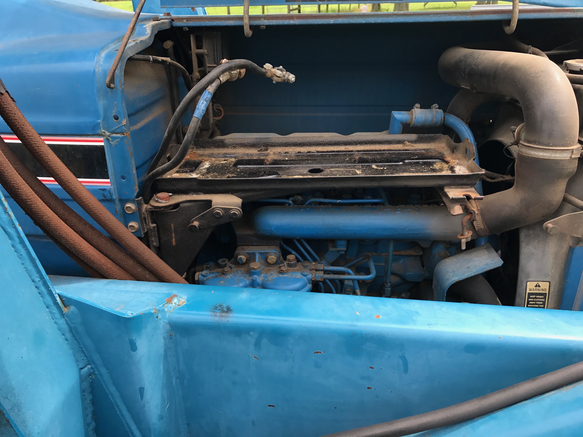

RickB I raised the loader to see what access I have to the engine. It would not work for replacing the starter. The lift cylinder is in the way plus 4 hydraulic hoses hang in front of the starter. A good suggestion just did not work for me. I took a picture with loader raised to have as a future reference.

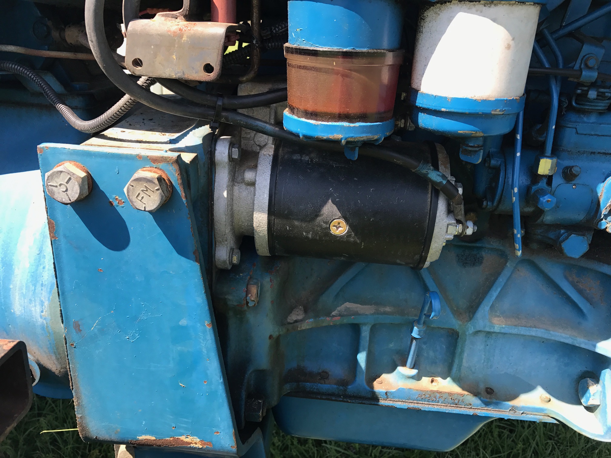

Here is the access you have to the stater once the FEL is removed. Much better working space.
