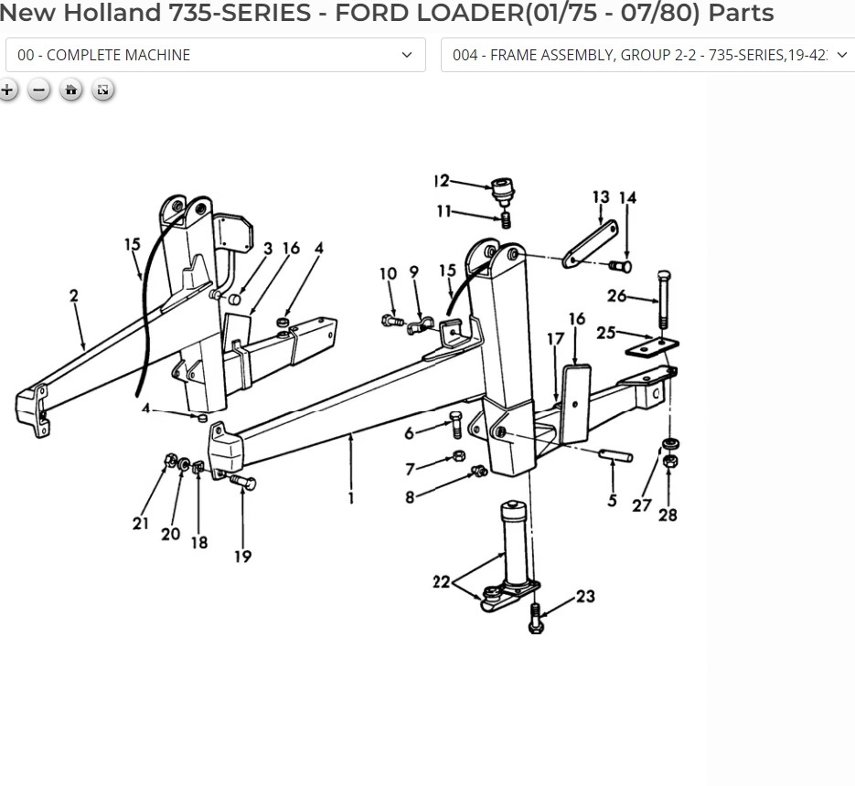

A+ !! Thanks for the link, I am currently looking to replace the Hydraulic filter that is located in the loader arm.... Not having much luck. A piece of trash got through and my loader bucket will not uncurl. loader lift and drop works great - pretty sure there is trash in the control valve due to a shoddy filter...

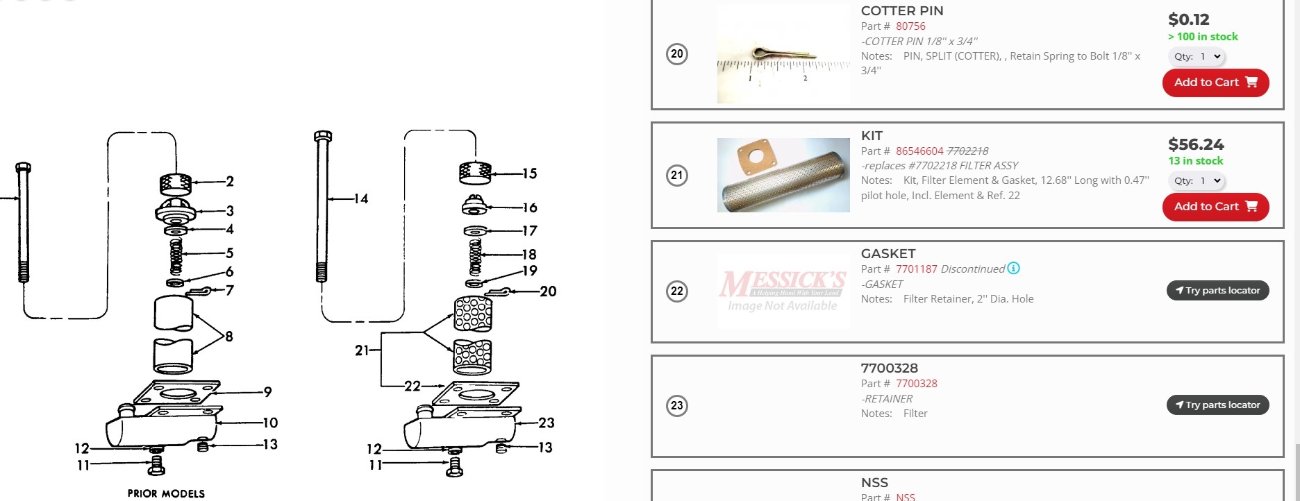

Looks like you have a 735 Loader on your tractor. Is your filter like this in the pictures?
It was not like this, it was the 'paper' type... I measured and have tried several of the filters that are depicted in the attachment on your post.
I am attempting this one I purchased from amazon (has yet to arrive)
WIX MN-S45E40T Direct Interchange for WIX-S45E40T, Stainless Steel​
I looked up the part number and the specifications seem to work; 9" long and right diameter
"The model you posted is - correct" and the illustrated parts breakdown is accurate.
If this works - I will let you guys know! Thanks for your input!
