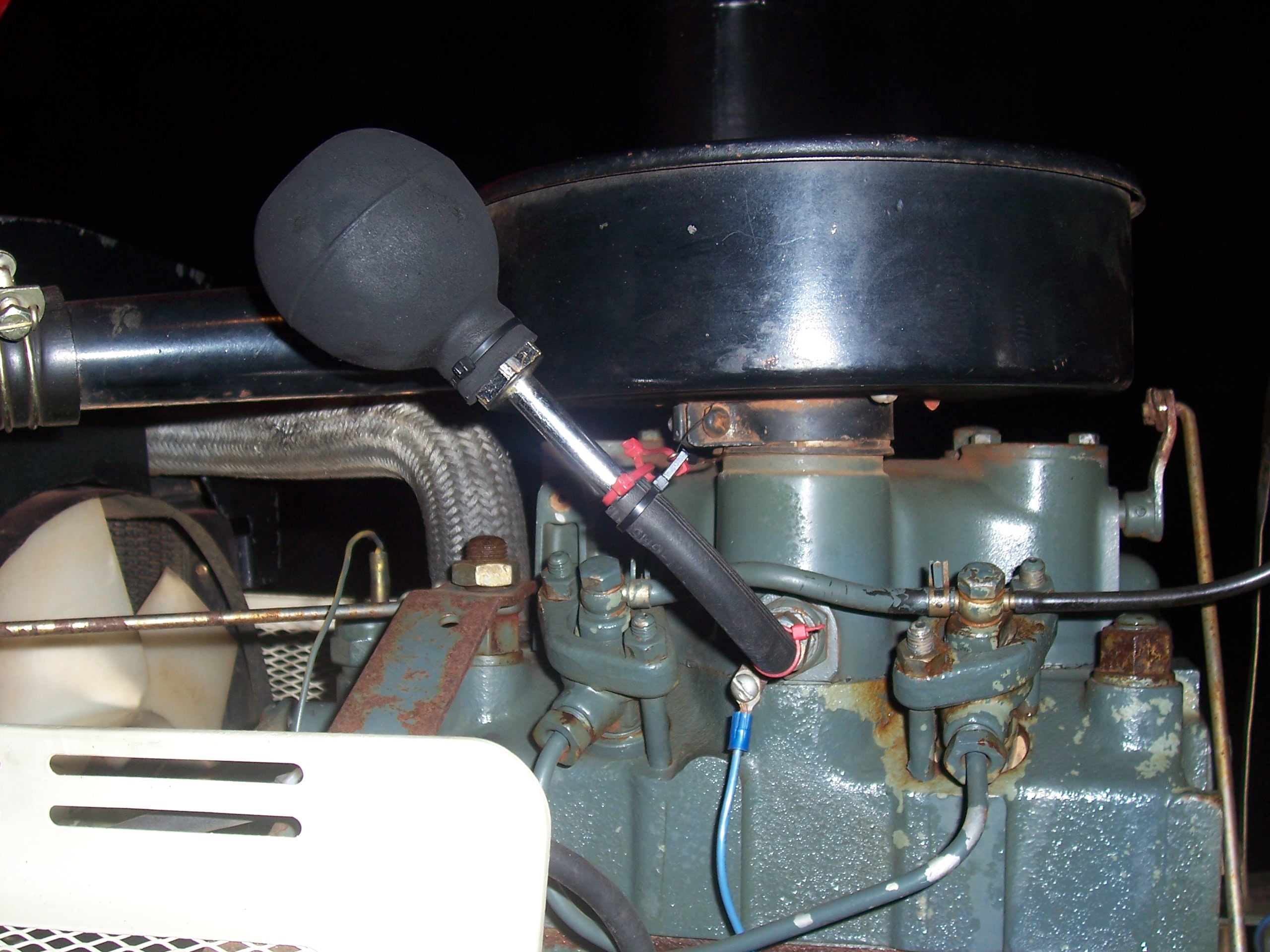

In Ga.the Winter Temps. are in the 30's at night. I use a Diesel Yanmar. 15+Yrs.. 77 2Cyl. so it's far from new. I've only had to use a starting aid a couple times. Never going to use the Ether Unless I have no choice knowing what the risk is. What it uses is a Thermal Start. Heating Element that drips Diesel fuel on an Elec. Igniter in the Air Intake. The warm air helps the combustion. I've heard of other ways Block Heater. Even using a Hair Dryer. So may want to look into all the options. Or a few being in Alaska.
The Yanmar only gets used in grass cutting weather so it's not a problem. I'm working on a NTM Ford 2000. Gas. With a FEL on it. I plan to use it mostly in the winter clearing my wooded land. Doing good so far But Reverse has Quit.
"Again" SMDH... Pitiful how it happened!... I know how it happened for sure this time. I Did it. View attachment 811330 Inside the Air cleaner.
My quick setup for when I have to use it.

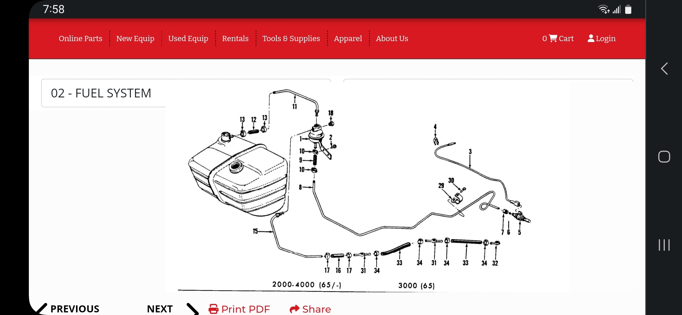

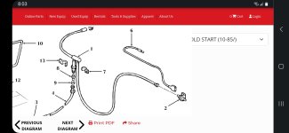

Thanks my temperature is about the same in the Pacific Northwest sometimes it gets in the teens. I want to install the thermastart. I’ve ordered a five position key start for that purpose and there’s a lot of drawings on the thermastart application but none of them show me exactly where to put the thermal start element, do you know thanks again

The Blk rubber ball is how I fill it with Diesel. Only need a very small drop or two. Twelve Volts to the Ignition switch. Which you turn my key backwards and hold it to get power to it. When it gets hot 5-10 Secounds it fires up the dripping Diesel. Major Heat!!! This is it and were you can buy one. They have a few setups with it.

Interesting, simple kit! Nice to know
   / Ford 4500 wont start with ether #24
They've done it for Decades. It does help a lot! Why I set it up If I had to use it. The Glow plug was on it I wired and made a way to get fuel to it. And sure enough!;)
If it is like the 3000 and 550 and other Fords I have seen it goes into the intake manifold there should be a bung in the casting look closely on the 550 it is near the front side facing the water pump.

Would love to know how to install a thermostart on my 4500 it was an option I don’t have. I have all the manuals nothing shows how to add. Can you hook me up to link or drawing. Thanks
Make sure you don't have one. They are small.
