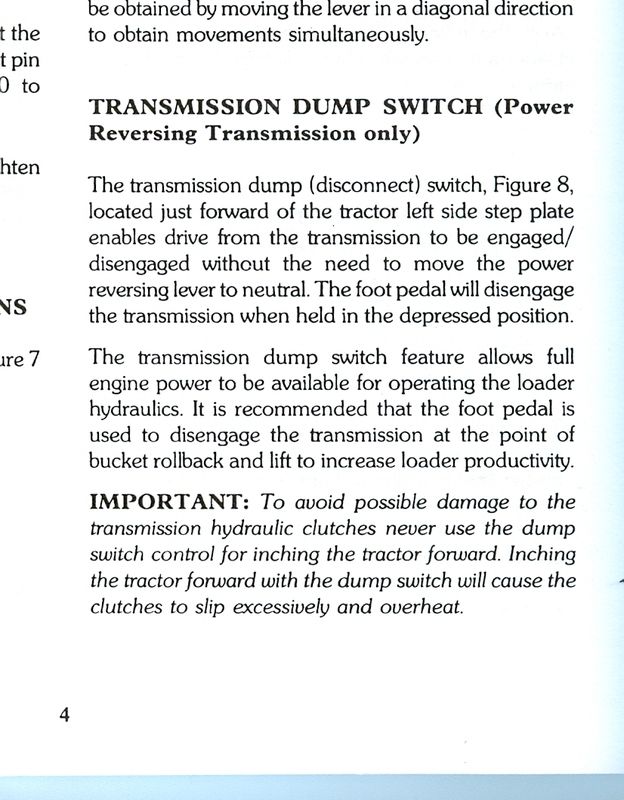

Thanks for the response. It's 2WD. I checked all the lever linkages and foot pedals and they all seemed surprisingly tight and smooth. Will check the things you mentioned. I noticed it has what looks like a shuttle shifter on it with no clutch. It has a little round pedal (switch?) where the clutch is on standard tractors. What's with the little round switch?

The transmission is a torque converter power shuttle 4 forward, 4 reverse speed. The pedal is a clutch switch. The transmission is synchronized in 3 and 4th gear.

Very nice tractor! That's the 14' hoe that's also on the 545a,555a, &555b. A very nice, very heavy duty unit! As for the front weights, the side ones are 210 lbs each, if there's one under the front between these it's another 500lbs. DO NOT REMOVE THEM! they counter balance the heavy hoe against the lighter straddle mount tractors (345,445,545's)
As for your foot button, this is out of my 345C manual, but same idea -
   / Ford 445A #8
If you are wondering "why do I need this", because the brakes will not stop the machine and, you have no clutch pedal.

Great information. Thank you all. The "dump switch" makes sense now and it's nice to know how not to use it. I have a few other pictures and it does show the center weight on the front. Few more questions:
