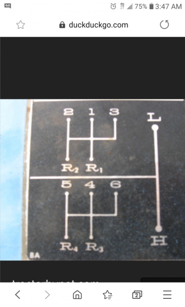

Well, I'll own up to being wrong. I have never seen a 4x4 manual reversing transmission in a 3 cyl Ford, and I'm at a complete loss as to why my original Ford service manual from 1968 does not list the 4x4 or a G transmission code, or any parts catalogs give it any mention. But if Tony Jacobs says they are out there (and common in New England?) that's good enough for me. Sorry for any confusion or frustration I may have introduced in this thread.
I've heard of a 4x4 manual reverser, never saw one. All my notes skip the G designation and they don't list the 7 speed either.
   / Ford 4400 tranny #12
no confisusion of anymore frustration than there already is.
I was actually thinking along the same lines as you when it comes to posibally being a combination of more than one tranny.
But if it had not been for this thread, I would have never foung anything else out about it.
It is puzzling though about there being no reference to trans code G anywhere in your 1968 manual.
As I mentioned, we also have an older manual that came with the 4500. I think it covers the 3400,3500,4400,and 4500. And a previous owner had highlighted and crossed off different sections in the manual. And it was puzzling that the 6x4 tranny was highlighted:confused2: And in that manual, their was also no mention whatsoever of a 4x4 manual reverser either. Just the power reverser.:confused2:
   / Ford 4400 tranny #13
I have a 1971ish 4400 with the 4f4r pattern described here.
So don't think it's a special arrangement.
   / Ford 4400 tranny #14
I have the same on a 1967 Ford 4110 LCG. My tractor originally had a SOS trans but someone swapped it out over the years.
