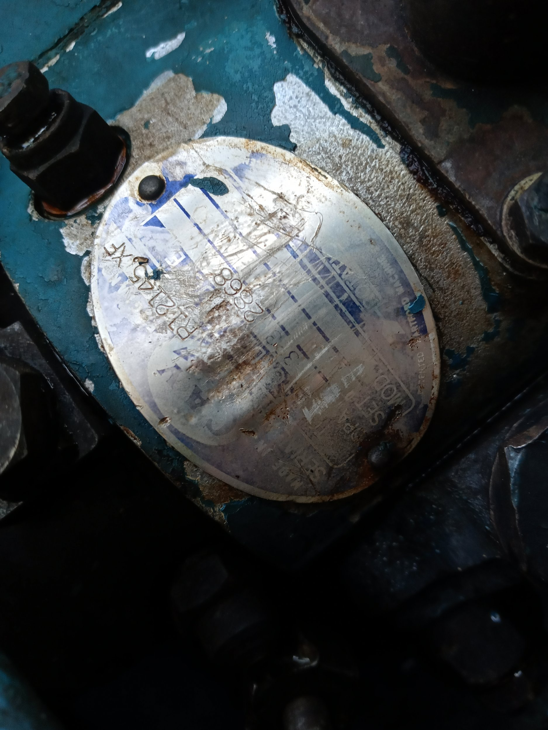

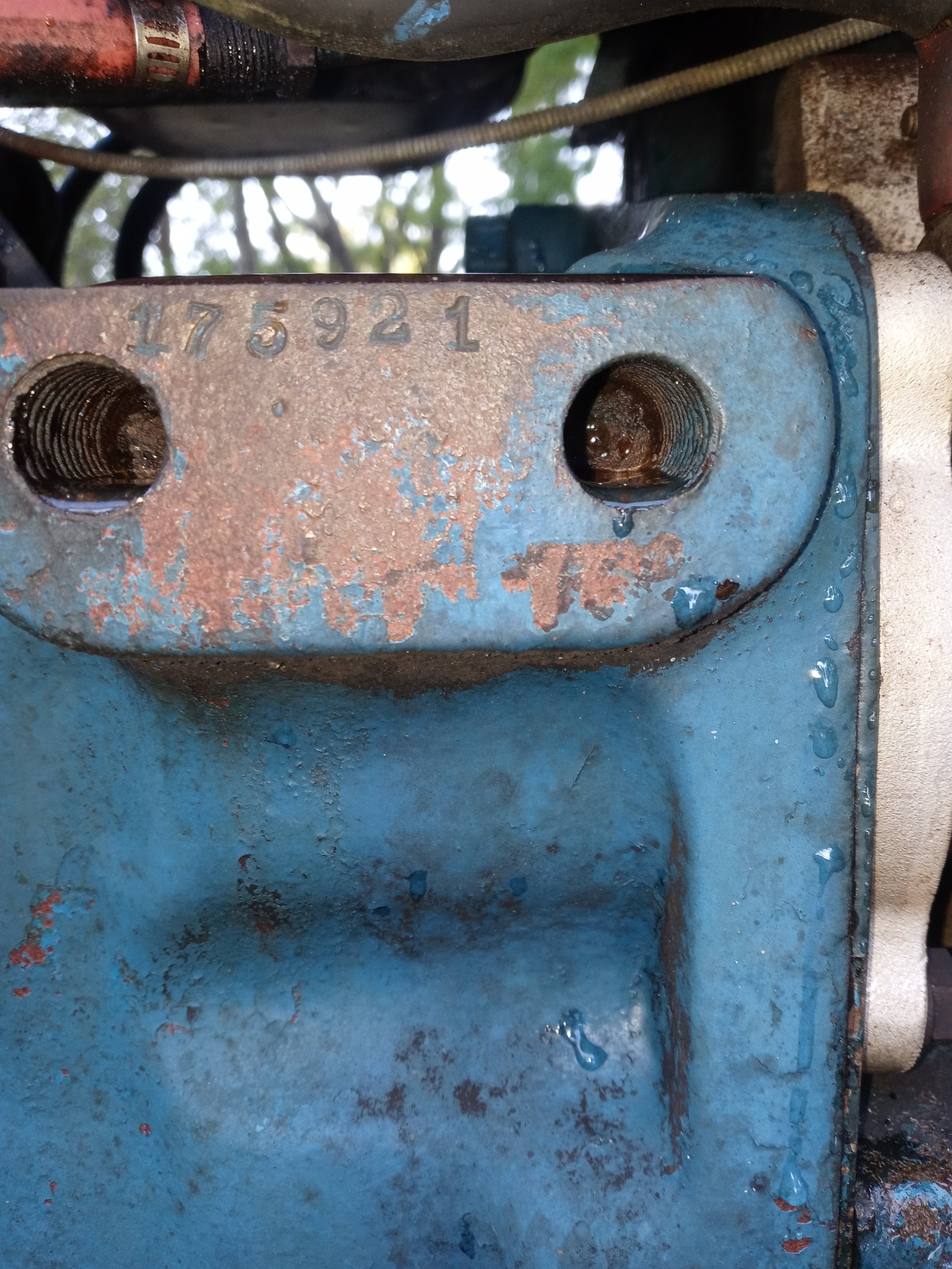

I need help identifying my ford 4000 so i can get a proper injection pump or rebuild kit and the throttle linkage on top of the pump

Numbers are located on the right side, toward the back, just behind the starter. They are located on top of a lug on the flywheel housing.
Numbers are as they appear closes to the engine to the outside.

Is the pump not working or is it leaking? I do not see much info for a 323 2868 pump. There is a member here scpumpguy you should PM him and let him know about the thread. He is a wealth of knowledge.
   / Ford 4000
Not working at all and missing parts on top of the pump
