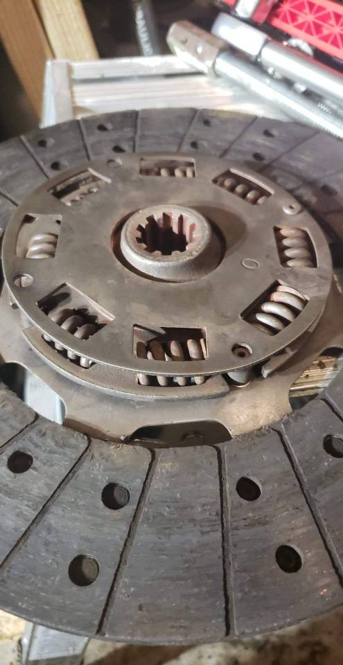

May 2, 2020 / Ford 4000 clutch orientation #1 F fibrostic Member Joined Feb 17, 2011 Messages 36 I took the clutch off my '71 3cyl gas ford 4000 and like always forget how it was installed. Do the springs go towards the flywheel or toward the pressure plate? Im getting a new one as mine has seen better days
May 2, 2020 / Ford 4000 clutch orientation #2 DLTTrekkers Veteran Member Joined May 12, 2014 Messages 1,568 Location Paarl South Africa Fit it to the flywheel and check it it toughes the bolts ?

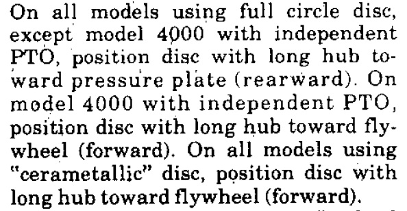

May 2, 2020 / Ford 4000 clutch orientation #3 HakanTh Bronze Member Joined Dec 1, 2010 Messages 95 Location Sweden Tractor 1969 Ford 4000 See screenshot from Shop Manual. Attachments clutch_disk.jpg 96.4 KB · Views: 177
