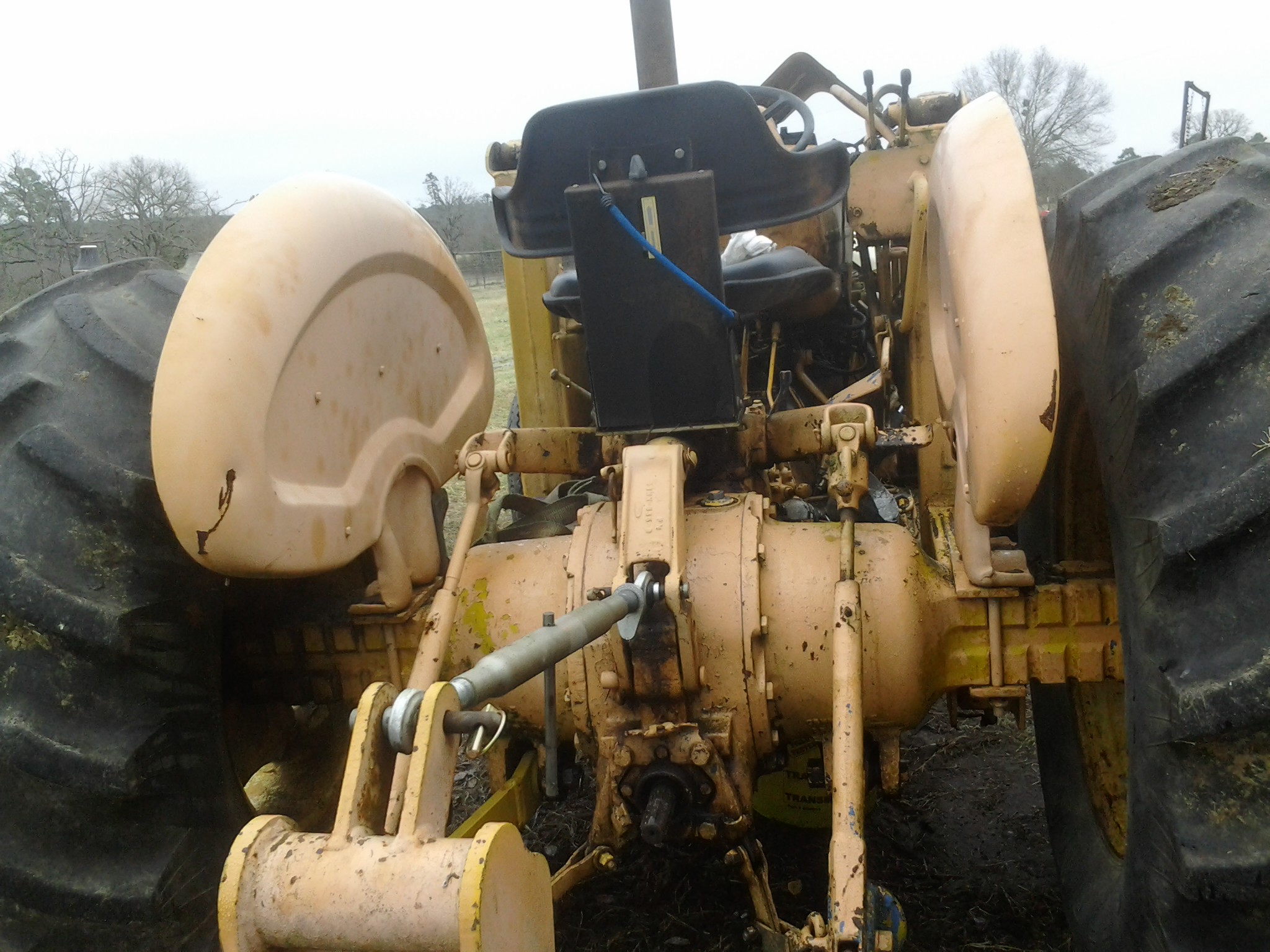

We had fluid coming out of steering wheel and rebuilt as in thread I previously found
Now, I have no steering, maybe quarter turn and push back.
Did we put something together wrong or is it power steering pump?
Thanks

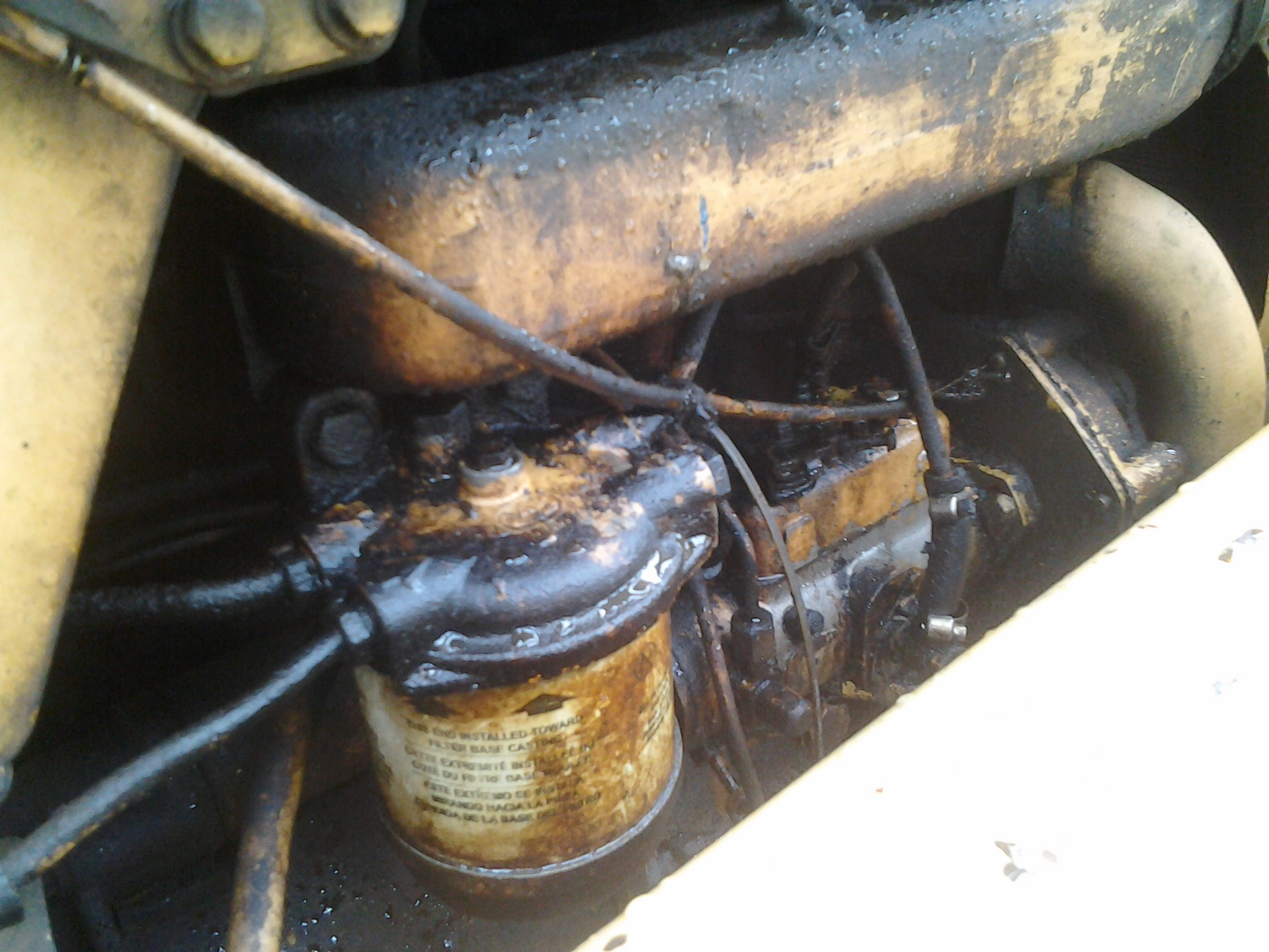

Power steering lines were crossed.
I posted some pics I hope
I was told today that it may be a Ford 4400 Industrial instead of a Ford 4000
I am waiting for it to warm up and connect water hoses and try to find serial and unit numbers
Any info appreciated Thanks

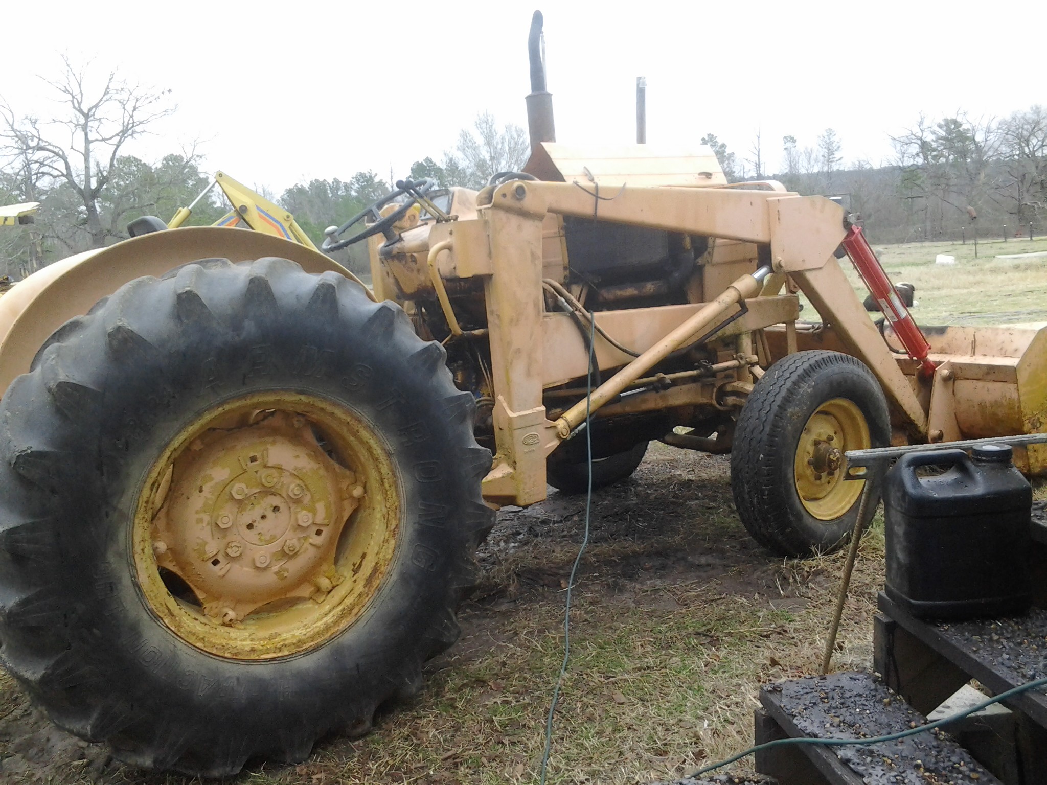

   / Ford 4000 3 cyl diesel NO STEERING #5
Hmm, It has the big rearend with wet brakes like my 4500 but it has the little light duty front axle instead of the fabricated box beam front axle like mine....
   / Ford 4000 3 cyl diesel NO STEERING #6
post pics of the front axle..
does it use radius rods?

ford used radius rods on light duty front ends at least into the late 70's. then you had the light and hd inustrials with fixed axles. and then the common telescoping axles like you normally find on the 4000+ 3/4 cyl jobs
   / Ford 4000 3 cyl diesel NO STEERING #9
In his first and second pics you can see the radius rods
   / Ford 4000 3 cyl diesel NO STEERING #10
maybee on something with a real screen but not my phone! :)
if it has rad rods and a fixed axle, then yeah.. likely a 4400 / industrial
numbers on bellhousing and under hood would narrow that down
