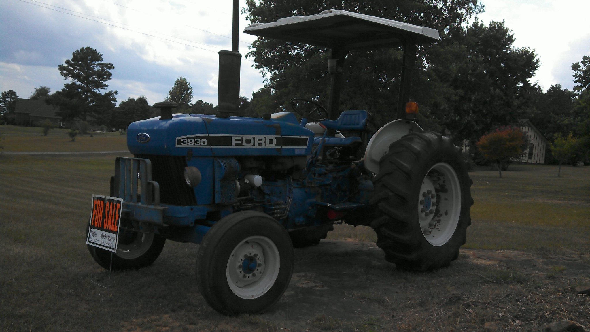

Can you tell if this tractor has the optional pump? I see hard lines running from the top rear of the left side of engine
/ Ford 3930 shuttle trans #6
It does not. The second pump would mount in place of the steel plate visible to the rear of the engine oil filter.

Just so happens that i was within about 60 miles of the 3930 today, so I called the owner to ask for a look. He pretty well described it, the tires look worse than the pictures show, but he warned me about that. I did immediately notice a whine in the transmission, pretty loud. Doesn't do it in neutral, but does in all forward/reverse gears. The tone seems the same no matter what the gear. It shifts fine, f/r works smooth with no noises. He said his Dad bought the tractor in '96 and it was making the noise then and hasn't changed. Doesn't seem normal to me, what do you all with experience with the shuttle think? This is the shuttle with the stick mounted directly to the top left of the transmission.
Even if the noise is harmless it would probably make the tractor hard to sell should I want to. It might be why he hasn't been able to unload it.
