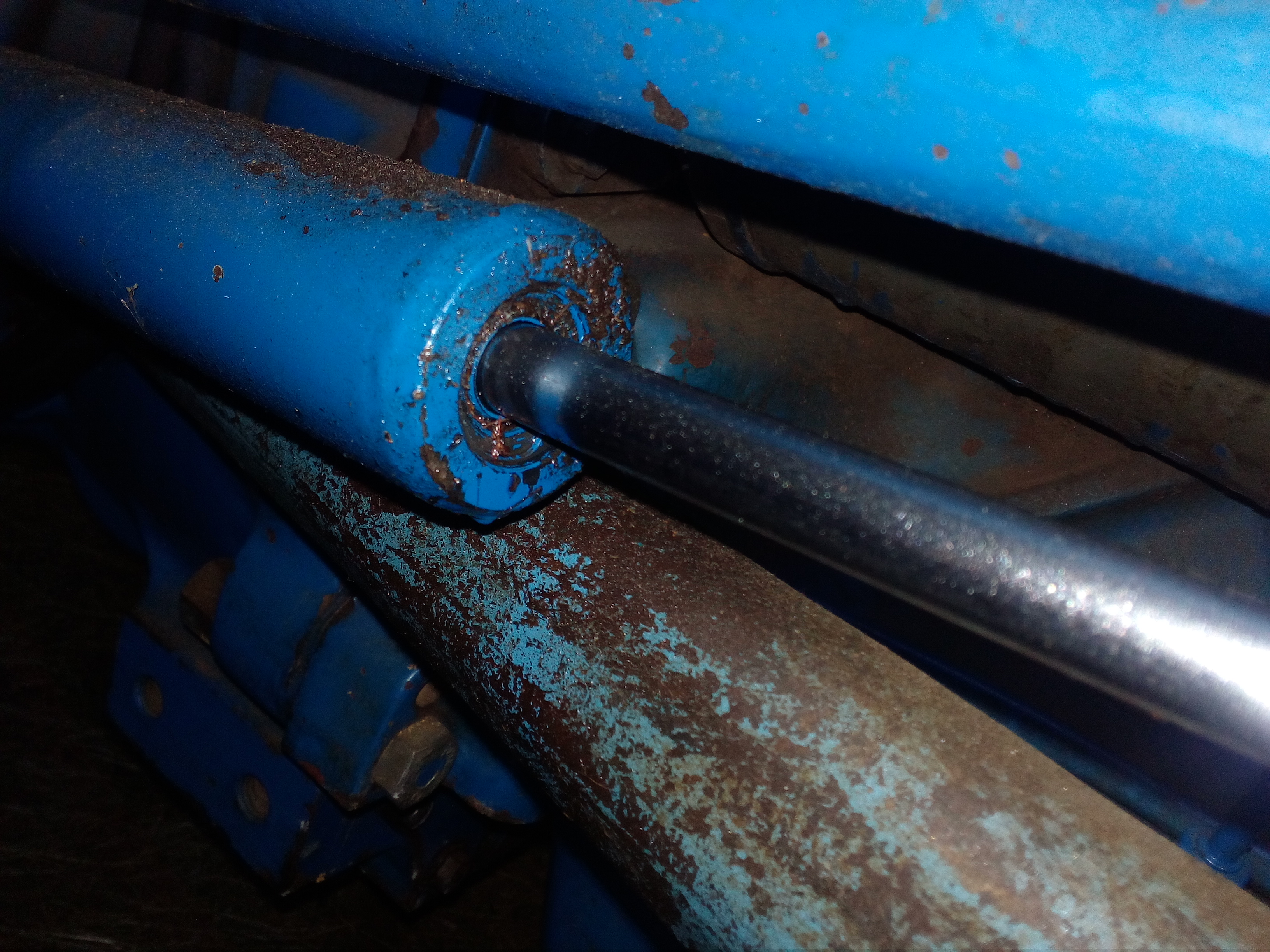

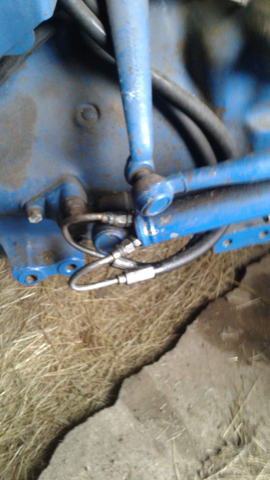

Hello all,
I need your help with my Ford 3910, the hydraulic from steering is leaking oil, see images in attached.
Can anyone help me figure how to disassemble it to change the sealants?

You can get a seal kit for that cylinder from a New holland dealar, it is a seal, a snap ring and maybe an O ring (I don't remember). That is as far as the cylinder is serviceable.

Hello,
I know about the repair kit, my doubt is how to change it.
Is it enough to take out the retainer clip and the seals come out through the front of the cylinder?
   / Ford 3910 Steering Hydraulic leaking oil #4
Yes the seals come out through the front of the cylinder (front being closest to the front axle). A pick helps to dig the inner piece out, it isn't a hard task but can be a booger to get the new one in, just take your time finessing it and it will go right in.

Hello all,
I´ve checked the sealer and it´s damaged, but i cannot find a equal one here in Portugal, can you advise me a store online where I can buy it?
