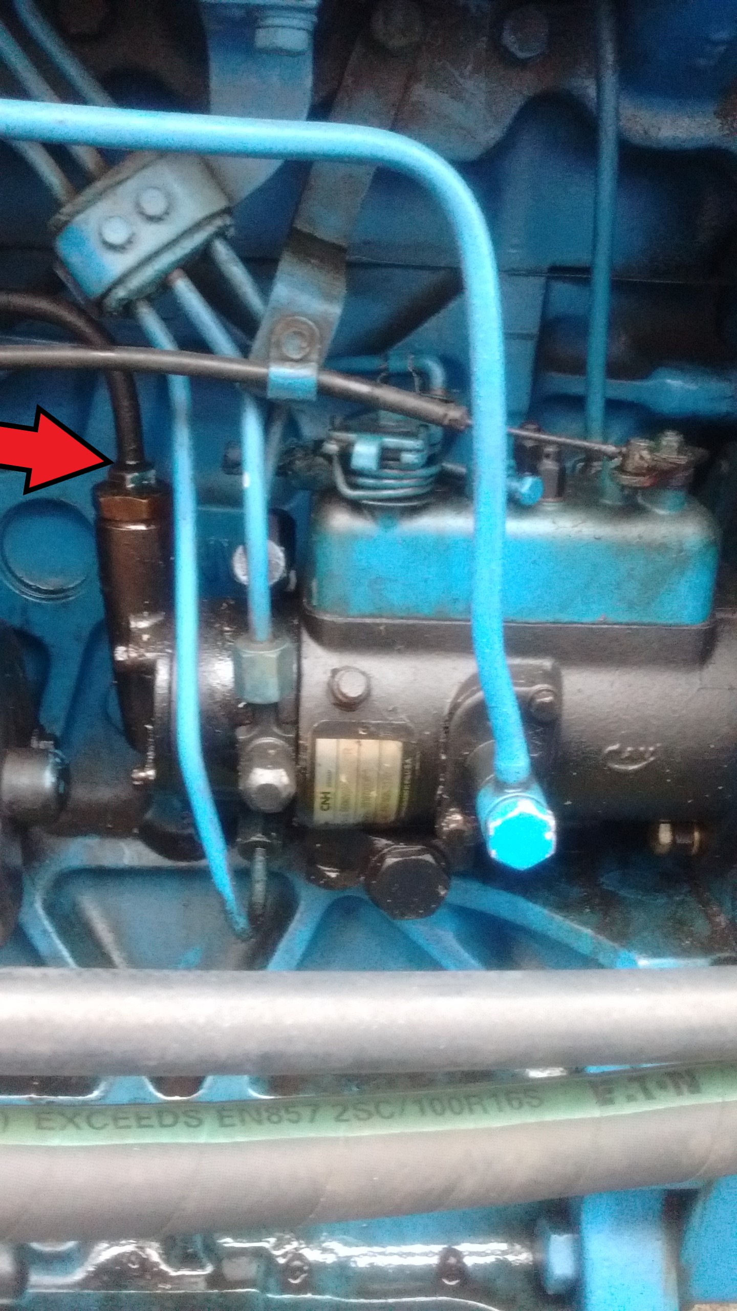

My tractor start leaking fuel badly at one of the injector connections. I know next to nothing about injector pumps and was hoping someone could tell me if this is a simple fix.
This photo is the overall setup with injector and filter Injector Pump & Filter.jpg

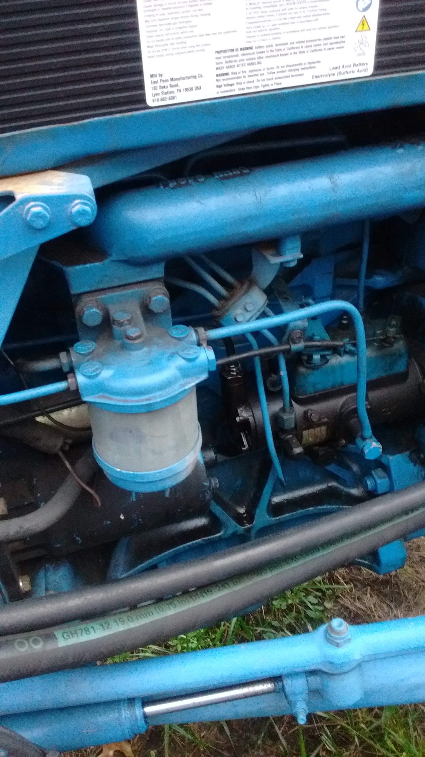

It started leaking at this point where a plastic line/pipe goes in. I tried tightening the top nut thinking it was just loose, but didn't do any good and the plastic line will pull right out...no flange on the bottom of it. Injector Pump Detail.jpg

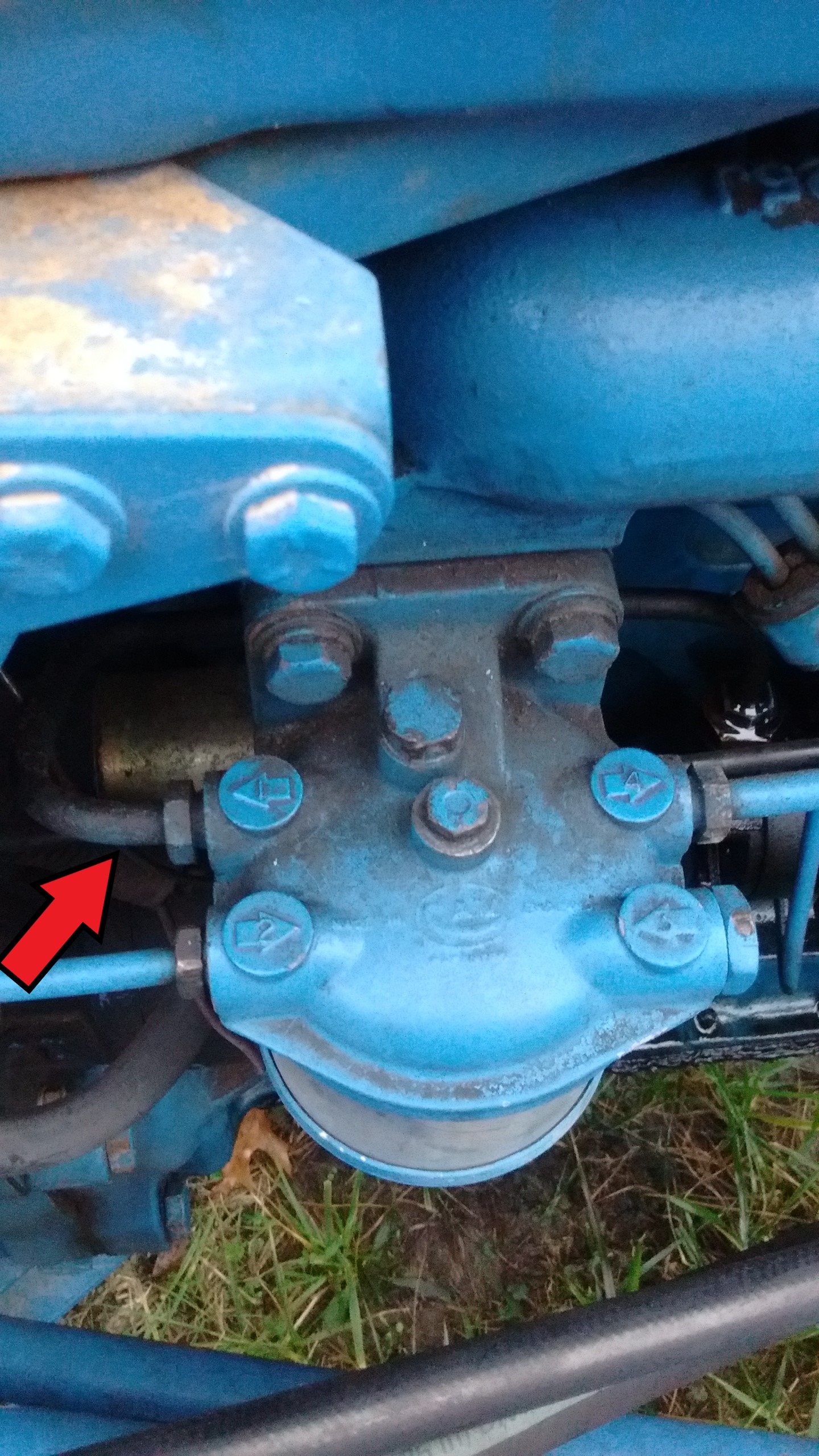

This is where the other end of the plastic pipe connects to the filter Fuel Filter.jpg

I am not an expert on these injection pump lines, but i think the line you are referring to is a low pressure return line that may be cracked in the connection, and should be available through a Ford New Holland dealer.
/ Ford 3910 Injector Pump Leak #3
THAT is the fuel INLET line & it SHOULD HAVE a brass ferrule on the end of it.. the nut tightens up on the ferrule & seals at the bottom of the inlet nut..
Look closely inside the PUMP inlet, you'll see it..if its still there..
You'll prob. have to dig it out w/ a scribe..
Once u find it, see if u can put it back on the line.. IF YES, just push down on the line when your tightening it up..
U might have to cut the line some, to get a good clean sealing surface again..
They sell ferrules at Home Depot or Slowes.. .15 & your back in business.. Good luck.

That is really good news! Thank you for taking the time to explain the details. I was afraid to touch the injector pump without knowing what I was doing. All other info I could find on it just indicated working on pumps was tedious and EXPENSIVE if you messed it up. Much appreciated!

Basic "compression" fitting. Usually the ring crimps once, works, and locks onto the line. Since the ferrule came off, check the hose at the end, where the ferrule should be and see if it's kinked...from the ferrule being properly pressed into the hose. If not, just do as pumpguy said and put the nut on the tube, slide the ferrule carefully back up the hose to the bend, or up ½" for a number then ensuring that male and female parts of the interface are clean, as he said, push the hose all the way down till it stops, holding it there, grasp the nut and bring it down on the threads and tighten it up forcing the ferrule to cut into the hose and hold pressure.
On torque, I pull it down good and snug and then pull on the hose to ensure it's seated. Too much torque and the ferrule can cut through the hose which you don't want, or not seat properly......not enough and the pipe will leak/come out.....like it did. Expect a sharp resistance while tightening for your time to stop turning.
If the like is kinked where it once rode, get the new ferrule and cut the pipe off just enough to have smooth pipe for seating the new ferrule.
