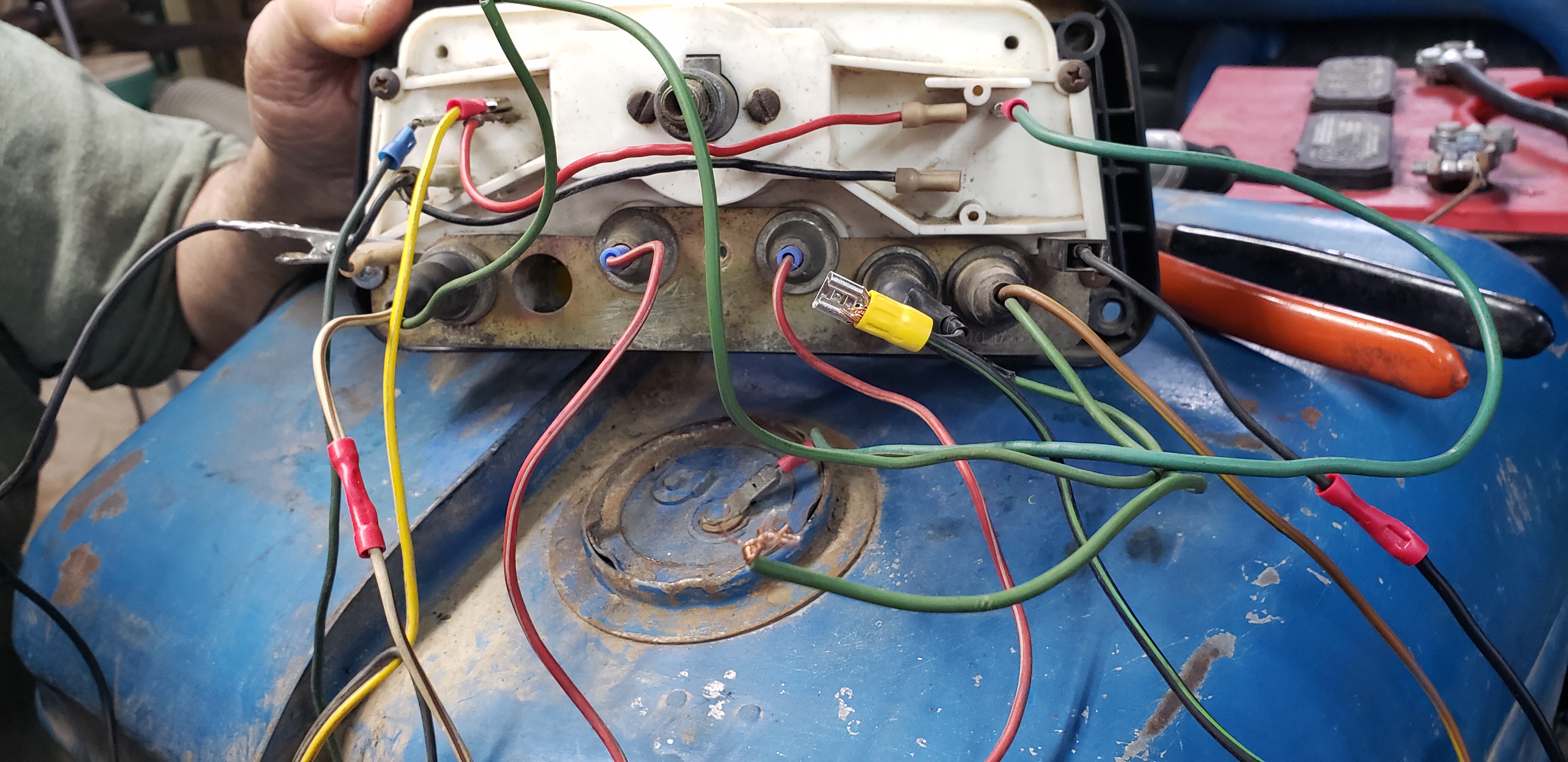

I have a green wire coming off each one of my idiot lights. Well there are 2 wires coming off each one but a single green off each one as well. And one has green/blk wire. Where do the green wires go to? And where does the green/blk wire go? This is a wiring nightmare! I will attach a picture if it let's me. Also NO WIRE DIAGRAM MATCHES AT ALL!!

I'm an electronic tech, but post is confusing. Not sure...are you trying to install an instrument cluster?
You could shine a flashlight in each hole to see what it says...what it's for.
One wire lights would have to have a ground where it plugs in.

Its not worth the time and effort running single replacement wires. Spend $50 on a new harness and be done with it.

Sorry, I am trying to get the cluster working again. A previous owner cut wires, rewired things together, etc... I know what the lights are for, just not sure where to connect the green wires. Do they all go together?

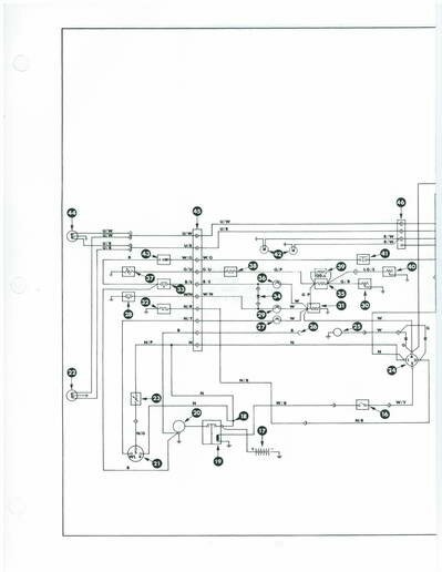

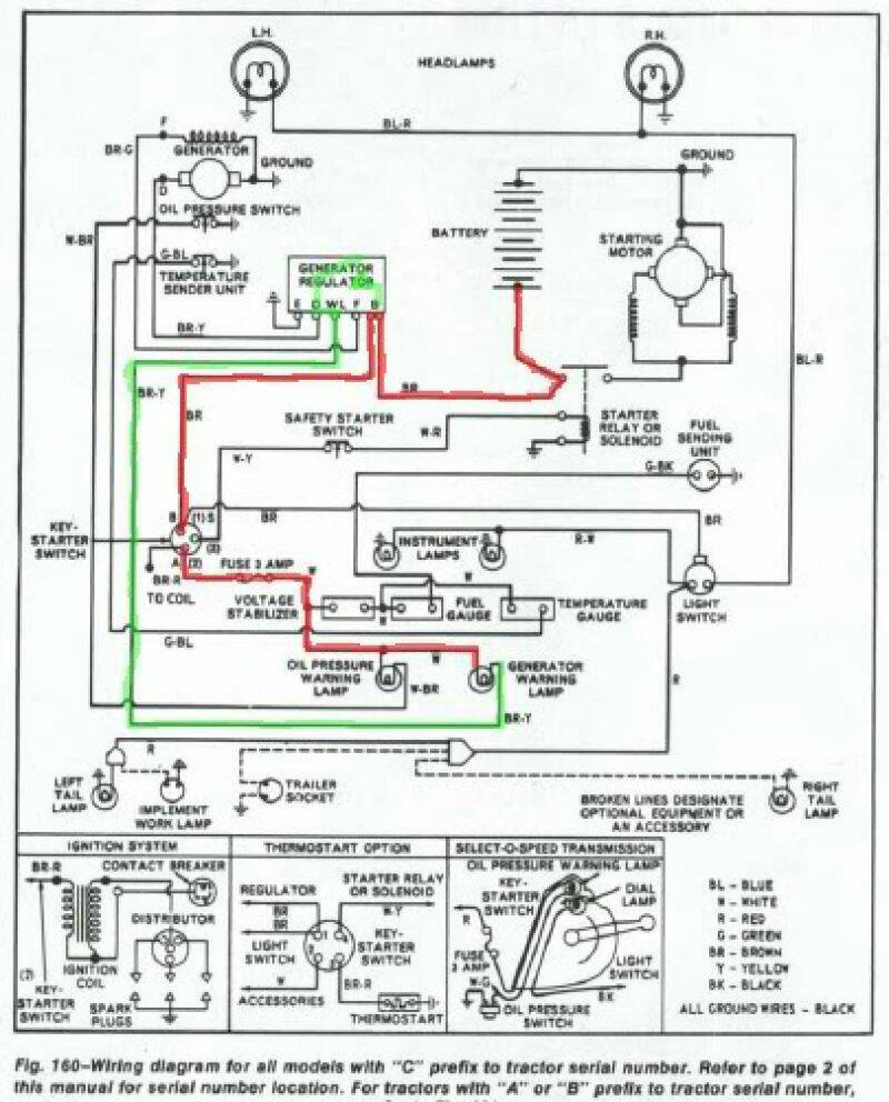

I searched Ford 3600 tractor wiring diagram...then images saw the schematics. I would follow that. I'd have to look at them when I get time...let me know.
If previous owner cut wires, things don't match, it will be difficult but can be done.a24432.jpeg3d4ee1e7a4cd659486bb7c8257463adf.jpeg
