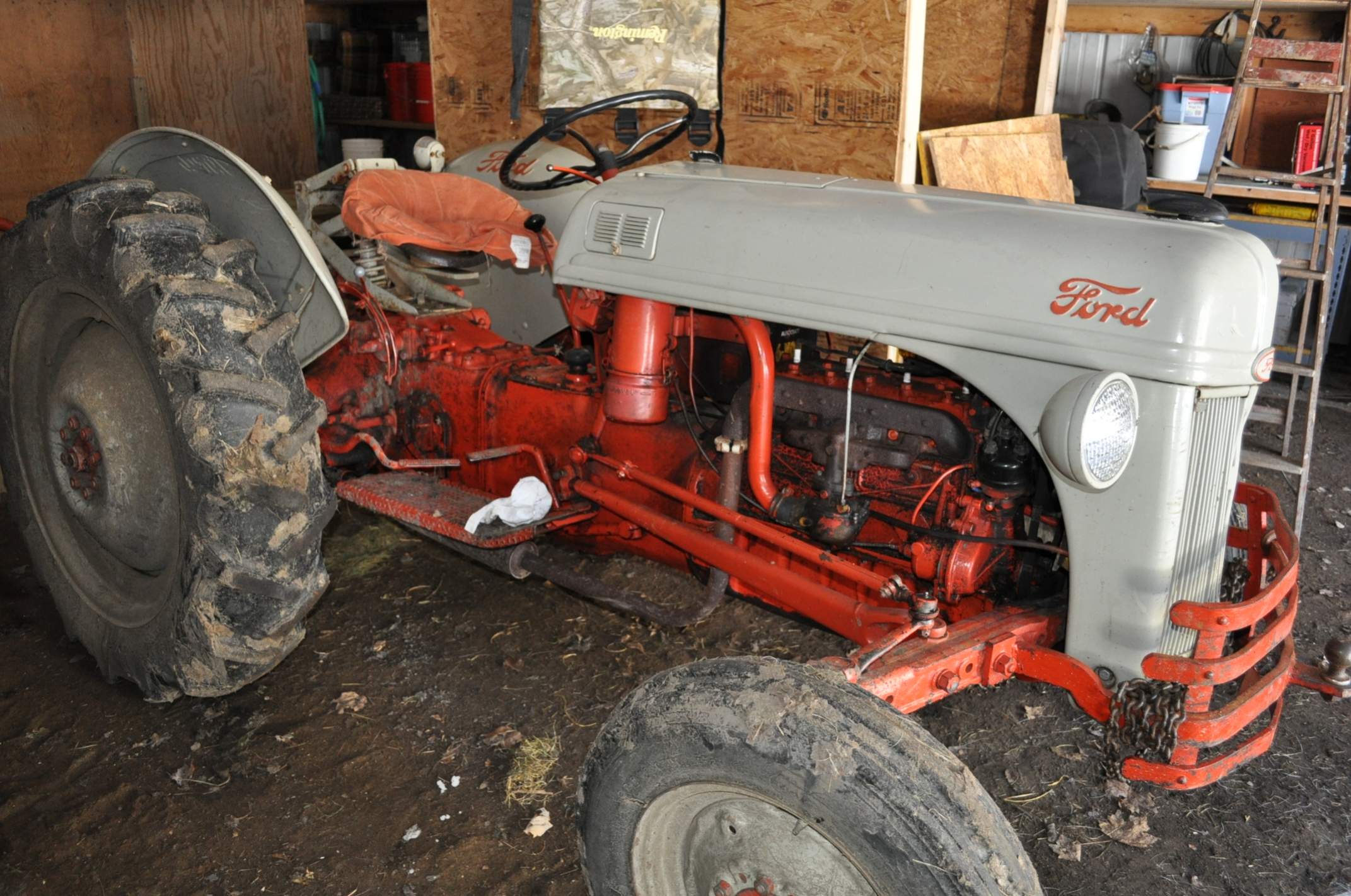

What my father in law has at the cabin is a ford n series tractor with bad brakes. I am trying to figure out what year model it might be to keep an eye out for parts. HP rating too.
1. has 4 speed + R
2. clutch pedal on left side
3. 2 ?brake? pedals on right- 1 might be a pto clutch???
4. front bumper which I haven't seen in any of the pictures thru searching here so far
5. 3 pt control lever on right side next to seat w/stop adjuster
6. AMP guage and another rpm? guage but not one I have seen before
7. head lights and pull switch on left side of steering wheel
8. 3" lever right next to up and down 3pt lever...what it does ????
9. pto engage lever left side under seat.
10. 6 volt electrical system
best I can think of off the top of my head, its 90minute north of me and I won't be able to take pics for 2 weeks. Thanks for any help

There will be the serial number stamped on the engine. It usually says wether it is an 8n, 9n, or2n. Then you can check tractor data for what year it is based off the serial #.
But that really only will tell you what the engine is. Since these tractors are so old and they made so many, an 8n engine doesnt not necessiaraly mean the rest is 8n.
To answer question 8. That little lever is draft control.
And if you can remember what it looks like, as far as your brakes are concerned, look at the wheel hubs. An 8n wheel will have a closer spaced bolt pattern whereas the 2n and 9n had a VERY large diameter bolt pattern on the hubs.
Pics of each, first link is an 8n second one is a pic of a 9n
Maybe others will know be able to tell with the info you gave, but pictures and #'s is the only way to tell for sure.

sounds like an genuine 8N to me.

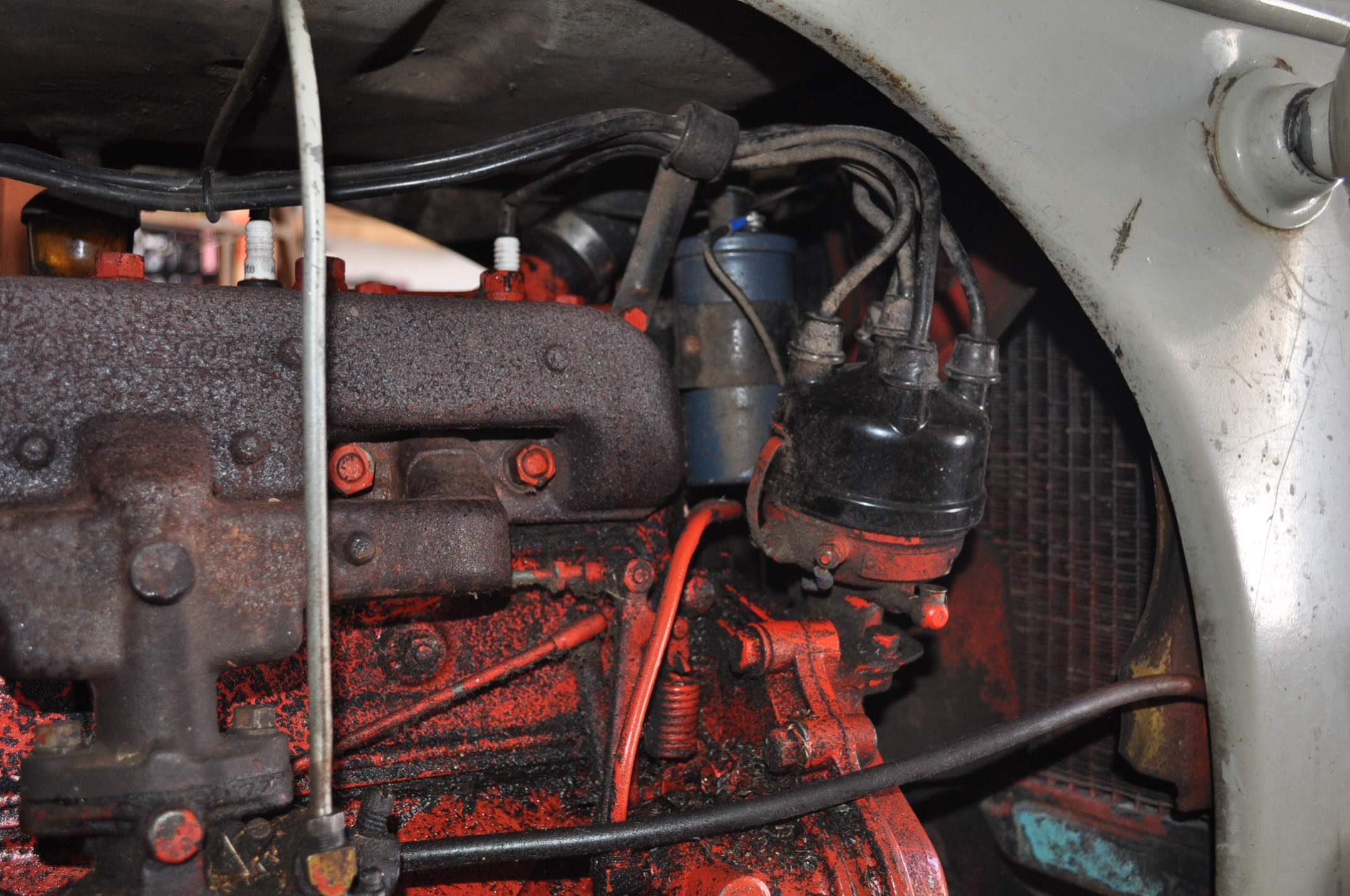

Where's the generator?...also the distributor?. The later 8N's had gen on the left side--same side as the starter. The early 8N's still had the distributor right behind the radiator on the front of the engine, later ones had distrib on the right side of the engine, right behind the governor. Governor also had a shielded cable out the back going to the proofmeter(what you are calling the 'rpm gauge' on the 8N.

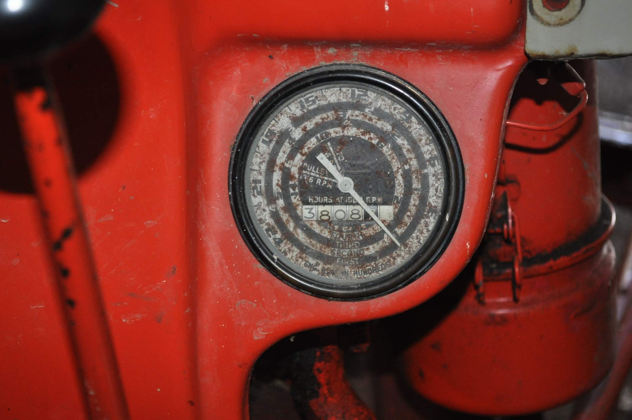

starter & generator is on the drivers side or left side of the tractor. There is a gauge that moves in direct correlation to throttle position. My only guess was rpm or maybe oil pressure but I doubt the oil pressure goes upto 60-80 psi as it does while running it. What is a proof meter ?
/ FORD 2N OR 8N TRACTOR ID??? #6
The rpm gauge or "proofmeter" was only offered on the 1951 and 1952 model 8n's so that is what you got. You would need to check the serial number to find out if it is a 51 or 52 as there were no differences between the two and all parts were shared. I have a 1951 and it is one heck of a tractor, still my favorite of all time. These tractors represent the high-water mark for the once-great Ford tractor company. It was all downhill after that as they lost ground to the competition and eventually were absorbed by some foreign outfit which has saw fit to drop the "Ford" name entirely. Luckily, enough of them n's were produced and are still around such that parts availability will not be an issue in the forseeable future. If you are going to own any Ford, you got the right one. There are some Ford enthusiests who like to extoll the virtues of later models, with "improvements" like live hydraulics and overhead valve engines. While those things might make some jobs easier, they also hurt reliability a bit and will help retire most of them later models long before the last 8n turns its last sod.

the ENGINE BLOCK on the left side, below the HEAD, on a 1x4 flattened boss will have the engines SN weakly hand stamped on it.. all 8n begin with 8n.. all 9n/2n begin with 9n
it's not uncommon to see 8n with 9n sn blocks. or vs a vis.. as the blocks are bolt compatible.
thus you have to look at casting dates to see if parts match.. in the end.. the 4spd trans mean you have an 8n.. a side distribuitor means a later 8n.. and an 8n engine usually, as it is alot of work to build up a side distrib block from a front mount.. just not economical to do so.. etc.

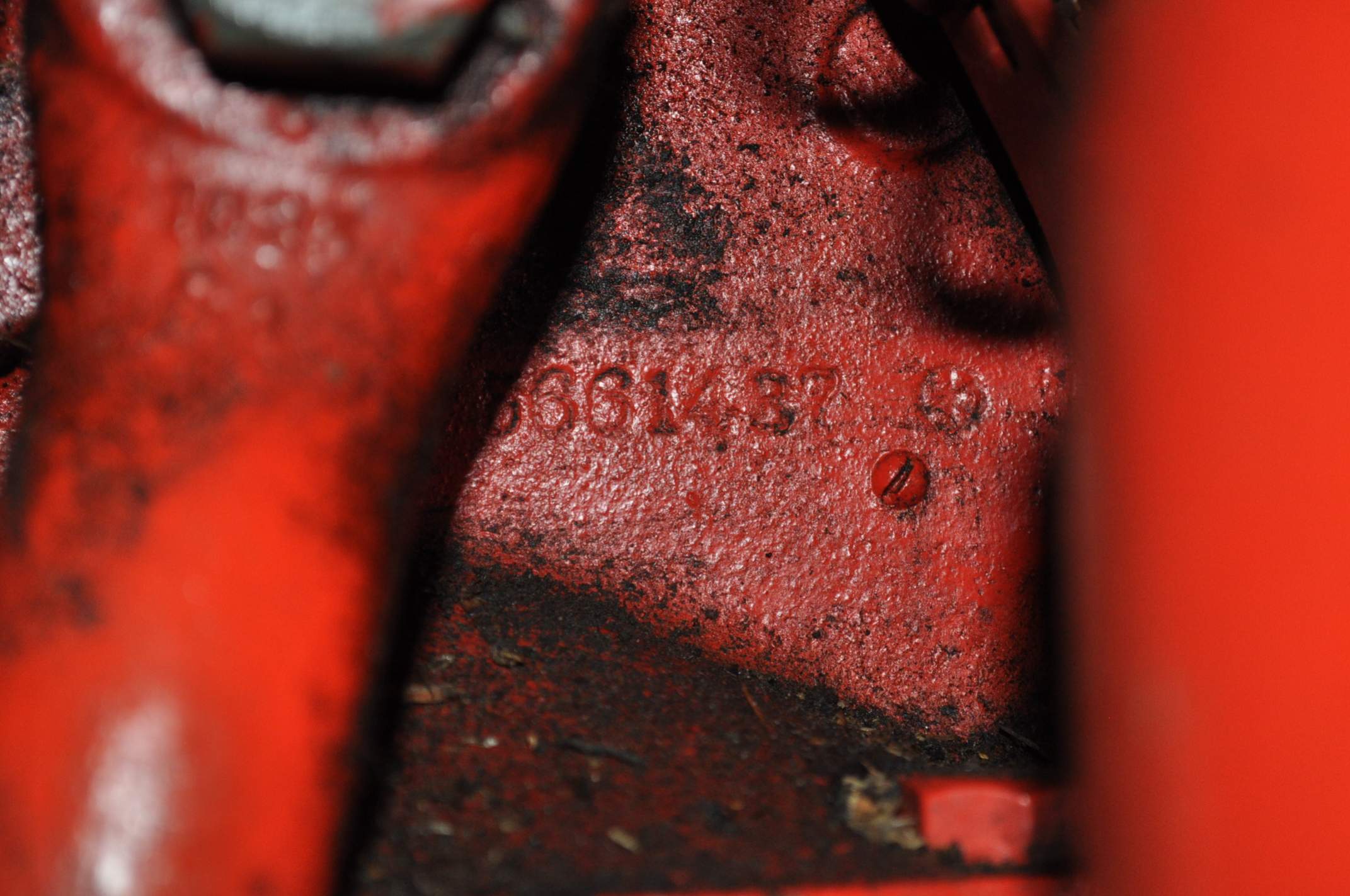

Well I got lucky as I had a job in Marlette to do today, only 25 minutes from the cabin and I had my camera this time. Needed it for the job EST. I found several numbers but I'll start with the engine block
Engine block - <> 8N459016 <> DIAMONDS very unlevel stamping but clear
number behind the oil filter 5661437 with a circle around a star, steering box
tranny behind the muffler under the foot rest 1SK a big dot L8 now it also
could have been ISH dot LB
I also found a 9N543 on a arm from the 3pt under the seat.
then there was another # to the right of the E block # under the battery
it was 18 819 .2 this was a hard one to read and I'm not 100% its correct
then reading verticle it was 8N-C
I will post some pictures soon, Thanks again all, it is a fun experience learning all this. They are way more fun to work on than what I usually do.

moter is an 8n.. lets see a pic of the chassie..

side mount 8n.. no doubt about it.. hubs and brakes and hyds plus other details tell all.
