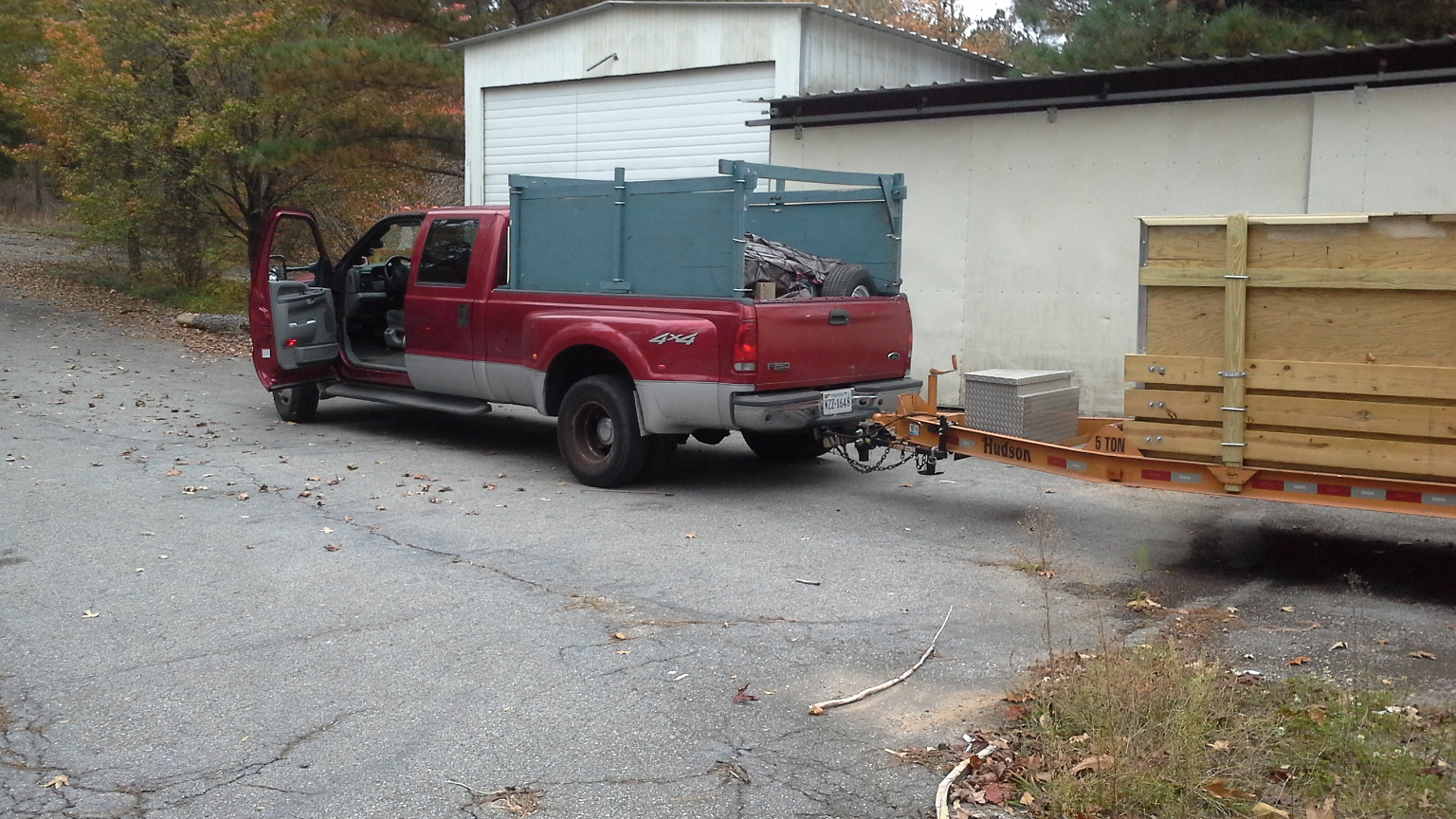

On my trip down to Mississippi from DC yesterday
(hauling my 18' Hudson w/ custom enclosure, obligatory pic)
we stopped at a rest area about halfway. When ready to leave my 2002 F350 7.3 duallie wouldn't start, couldn't even here the starter solenoid engage. Crawled under and rapped the starter with a hammer, she fired up. So for the next 480 miles I didn't turn her off. Parked in my driveway in Mississippi, turned her off, wouldn't restart. Let her set overnight, wouldn't restart. Rapped w/ hammer again, started.
So I figure the starter solenoid is going. Since it's a used truck I'm not sure if it's the original.
