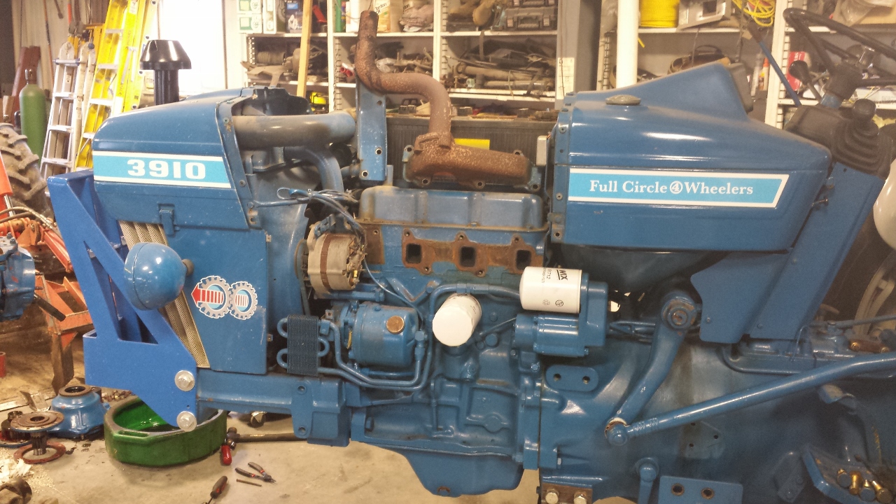

Hopefully UltraDog will chime in soon and clarify this. I can't tell by your pics how your draft control works so can't be sure.
On my 3910 I have two 3pt levers side by side. The outer on controls the 3pt during normal operation. The inner one controls the draft. If the inner lever is lowered all the way, draft is taken out of operation.
Older Ford tractors used one 3pt lever. They had a small steel lever on the side of the rear end housing, kinda under the seat that when up or horizontal put the 3pt into normal operation. When this lever is flipped down or vertical draft is activated. Both controlled by the single lever. If yours is that way, you need the steel lever under the seat up or horizontal. Then the 3pt lever lowered all the way once the Backhoe is installed. Curious how yours is set up??
If you look closely at this pic, you can see my two levers. The outer is in the raised position. The inner is in the lowered position.
   / Ford 2000 How can I tell the model year? #12
Oh, forgot to talk about draft control. Ford uses top link draft control. It senses the pull or load on the top link. If draft is activated and being used to plow for example, it will maintain plow depth by sensing that load. If the plow tries to dig deeper it creates load on the top link and the 3pt will be told to raise slightly. When the plow rises and the top link load decreases the 3pt will be lowered slightly. All with no lever movement on the operators part. When properly setup it works very well.
So in your case, sounds like when digging the hoe puts load on the top link. If the draft control is activated the tractor thinks it needs to raise the 3pt. Can't raise it because of the hoe bracketry. So the hydraulics go into bypass. the pump exceeds it's normal operating pressure trying to overcome this obstacle and blows a seal. Also the hydraulics will get extremely hot during all of this. It would be like hitching the 3pt arms to a load they cannot lift, then raising the 3pt lever and walking away, leaving the tractor straining to lift the load and going into bypass mode. Not good.

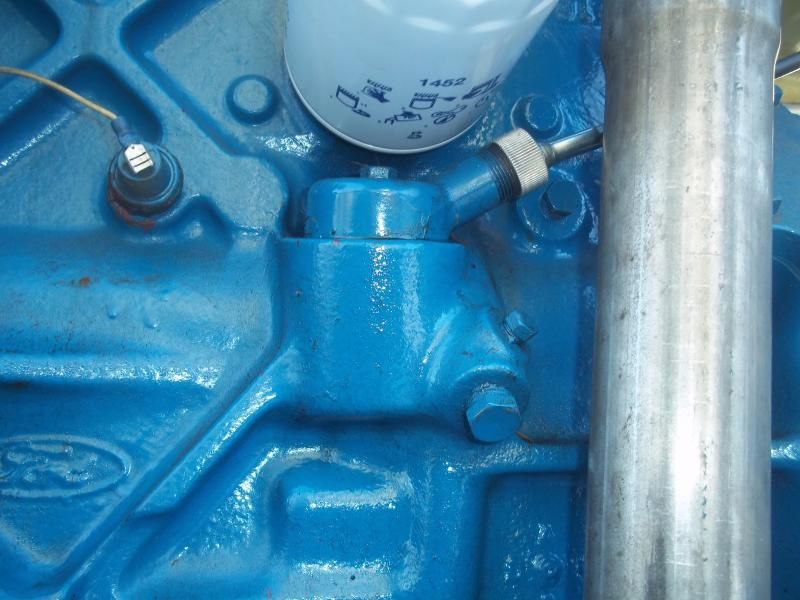

I cleaned off the numbers and took another pic, it look like G5 8
B 047 999 (star symbol)
