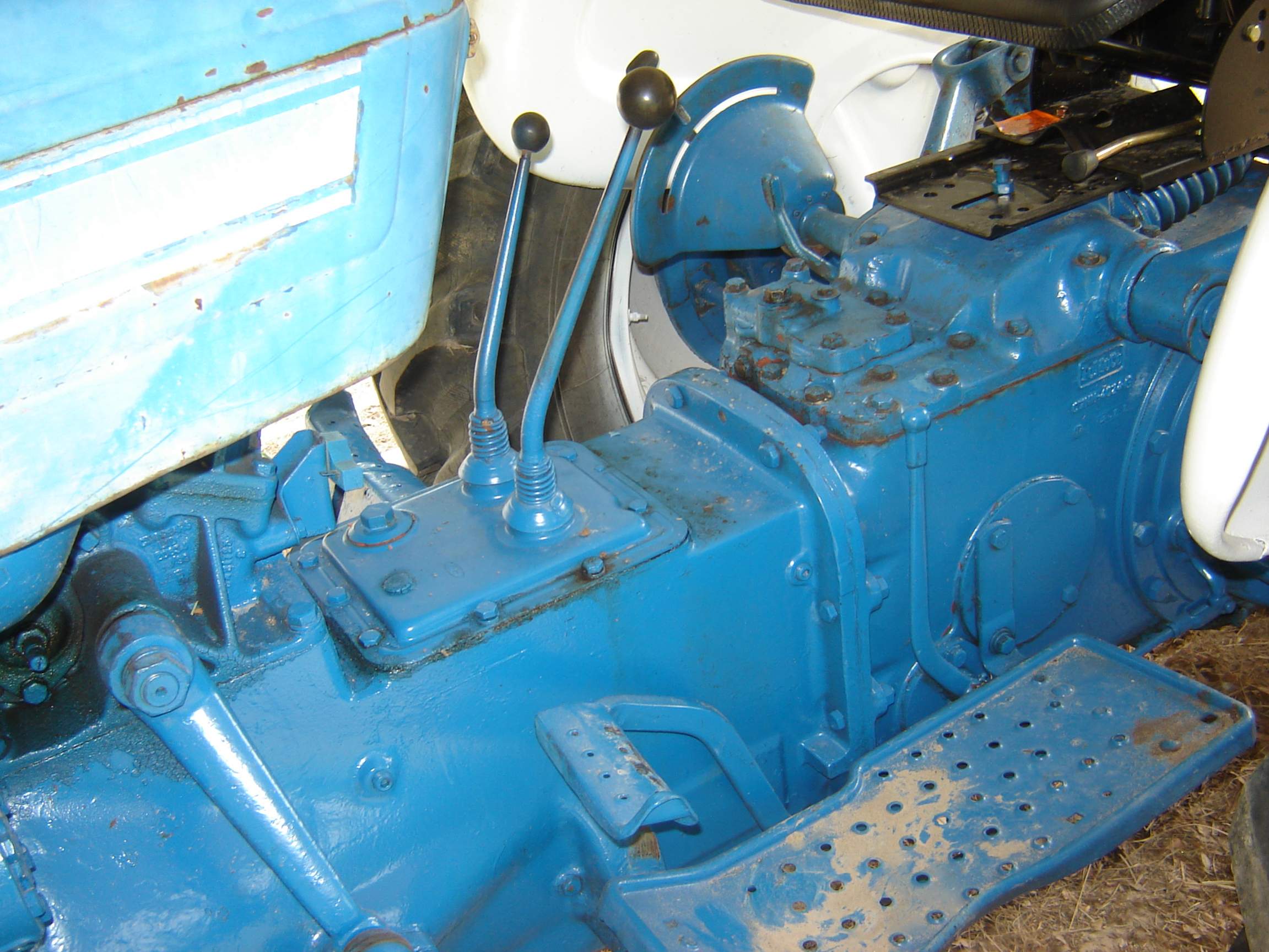

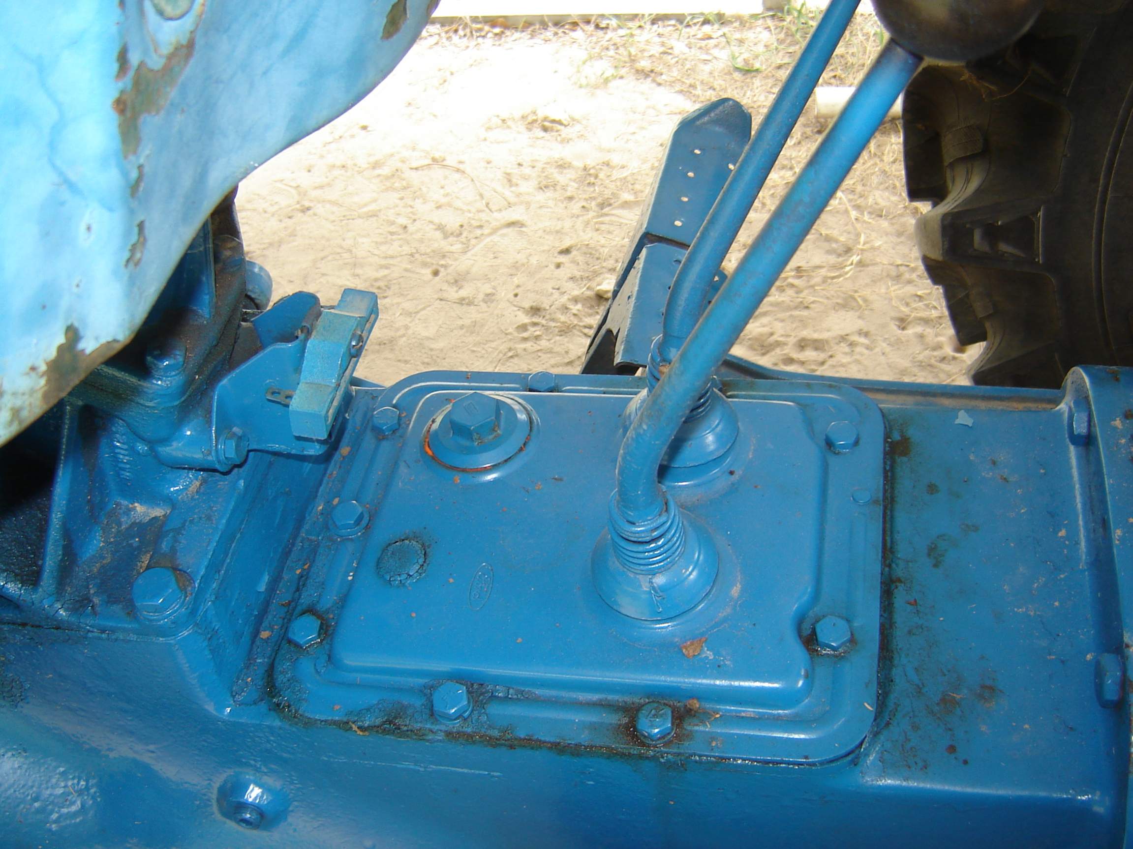

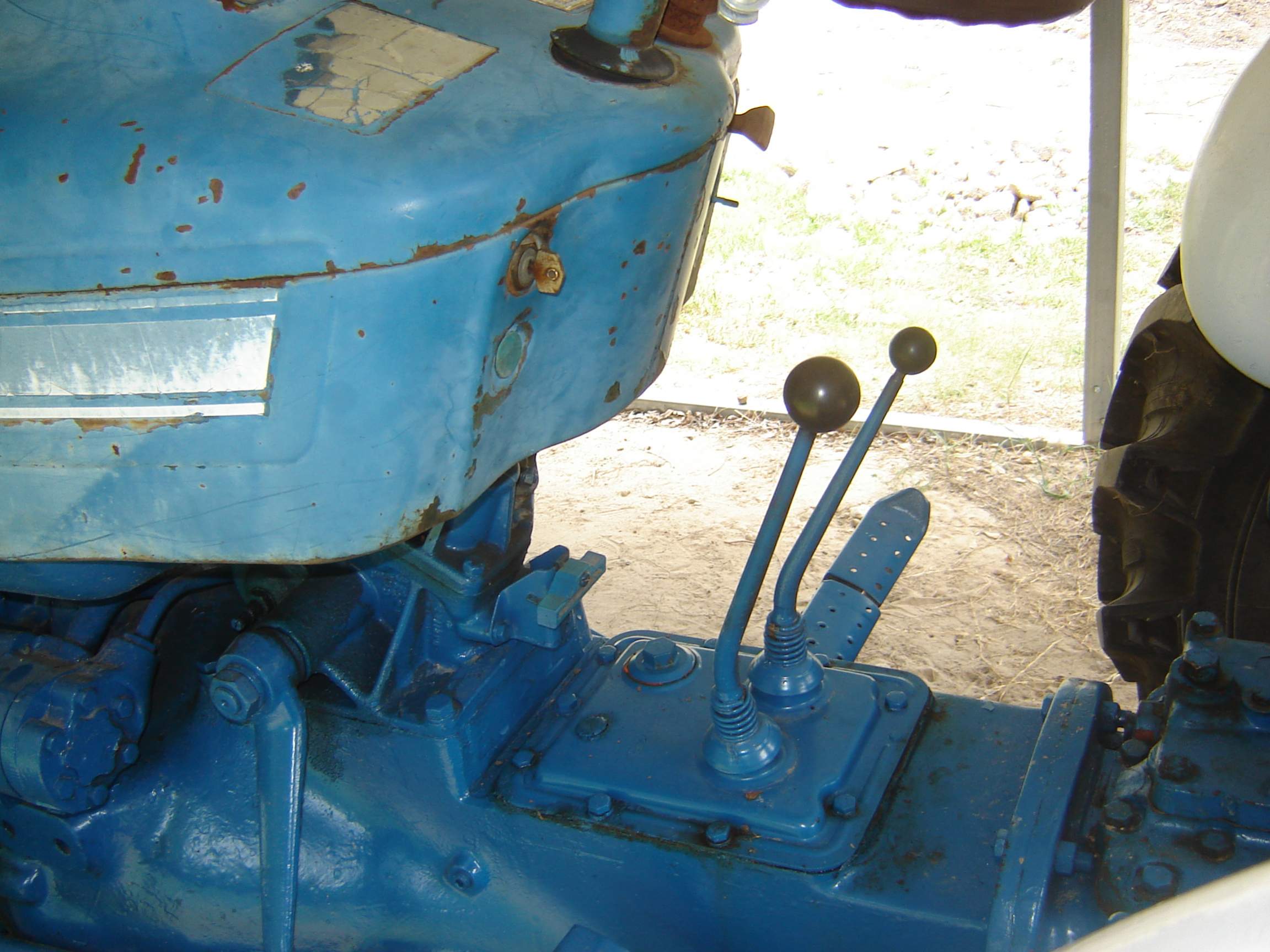

I'm having a problem with the safety switch on my `72 Ford 2000. Yesterday I assumed the switch was stuck because when I finally put the hi/low selector shift in neutral position the tractor cranked up. Today, I found that neutral position is not working either. I had to move the shifter to numerous positions before the starter would finally engage. Is there a way to by pass this safety switch without going into the transmission? It took me about 5 minutes to find a position so the tractor would start. I just want to do away with the safety switch function if I can. Any suggestions?

My tractor doesn't have a sheet metal panel in front of where my left foot sets, nor do I see any wires in that vicinity. Also it doesn't have a cover over part of the transmission and no rubber boot. I'm going to try and upload a couple of pictures of that part of my tractor so maybe you can see what I've got, or maybe you can show me where you're talking about as a location for these things. Thanks for all you attempts to help and maybe together, we'll figure something out.

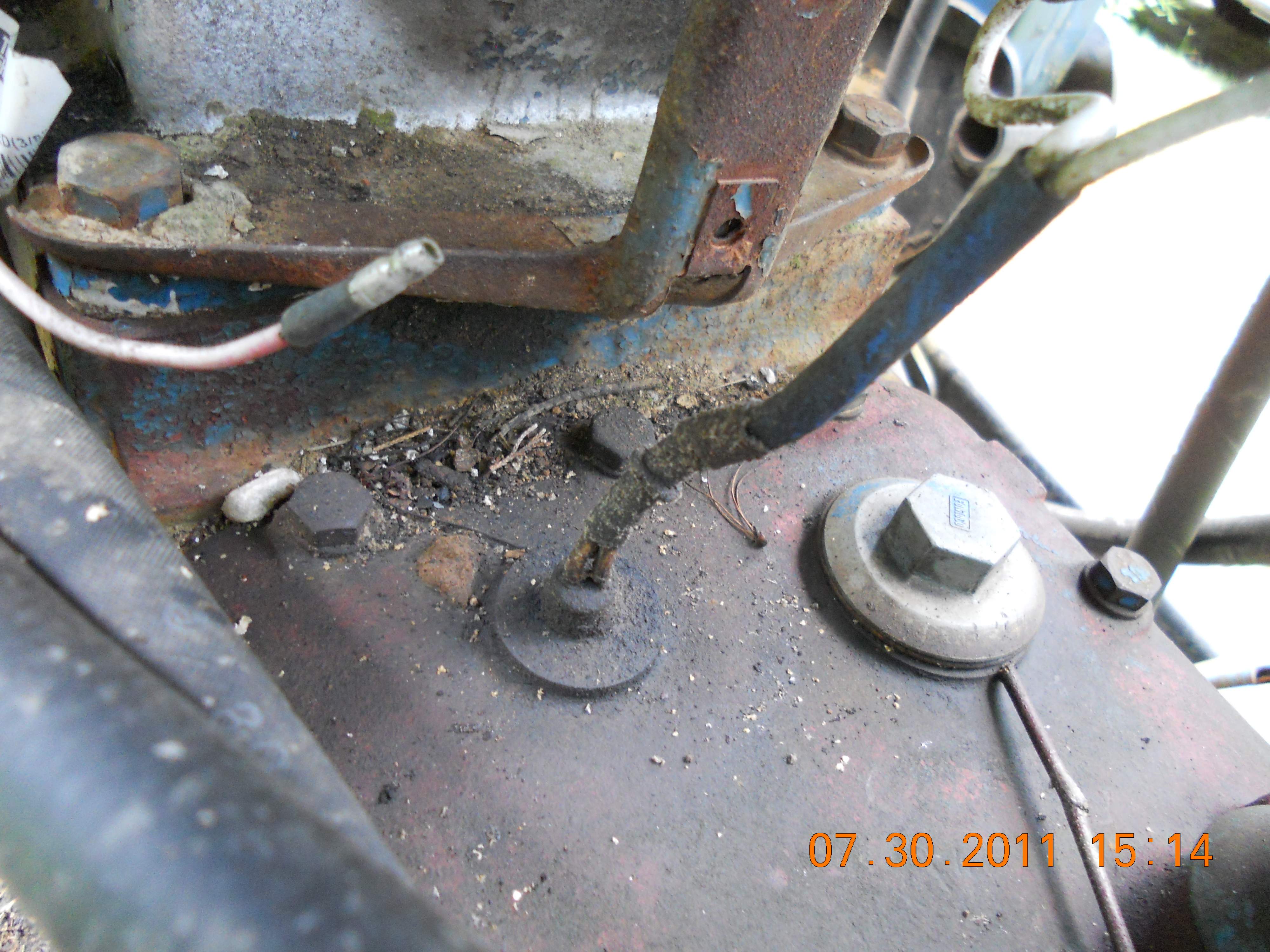

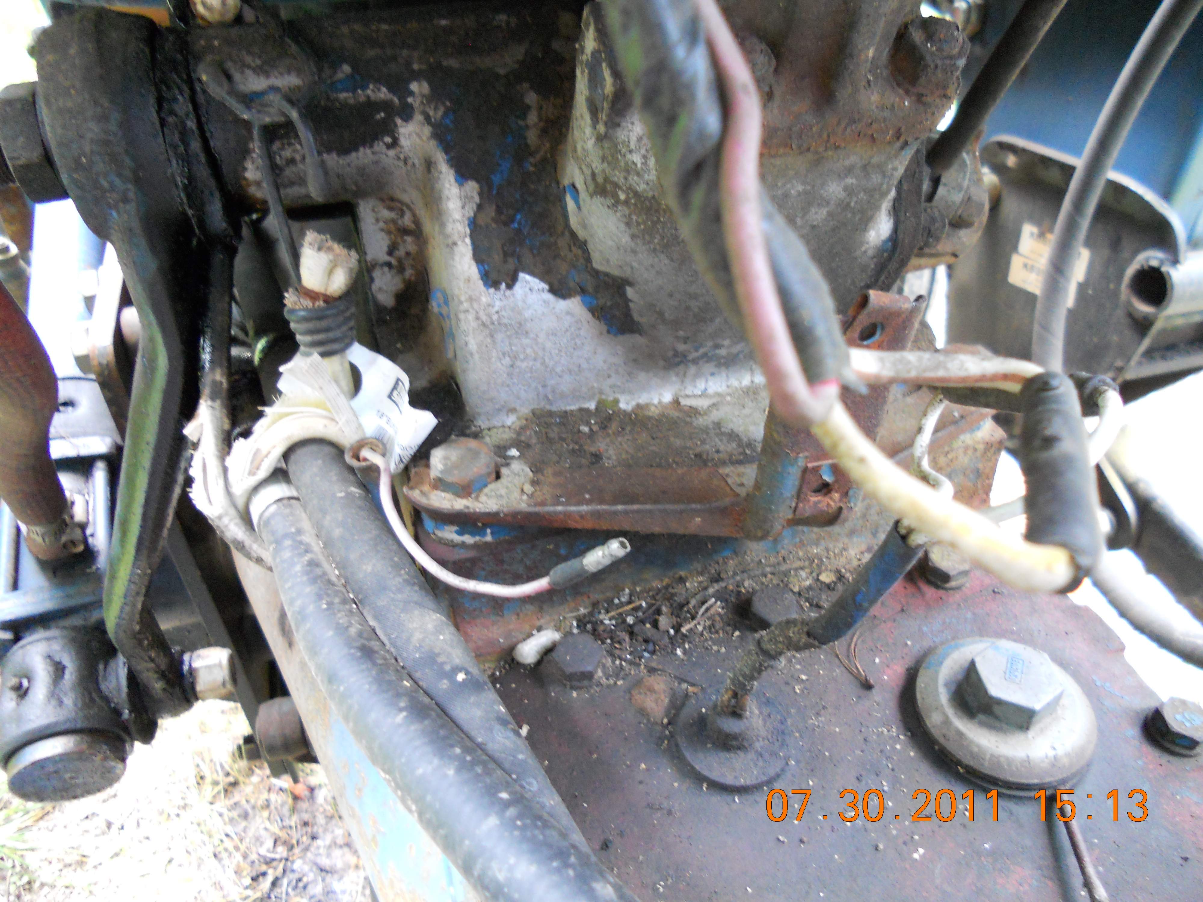

I took a few photos of what mine looks like. I appears that someone placed some sort of plug where your safety switch wires should be exiting the transmission. It's amazing what a little spray paint can hide. :D

Yeah, I see what you're talking about from the pictures you sent. Mine has a rubber plug where apparently the wires once exited the transmission. I looked up under the crowling. There are no extra wires around the key switch but on the other side, there are several. I'll just have to try and pull them all down and see what I can find. If the safety switch has previously been by-passed, then the problem must be the two wires they tied together and not making good contact. What I don't understand is why it will eventually crank when I move the hi/low shifter to a certain spot. I'm still flabber gasted! Thanks to all of you for your time and effort. At least I 've got something solid to look at now whereas I didn't have a clue before. THANKS!
