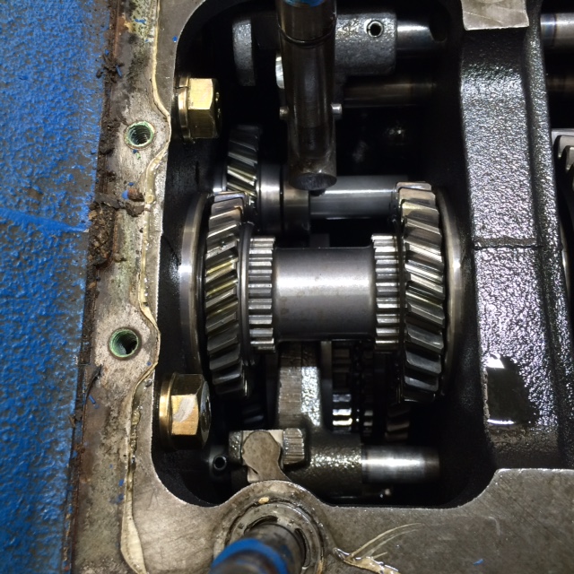

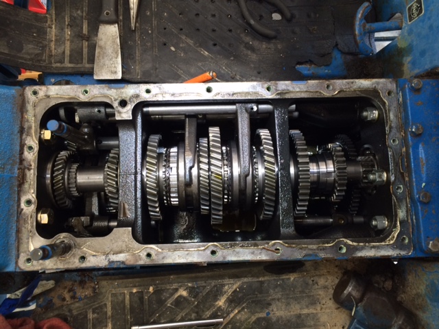

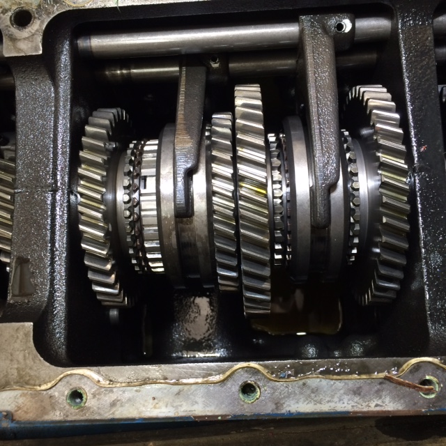

Last weekend I pulled the top cover off the transmission to see if I could see any obvious problems, I did not. Pics below.
What I did find out was that the u-joints on the shift linkages were all but frozen up. I have had them soaking in the parts washer all week. Tonight I will soak them in break-free. Wonder if I had a shifting problem...

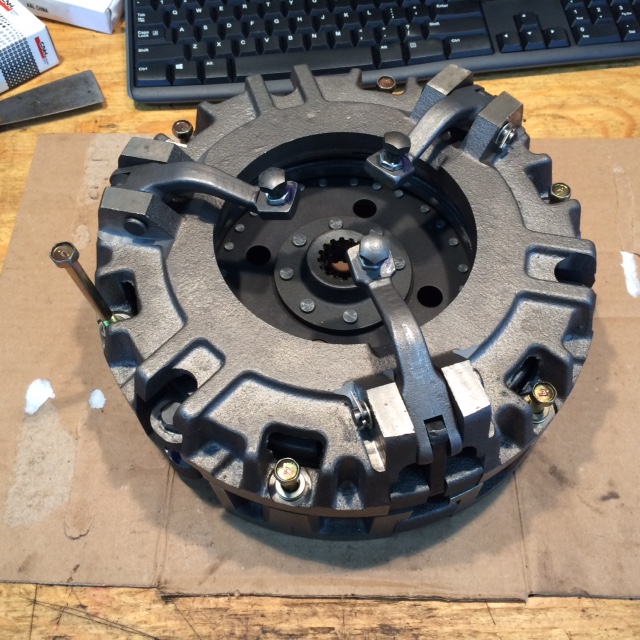

So it was then time to install the clutch and put the tractor back together. Look closely at the clutch photo below - notice the bolt that is sticking up? I would not go thru the hole... nested inside 2 of the 6 mounting holes is a sleeve, looks like it is there to help keep the pieces aligned. The sleeve was stopping the bolt from passing thru - done for the day:(
Called the dealer on Monday who in turn called Hy-Capacity. The pulled one off their shelf and it did the same thing - they took a punch and wacked it thru the hole, it centered / de-burred the hole. Dealer asked me to try the same thing and if that did not work bring it back. I did not have 8mm punch so i used a 5/16 grade 8 bolt. I tapped it back and thru a couple dozen times - i figured (hoped!) the threads would help get rid of any burrs on the sleeve. It worked, the 8mm bolt dropped right thru. I did a test fit (without drive disc) and was able to easily start all 6 bolts - no alignment issues.
