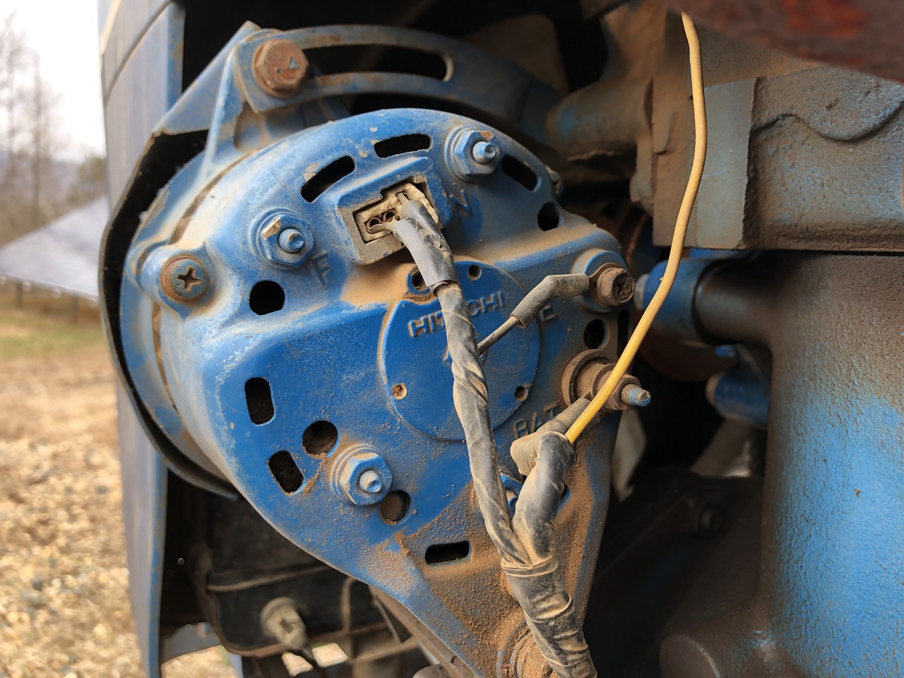

I have a Ford 1700 that stopped charging about a month ago as per the red charging light. Brand new battery that reads 12.5V and doesn't change with the engine running. I take it the wiring is the same on the 1700 vs. the 1910?
I have attached a pic of my alternator, which has 4 wires going to it as follows:
F, N, E and BAT.
Wires are nice and tight, even that broken plug on the F/N connector. Does anyone know the part number for that guy, btw?
Also, the 3 fuses are all good and the connectors there are tight as well.
I'll follow the troubleshooting guide posted on page 1 of this thread. Hopefully that will allow me to get to the bottom of it.
