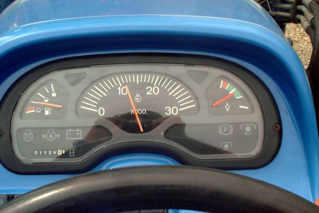

Ron,
My ford 1700 acts exactly the same. Below you'll see the picture of the temp gage when engine is off. As you put the key in preheat or on the needle jumps to zero closing the circuit. As the sending unit temp increases the needle will register higher temp. As you short out the sending unit wire to the ground the needle will go to zero. One additional thing on mine is if after engine is on and I turn the ignition key to 12 o'clock accidentally (Ie off) the needle will jump to max) and that scares the bejesus out of me with engine is running at normal operating temp.
/ Ford 1910,lights,temp gauge. #5
Ron,
AHA! Hot is on the right. Most gages, hot would be on the left. Thanks for showin' me that I was not nearly as smart as I thought I was.:eek::D
Jim,
Don't sell your self short. The difference was merely a matter of convention. You're logic is always dead center.:) and that's what counts.

Bill,
The hot still on the right and cold is on the left of the dial. The only goofy thing was that in normal off position the needle rests on the right side. I found it bassackward when I first saw it convinced that there was something wrong there. Only by testing and after reading the manual I realized by design the needle rests passed hot when off... go figure:rolleyes:

Bill, I really don't know how I got my head so screwed up on this.:rolleyes::eek: As you suggest, temperature gages normally sweep left to right; however, vertical gages normally sweep down to up. My gage on my tractor is a sorta half-vertical to half-horizontal sweep as shown below. I think I had that image burned into my brain and just couldn't get over it. Again, thanks for keepin' me on the "straight and narrow.":)
