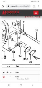

#24. Might be behind the loader mount if you have one. Screenshot_20191016-160718_Chrome.jpeg

I’ll take a look at that,I’m thinking the left hand side possibly. And I do have a loader,but was thinking it would be located on bell housing or similar place.

Thanks for your response Rick.The diagram in the manual shows a small plate but can’t see anything right off��

If your 1720 is the same as my 1920, and I think it is.....
The clutch inspection plate IS behind the Left side loader mount.
You cannot see it until you remove the left side loader mount.
