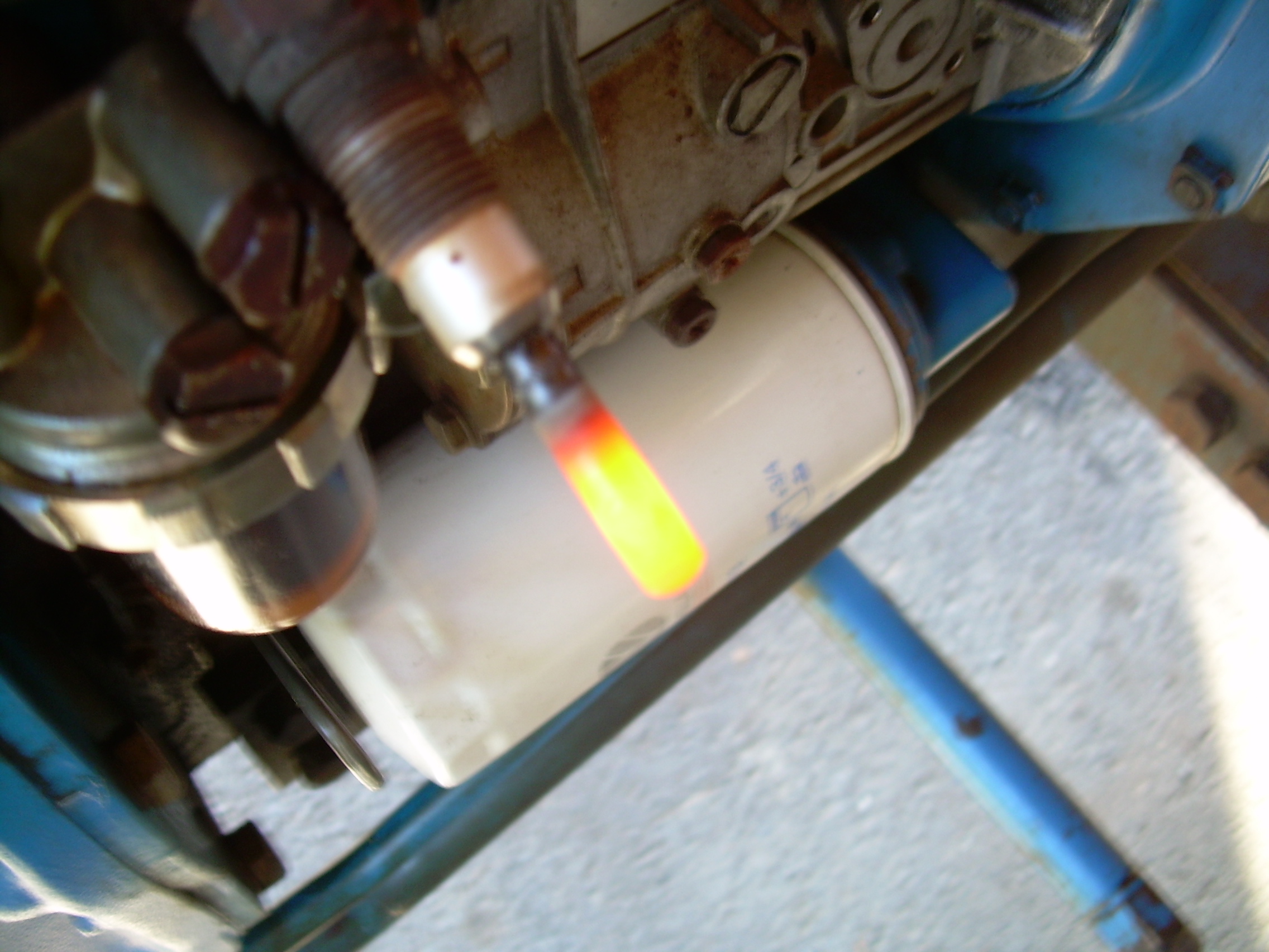

Checked my GP's today and both are good, so I guess my hard starting is due to old age/high hours (2600+) Since I've never seen one I took them right out to test them and man they do get hot, that little coil thing in the dash is very mild compared to the glow plug, I envisioned a little coil similar to the indicator.
