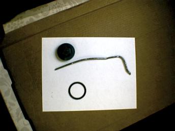

Thanks for the pic on the dipstick. I'll work on fabbing one to replace mine.
I did take off the top and mine was not bent at the bottom. It got chewed up into fine pieces of metal that I carefully cleaned up from the bottom of the pan. I also had to remove and clean the hydraulic filter that was full of metal particles. It was ugly, but seems to have cleaned up nicely.
Now, the bigger issue is finding replacement cylinders for the 30 year old loader.
I'm thinking of taking this back to the hydraulic mechanic to see if he can find good replacements and can fab up the repairs. Not sure if I want to rely on my newbie welding skills on something that takes this kind of abuse.
Thanks again.
Thanks again.
Cool:) You're welcome.
