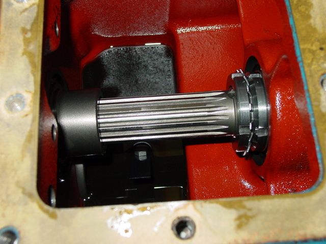

This is the port you can plumb up the return in to the diffy housing.

You are welcome, I have not used it for anything but just verified that the hole opens in to diffy housing. I might use it as a return for a log splitter when I get one.

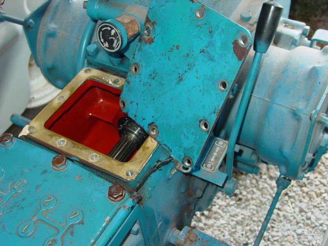

Well, Dang. Have you cleaned up all the dirt and grime well to look under? The only way you can have easy access to reservoir is removing the panel behind the transmission. That is an aluminum plate that can easily be drilled, tapped and some fitting put in with a return hose. I have not seen that but I don't see any reason a guy can't try that.

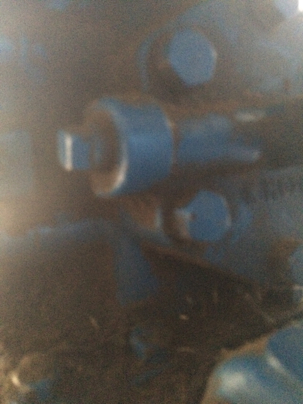

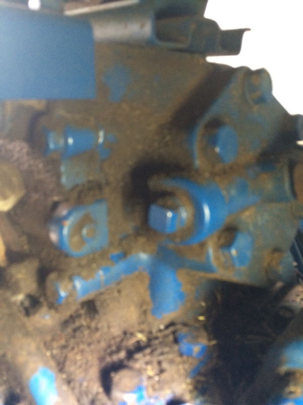

Mine is 4wd so the plate you suggested (rear of shifter) will not work because it has the lever to engage the 4wd
   / Ford 1700 hydraulic question #8
Can you post a picture. If the cover opens up to the oil reservoir then it can provide for a return path to hydraulic oil. some how you need to bring the oil back.
