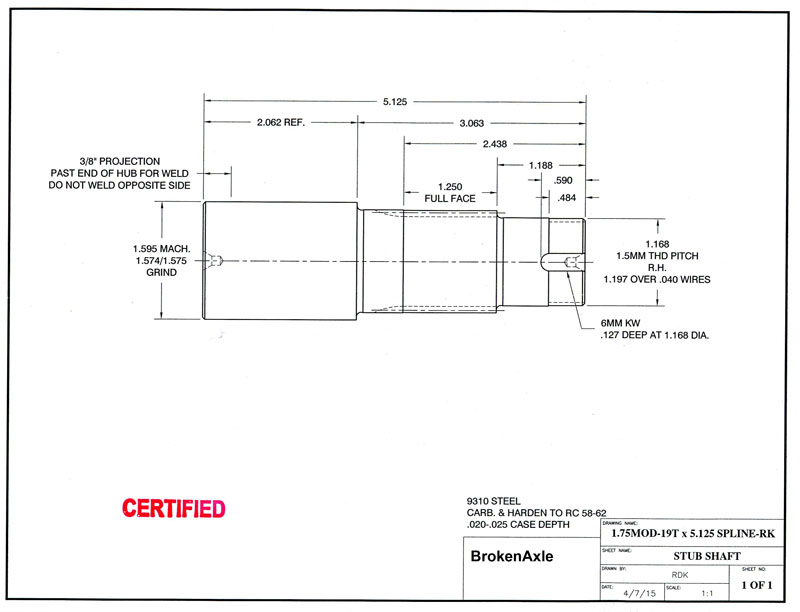

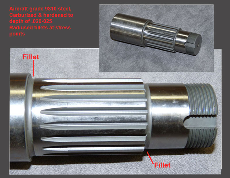

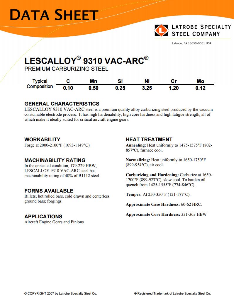

I'm happy to report that the axle replacements are done and ready to ship. They are beautiful! I have already installed one in our tractor and all is well. Here are the details: 9310 alloy steel....aircraft grade, carburized and hardened to RC 58-62 to a depth of .020-.025. This is a vastly superior material to the originals. Radiused fillets have been machined at the stress points where breakage typically occurs, unlike the originals. Your original wheel flange will need to be bored slightly smaller than the axle stub, then heated to for a shrink fit. The new shaft will protrude 3/8 through the flange where it will be welded. Our local machinist charged $100 for this job and I can provide the same. You may want to have this done locally to save time and shipping though. I can provide detailed specs on sizes, etc.
We had to get a small batch of these done in order to get the cost down, so supply is limited to 18. A few are already spoken for, so if you want one or two I suggest you join the queue promptly. Price will be $500 for the axle, $100 for fitting to your flange. Shipping will vary but will be at your cost. I've attached some images.
RandyView attachment 431413View attachment 431414View attachment 431415:)

There seems to be a problem for some of you opening the attachments in my last post. I'll try again. Also I put up a quickie website with more information here: Home
Randy
